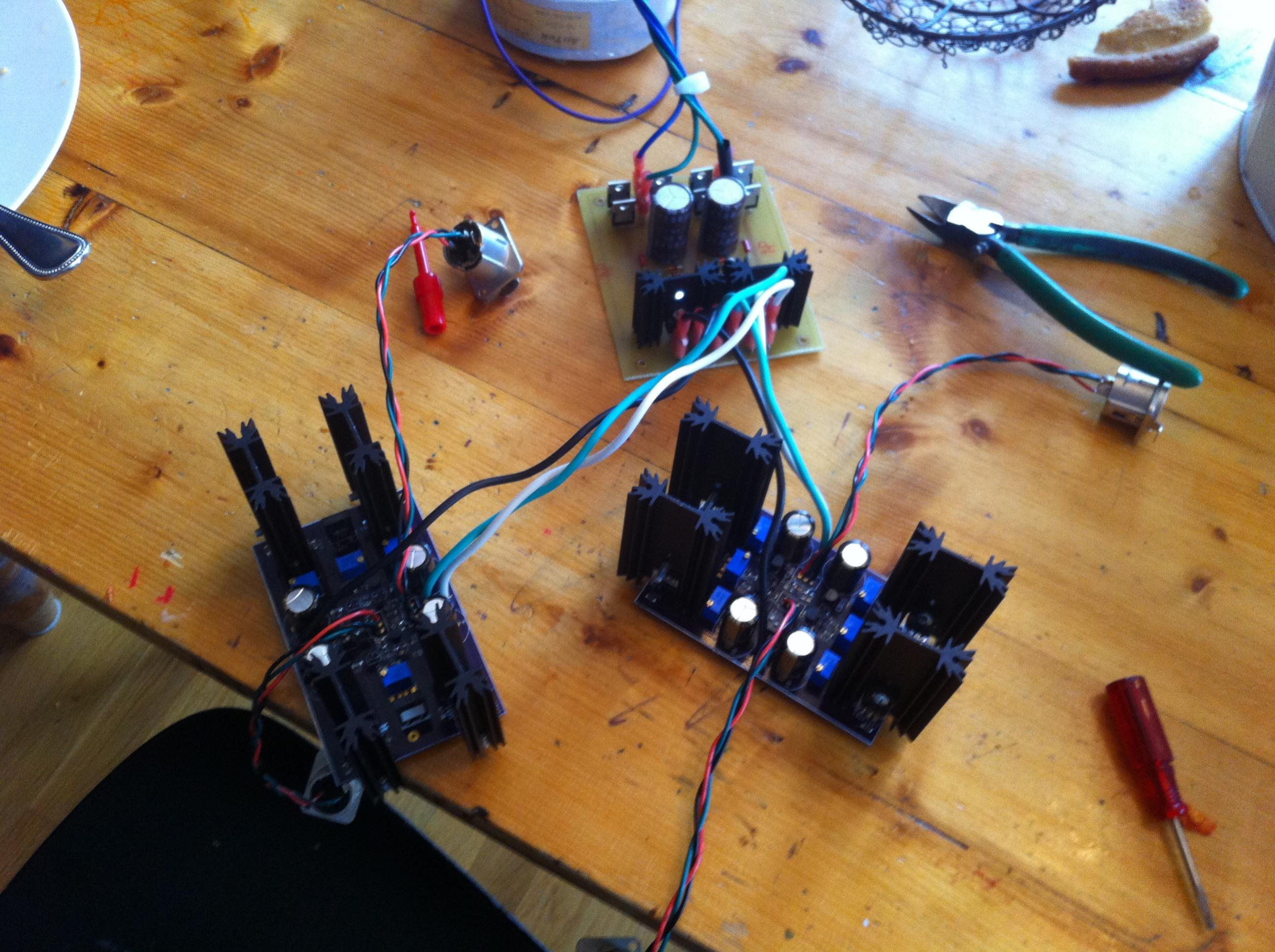

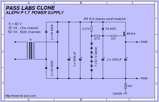

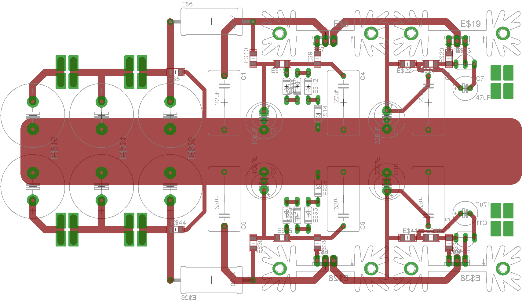

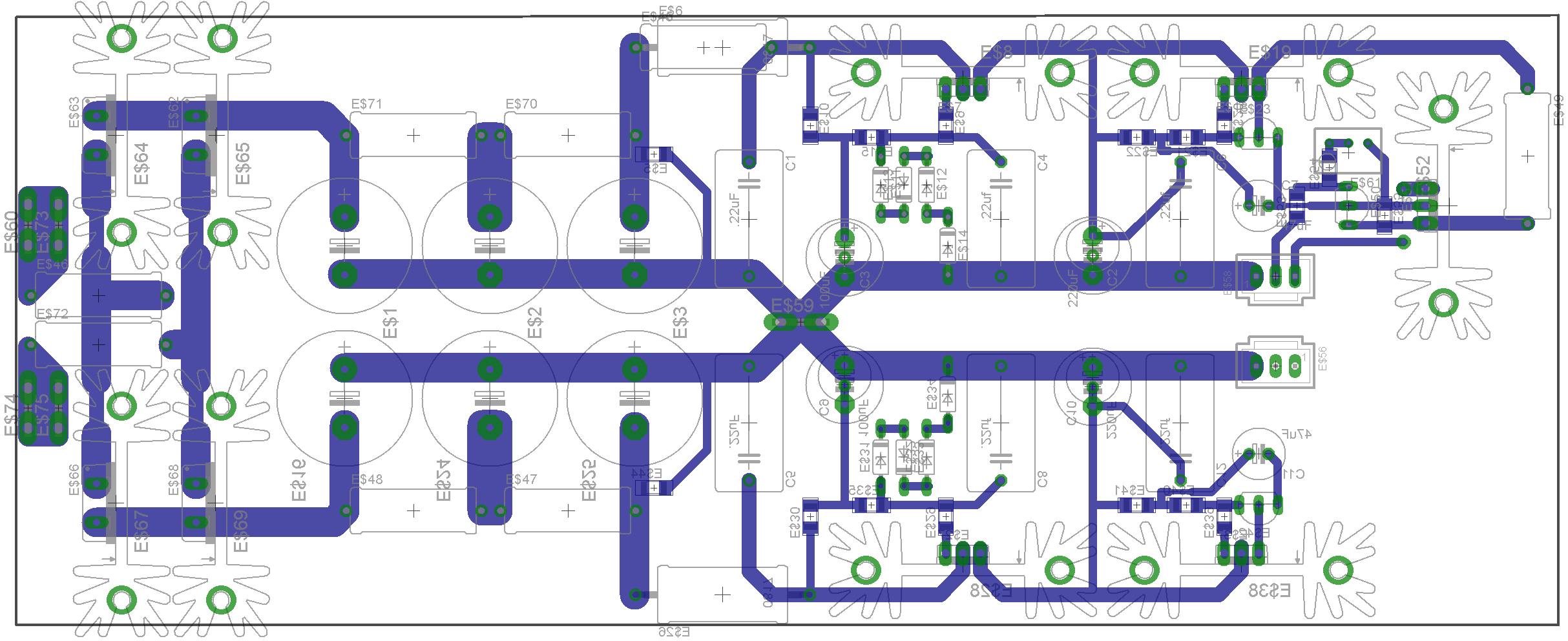

24 sceondaries should yeild 34 rails with this such small current draw. THe diodes are 9.1V and beefy part #4739, 4.7K should yield 7mA, TOshibas are definite waste, but what I had. Pinout is GDS. It should work. Only inner rectdiodes are getting hot. Makes absolutely no sense. IT is PSU from Zen line stage article. BAsic cap mulitplier.
I looked at your circuit, the board layout and the picture, I see no fault either!
I add the picture of the Aleph P circuit and the picture of my favorite PSU for universal purpose in pre amps....
mind in the negative branch of the 7915 the last cap is with wrong polarity, + should go down, not up!
