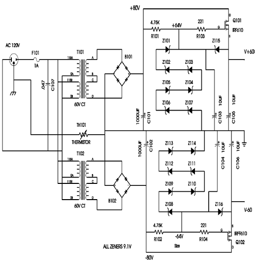

First step is your circuit. Second is slightly altered version. Third centers around output bias and losing any in line caps. Fourth is funny bias on output. May not get eny of it to work

first - Toshibas as multipliers ( more followers , to me ) is waste

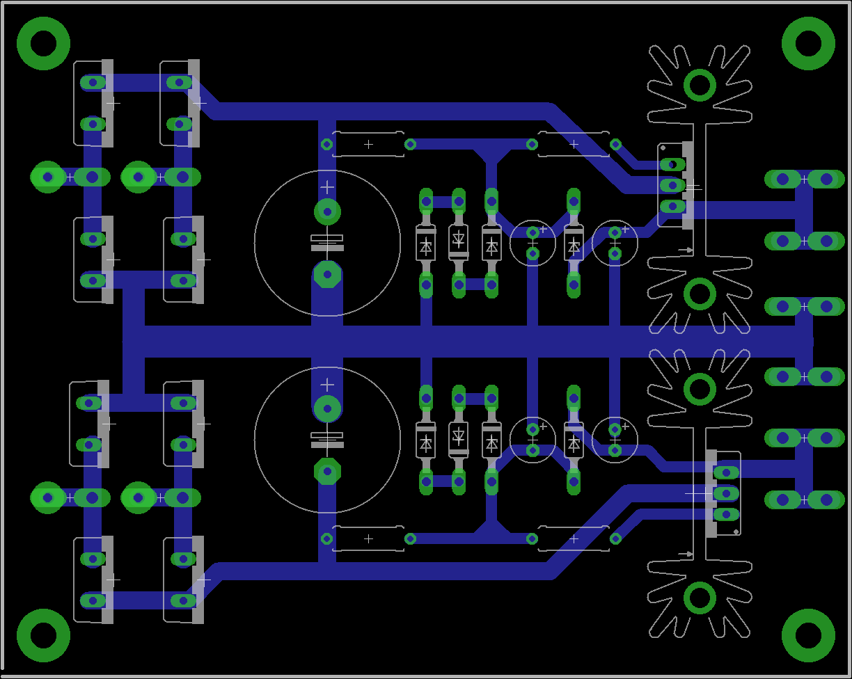

second 0 you jnow that I have fobia of looking at pcbs and tracing them , but I can't see anything wrong
you didn't misplaced mosfet's place ?
N on positive , P on negative ?
what's programmed current through Zdiodes ?
say that 5mA is more than enough

As drawn in AX info on Eric's wonderfully done site, will these not be in parallel to current funny feedback.

24 sceondaries should yeild 34 rails with this such small current draw. THe diodes are 9.1V and beefy part #4739, 4.7K should yield 7mA, TOshibas are definite waste, but what I had. Pinout is GDS. It should work. Only inner rectdiodes are getting hot. Makes absolutely no sense. IT is PSU from Zen line stage article. BAsic cap mulitplier.

In aboce setup of PSU, I do not have ground tied to earth, but that shouldnt matter, correct/
ditch zenners , up cap value and you have cap multiplier
with zenners , that's nothing else than series reg , sometimes called zenner follower or something like that
earth -gnd - doesn't matter for circuit function
(pretty lousy gnd layout on that pcb
