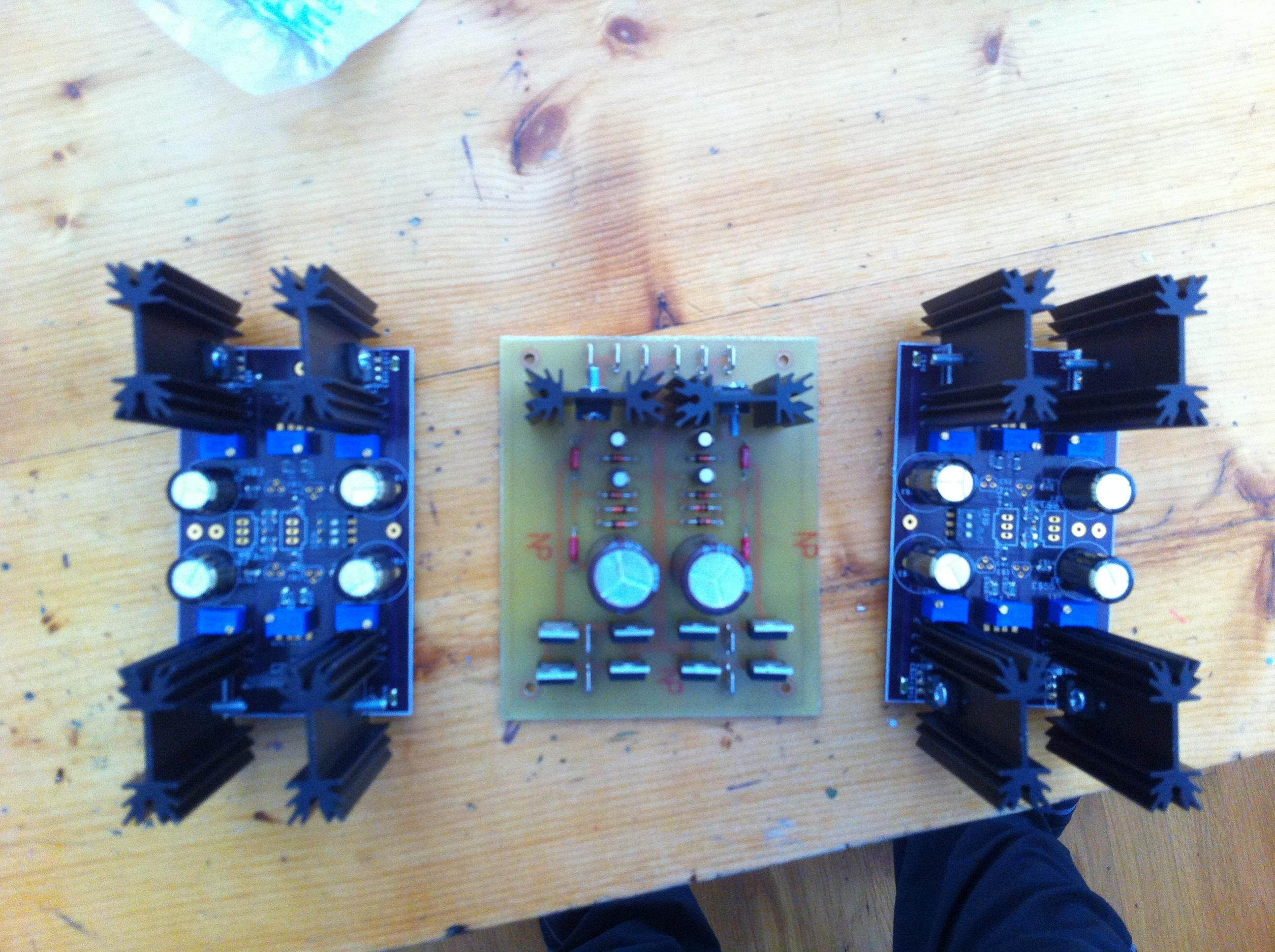

oh, are these the same burning amp 3 boards sold here on diyaudio.com?
Although buzz's boards are a bit different, they are basically the BA-3 front-end (or 'Driver' board) from the store.
Bias is now on the output boards - so you choose either single-ended or complimentary output. Add the FE to that and you have an amp.
You can get it from the DIYaudio store.
Or, you could use a BA-3 (or the other BA front end), or Pumpkin preamp, or Impasse Preamp to drive the BA-output stage directly.

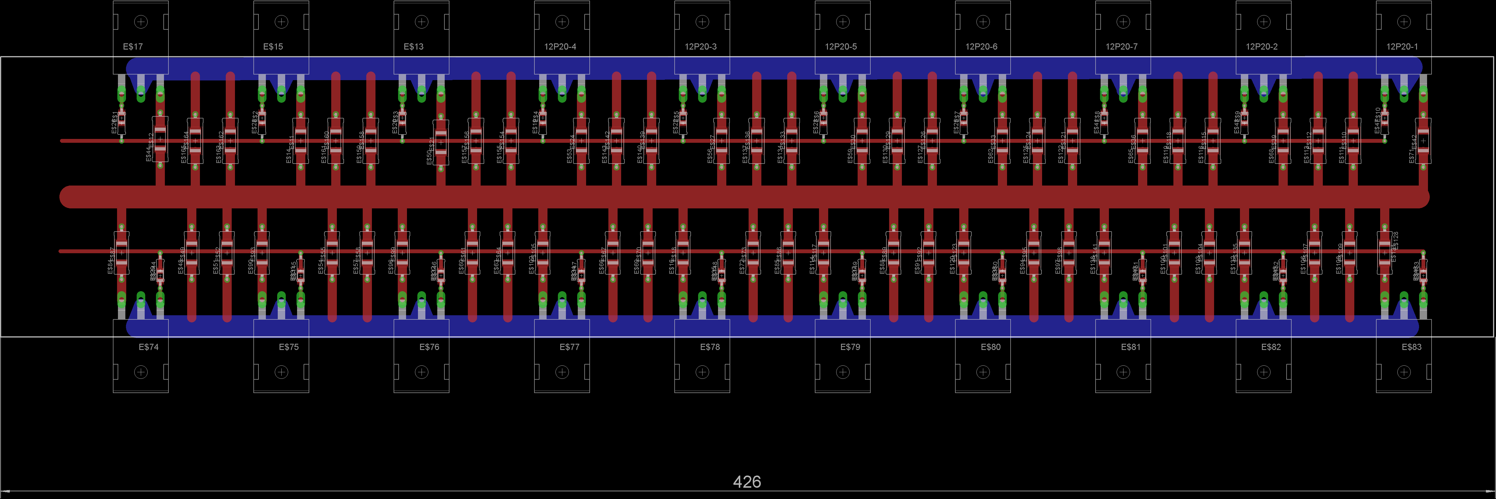

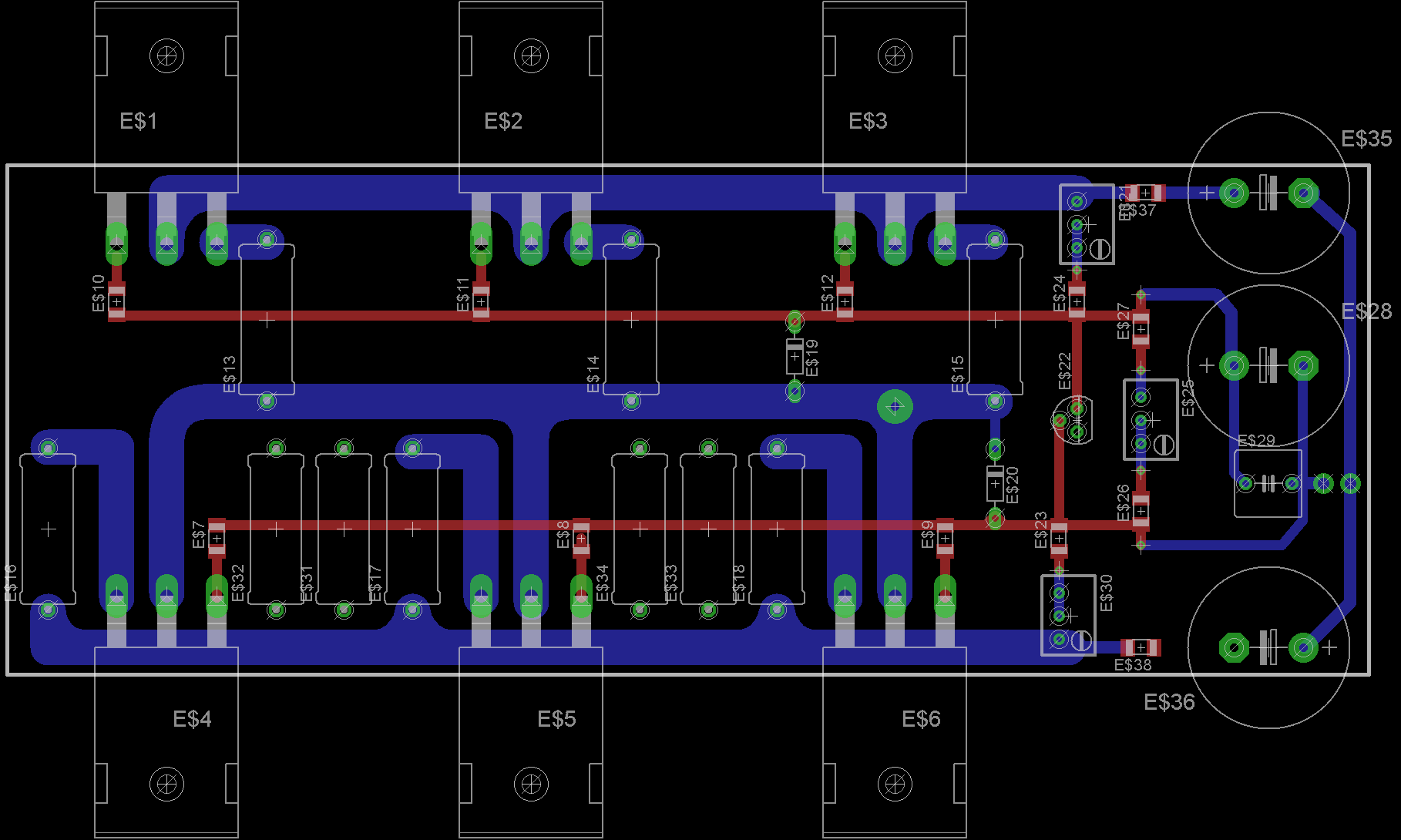

All this talk about BA-amps makes me want to build a 6-pair/channel complementary amp...
(goes and looks at BA- page...)
Yep, you are right, the bias section is a separate PCB that is packaged with the output boards. (It didn't used to be that way, the first BA had the bias on the Front-End (gain) stage.
For current capacity, I assume. You know I probably want use that many. Will probably split in half and this will be one whole channel.
you assume well
good plan , regarding splitting them
however - you don't need SE resistors going from both rails to output
Didnt feel like correcting it after exporting it.

Nope. Level shifters like in normal BA3b. They are necessity, I believe, as the FE is heavily degenerated. Lower degeneration, add a cascode device, and you are probably ok. This v1 in a series of variations. Youll notice the cap is gone. I was going to use single supply, but since I cannot finish today, I will do a second. Go ahead and setup for dual mono final setup. CM and FC output are future revisions.
Nope. Level shifters like in normal BA3b. .... Youll notice the cap is gone.
so your onboard lytics are supply caps 😕
