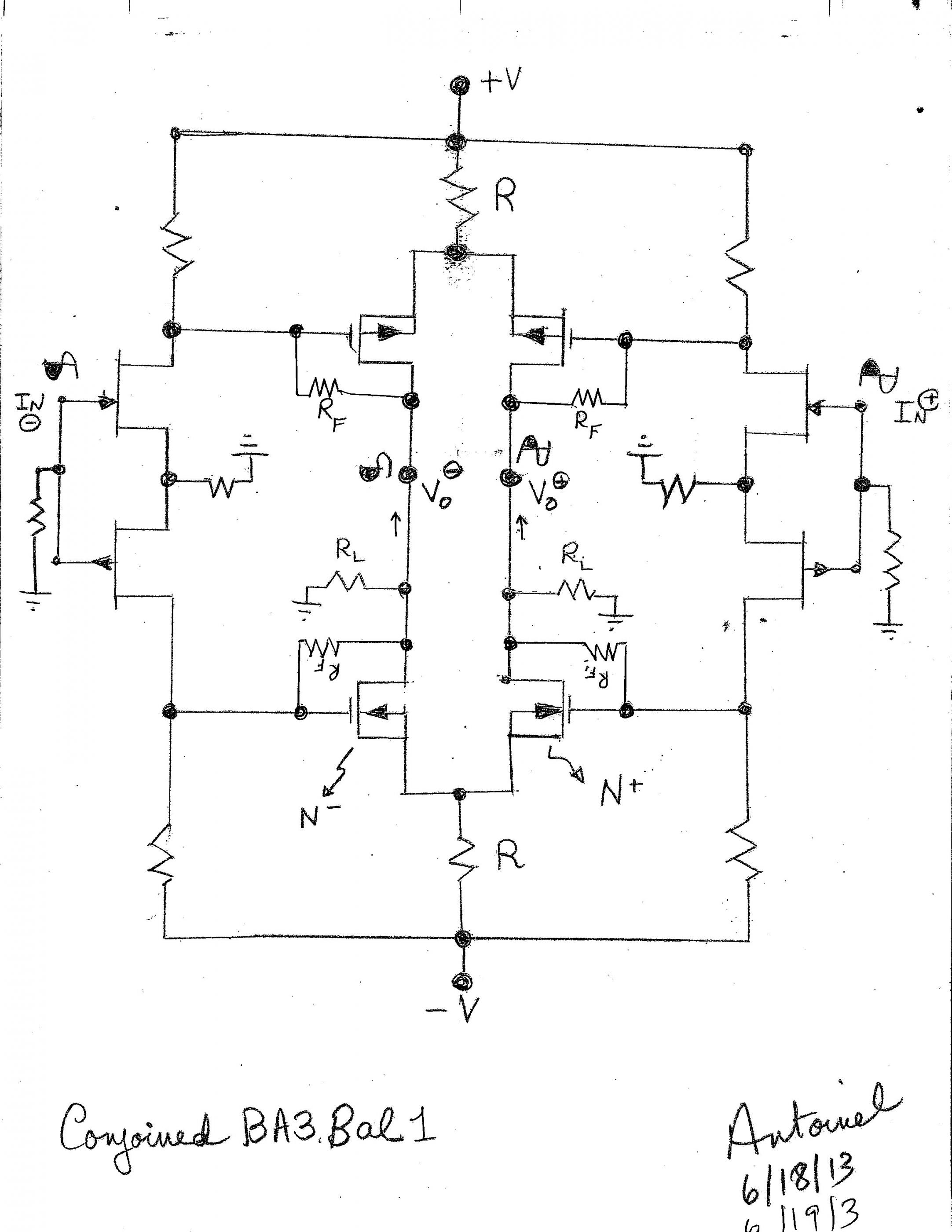

- The output stage shows 2 conjoined complementary symmetry diy or clone SOX [R].
- I added a feeback resistor Rf from the gate to the drain of each output MOSFET like in ZV6.
- If I am theoretically on track, then the harmonic distortion at the outputs [arrows] point in the same direction. This means their amplitudes are equal and their phases are aligned in the same direction.
- The preamp output signals will go through a balanced power amp. The arrows [from preamp] will still be aligned as shown for cancellation across the loudspeaker.
One disadvantage that I see is that the input pair is not included in the error current loop, so you do not get any corrective help with them. Do you agree?
I agree.One disadvantage that I see is that the input pair is not included in the error current loop, so you do not get any corrective help with them. Do you agree?

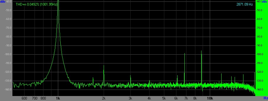

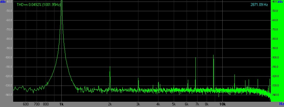

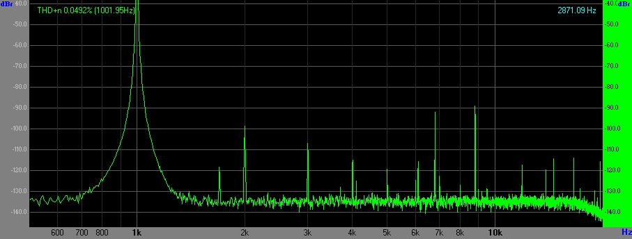

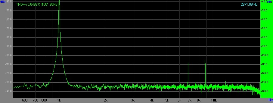

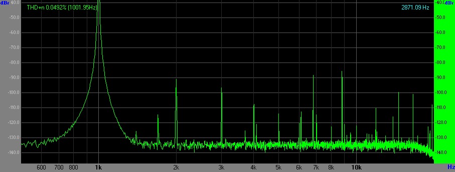

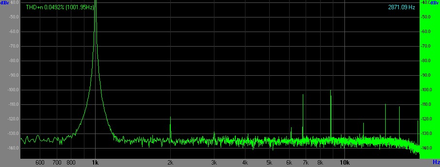

1- Soundcard 1V Loopback
2- Soundcard 1V - Amp 3.2V output
3- Soundcard 2V Loopback
4- Soundcard 2V - Amp 6.47V output
5- Soundcard 3V Loopback
6- Soundcard 3V - Amp 9.83V output
Higher harmonics are present in test setup, so it is hard to know what it amp and what is setup. If not for them, it looks good to me.
