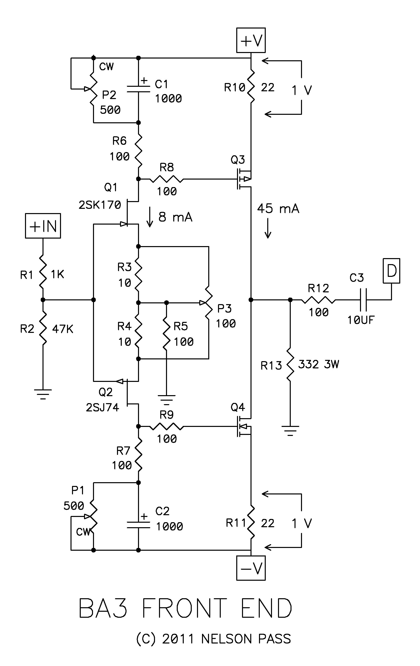

Change R13 to 200ohm or perhaps even 150ohm.
Gain is R13/R10
Therefore stock is 332/22 = 15
A gain of ~10 would be R13=200ohm (200/22=9)
And reducing R13 to 150ohm would give a gain of ~7 (150/22=6.8)

I don't think a gain factor of 15 is too much...
I am running a 2mv phono cartridge into a 36db phono stage w/a jfet BOZ as a preamp now. I wish I had more gain, actually. I've never pushed the amp into clipping and I have had the dial 3/4 of the way up or more. Typically it's 1/2 to 3/4 up. I don't listen real loud.

P3 resolves this in the context of the amp as a whole. For instance, you could use P3 to minimize distortion in just FE or you could do the same with it hooked up to your amp of choice. just depends where in the chain you are testing.
So what to do with P3 if you don't have a distortion analyzer?
I just measured between the second leg of the pot and r4, put the pots about half way and made sure the channels were even. My Jfets are matched, Mosfets not matched. Got a better idea?
Also, I measured between middle leg of P1/P2 and the negative pcb hole of the electrolytic caps to insure the pots are zeroed (the caps aren't in yet) for startup. This correct?
Also (this might be a stupid question), I still need R2, the 47K input to ground resistor if I am going to put a volume pot in front of the board and use it as a preamp, right?
Regarding gain, yes...30 is a lot. I will try it stock and maybe go down if I feel like it's clipping early.

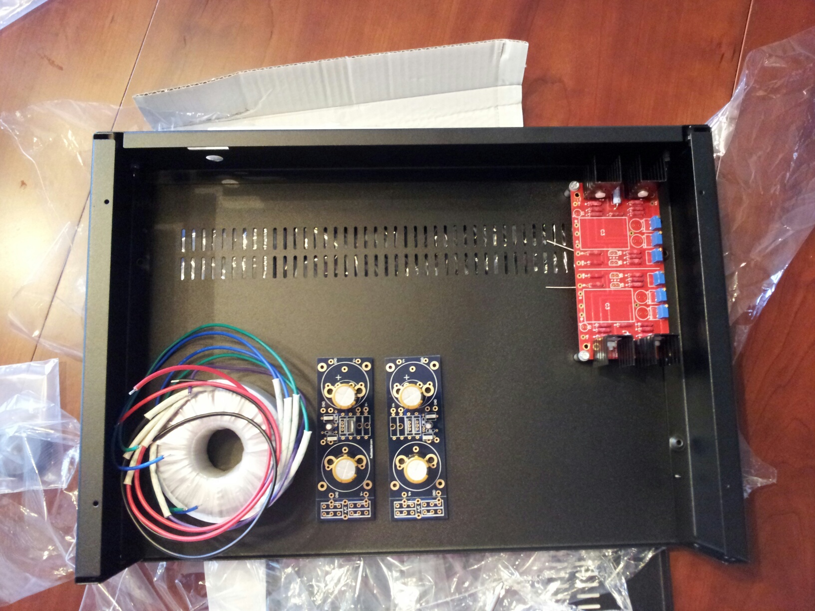

Got the chassis yesterday. I am starting to sort out placement. I need to order some volume/source extension shafts. I have a 25K ladder pot and a rotary switch I will use for source selection. No caps in the BA-3 yet, they currently reside in a jfet boz.
I will hopefully start drilling today. Still looking for a nice power switch for the front. Latching, pushbotton would be nice. Any recommendations?
If I can't find that I may use this rotary switch (see attached).
Also, should I be using an emi filter/iec inlet with EMI filter on this thing?

If you have a nice knob that will match the rest, use the rotary.
