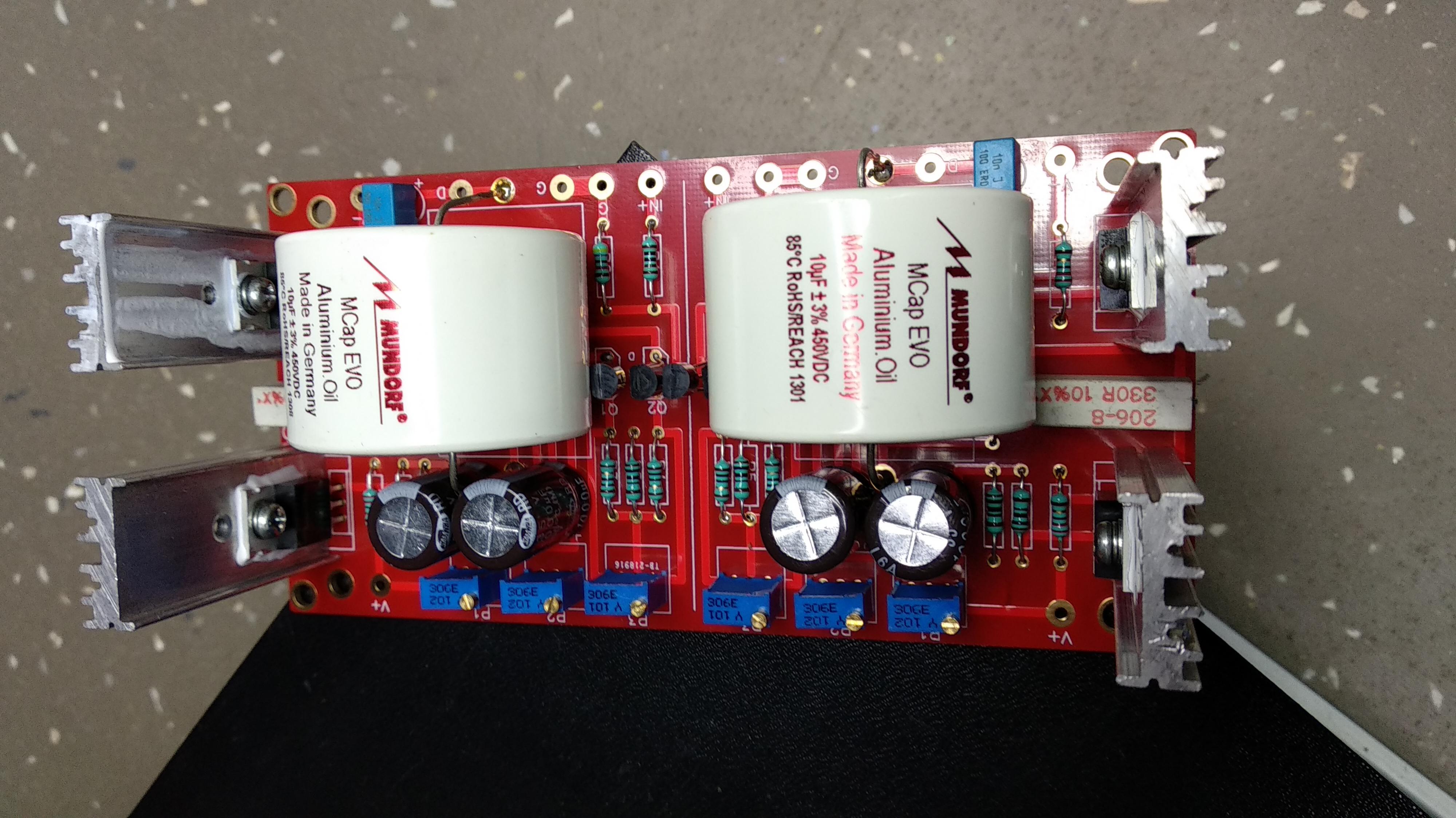

When setting Offset, has anyone had trouble with it not staying steady? I’m now able to bias it to 1V across R10 and 11 but DC Offset I have struggled with settling on both channels.
I have confirmed the preamp works as I set the offset as close to 0 as possible and it played fine but checked the offset after and it’s inconsistent. I also noticed it changes drastically as soon as I remove the cover.
Are you measuring dc offset before the output capacitor?
Also use shorting plug or resistor between hot and ground on input.
BA3 pre is so sensitive about temperature change. If you breathe out to mosfets, dc offset may jump all around.
Try not to breathe while adjusting, and if there is air blower or conditioner, turn it off.
When pre heats up, adjust dc offset to "near" zero and be happy with it.
There will be no dc at the output after all, because of the cap..

I’m measuring before the cap. My problem could be me setting it in my garage while it’s a bit chilly. I’ll bring it in the house tonight and re-do the procedure in my listening room under a controlled temp. I’m using Rca grounding plugs and resistor loads on the outputs.
That’s why there are caps on output. If it was steady, you wouldn’t need the caps. This is normal behavior for this circuit.
Bias/offset is easier to set if you connect a resistor across the outputs, 10-20k, whatever, just so the circuit has something to look at.
Dennis is 100% correct however - it's not going to be super stable (because of temperature fluctuations mostly) and the cap is there to make it not matter.

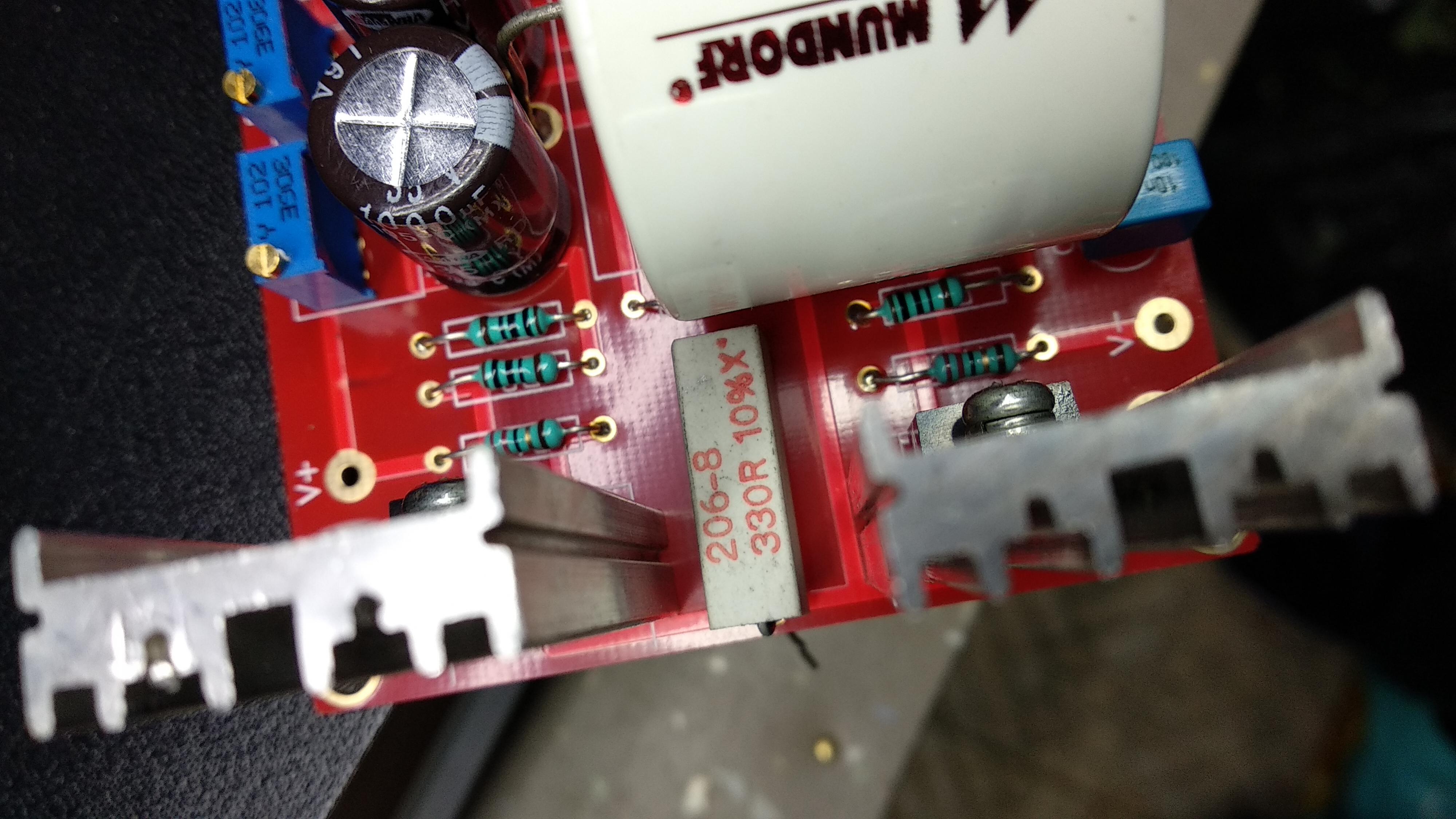

good evening. can i use these resistors on this place ?
will the heat sinks be sufficient?
thank you
Is these mosfets reverse mounted?
