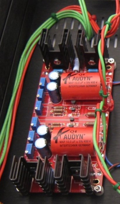

BA-3 As Preamp
As above, Mosfets reversed (unless you are using something with a different pinout.)
Pic from build guide as ref.

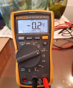

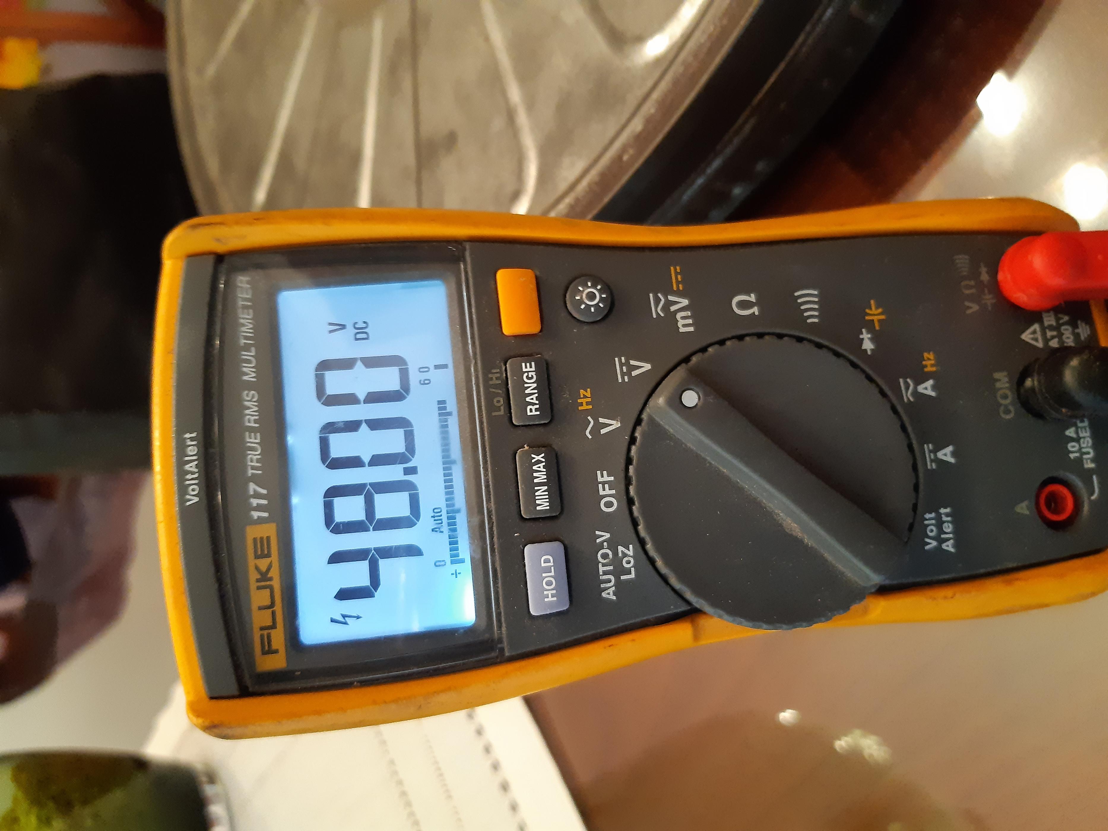

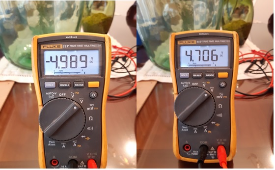

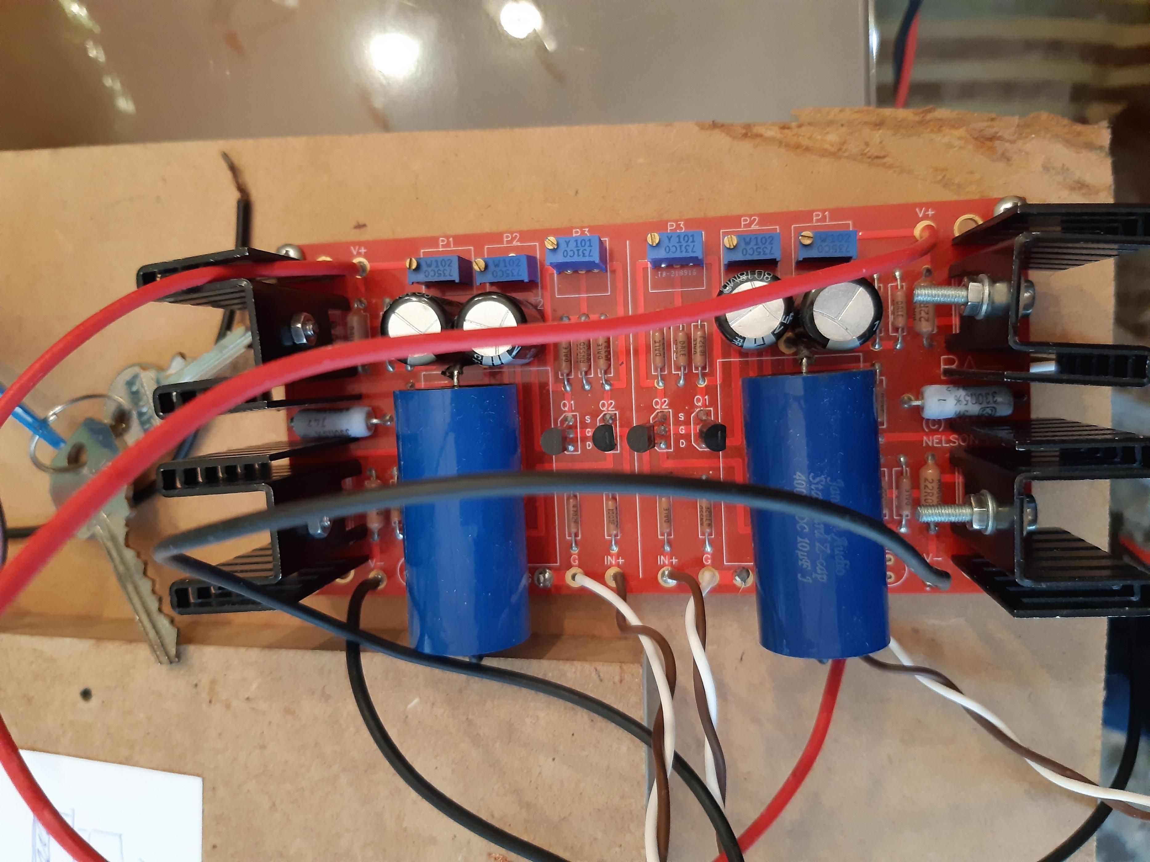

Jfet or mosfet damage
Hi, I need some help. I have proposed to finish my BA3 preamplifier and I have some problems, which I think indicate that I have damaged jfets. What values ​​can I measure and within what range should they give?
A bit of information: I use genuine LS jfets.
Fairchild mosfets.
V Dale resistors and Nichicon and Jantzen capacitors. All bought in mouser and official stores.
I use a psu with an LM317 / 337 source with + -24.2 volts.
I hope your help in case I have to change a transistor or other.
A greeting

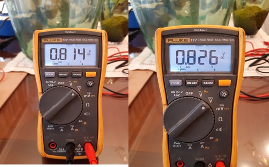

I cannot stabilize the voltage on R 10 and 11. And the DC between R12 and ground oscillates a lot, I still have 10mV as it happens to 200mV.
I have measured Vgs in jfets and I have 19 volts.
In mosfets about 5.9 - 6 volts.
These are doubts that come up in the assembly checks that I am doing to know if things are going well.

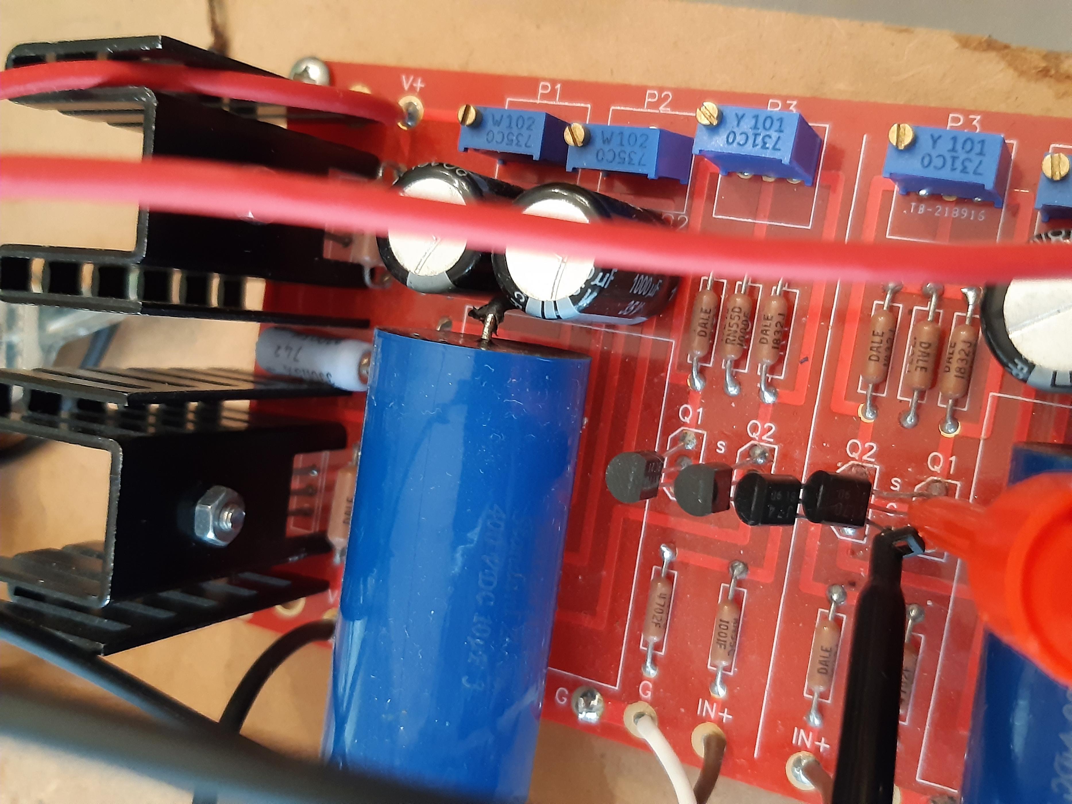

Hi, first of all, thanks for the quick responses.
I have a 47Kohm resistor at the output to ground and the input closed in loop with the ground.
I have reviewed the welds and now I notice that the DC is more stable, reaching 30mV with little oscillation. But I am not clear about the values ​​that I have in the jfets.
Thanks a lot

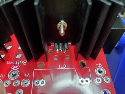

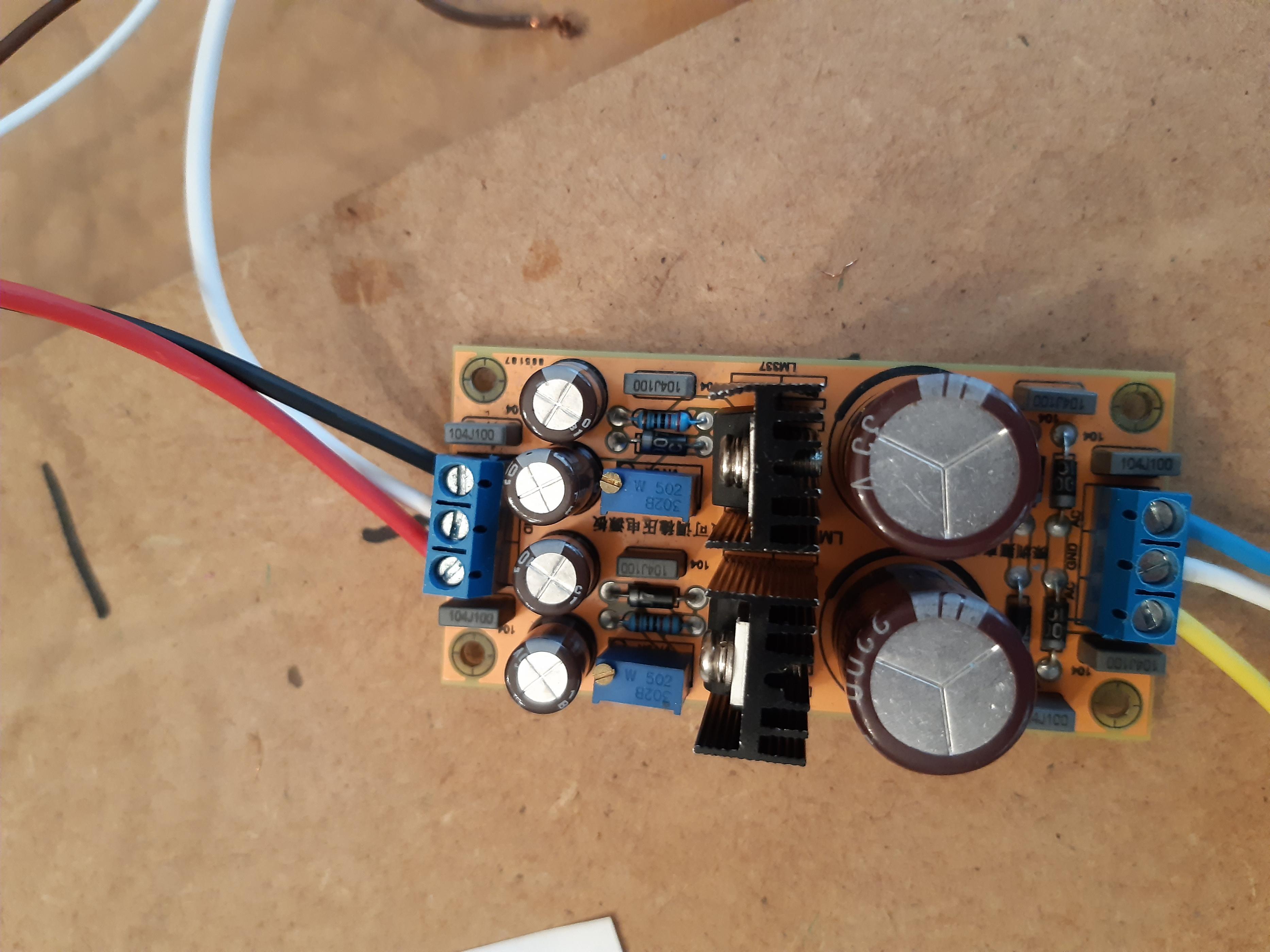

I'm using the Glassware Dual / Bipolar Lv-Reg PSU, and , I made a really stupid stupid mistake, and welded most of the board on the wrong side, until I got to the lm317's. I would not be able to desolder and resolder without destroying this thing, so I did this.....These are the only parts that would have been wrong, it is tight so I soldered top(bottom) and bottom(top), and put shrink wrap on pins.
They included diifferent resistors for R#3 to set amperage out to load, 1r, .33r, 3.3r, and 10r. With a 24-0-24 trafo, amps= v/r, this seems like high amperage. I have 18r and 100r, 3 watt resistors on hand. 18r would be 1.3a, and 100r would be .24a. Which is the better choice?
Better brains are always welcome, thank you.
