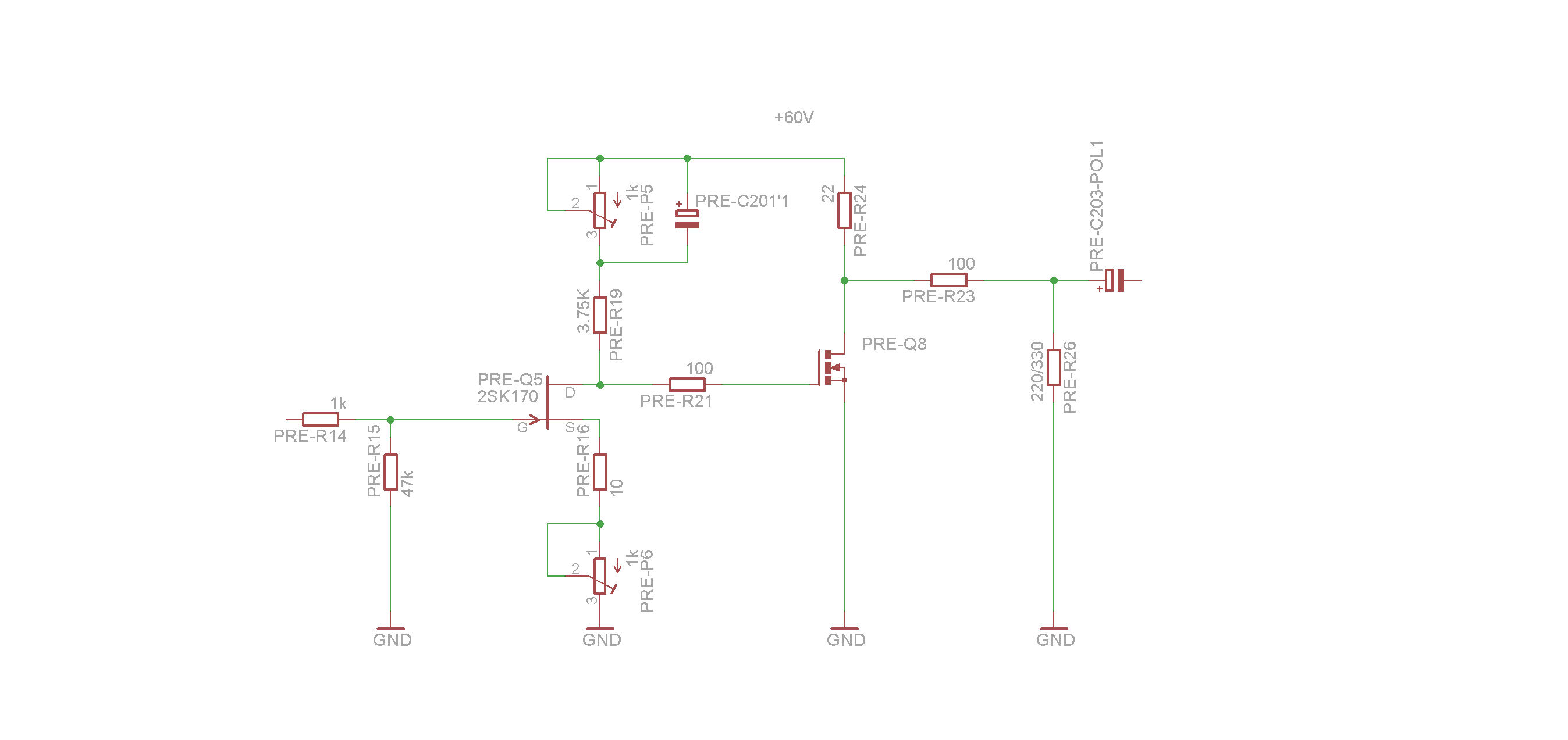

I've been wondering these days while i was making the layout for the BA3 FE(since i could not buy those ...shipping issues) for feeding a single ended BA3 output stage:
"Why use complementary when all i want is single ended from needle to speaker!?"
Do i have such an option/previous project in a non feedback approach?
I thought of just using the single ended approach with a 50-60V rail for the last stage mosfet.
Anyone has even considered this as diy?

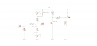

I just finished what i was intending... not simulated yet; but that's the jest of what i'm aiming at:
Edit:
part names and values do not mean anything... just pasted from an already drawn Ba3Fe
Edit:

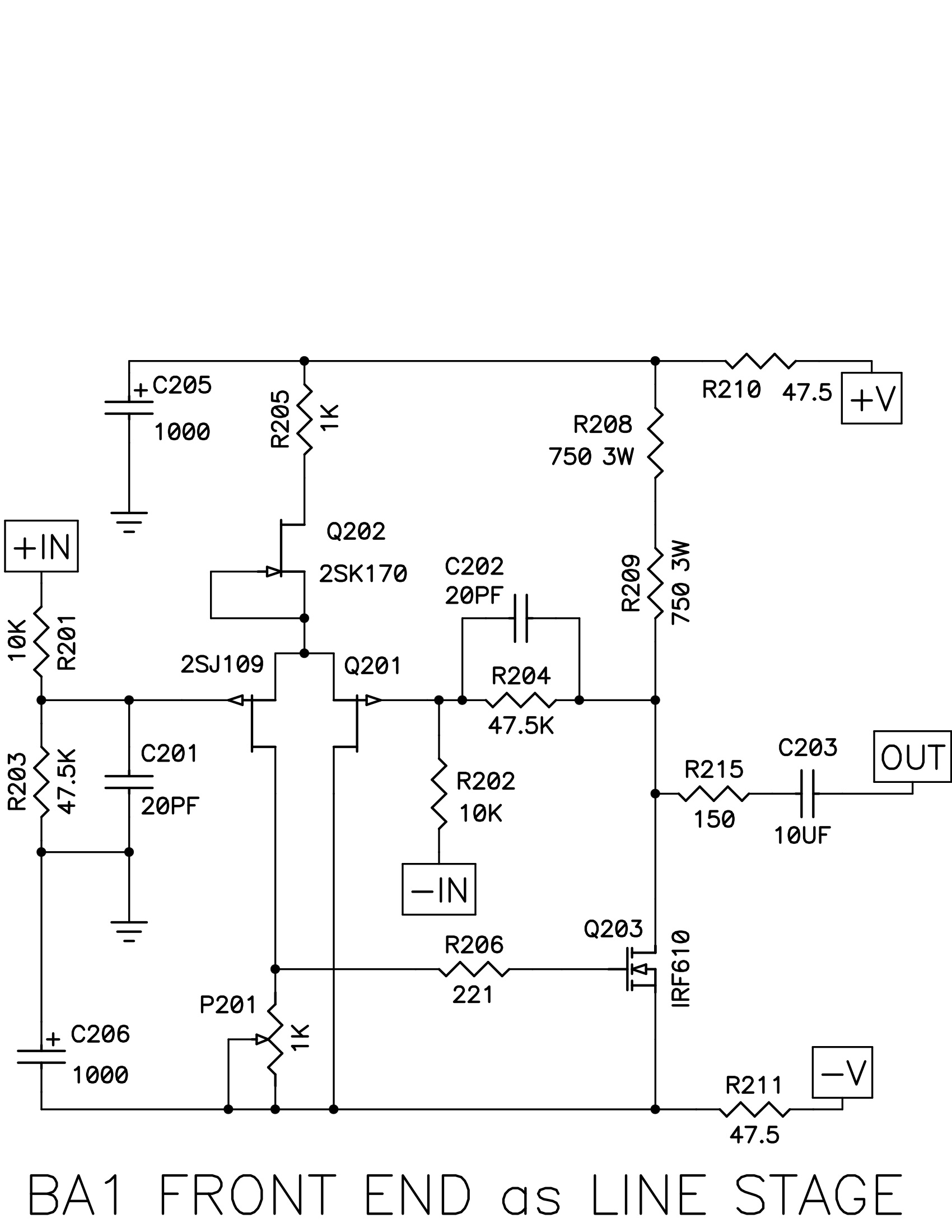

This one has feedback...but it's a nice circuit and may give you some inspiration:
Salas DCG3 preamp (line & headphone)
How about this...
The answers to the immediate questions will be;
Q202, about 8ma Idss
Q201, yes, of course you can use a matched pair of LSJ74B/2SK74BL
PSU +/-24v
The BA-1 front end PCB will work.
PSU +/-24v
Thank you all for the sugestions; but the bride of zen is an absurdly good match for a BA3 SE output stage ... i am amazed by the simplicity and elegance of the approach ...why these were not paired up to become Ba3 i wonder?
Low input impedance, high output impedance and only 15db gain. That's probably why.
Seconded![]()
Nice. And you get balanced input for free.
To increase the unobtainium part count, one might replace the IRF610
with a 2sk2013. 🙂
i am glad i thought about that ... wouldn't a nice stage with a 2sk170 bring easily 15 db gain and solve the input impeDANCE 🙂 ?
and outputwise, using the prohibitively rare and properly biased 2sk2013's wouldn't solve the output impedance ... so all is left is the simulation and breadboard dance towards a functional solution?
