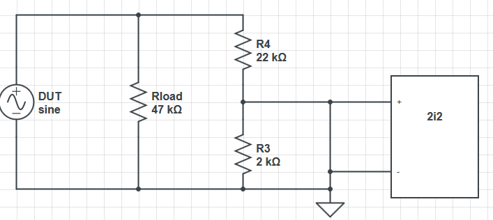

I followed advice from xrk971 on this and made the following input protection/load circuit for my interface.
attachment.php
Sorry for the shoddy diagram, not my forte. In any case, R3/4 serve to limit the voltage going into the interface as a safety measure. I used 10-50W resistors for amp measurements, but for preamp i guess much less will do fine. I guess it's possible to do both channels simultaneously, in which case you'd need two of these, with one input on your 2i2 per channel.
Hope that's useful.
