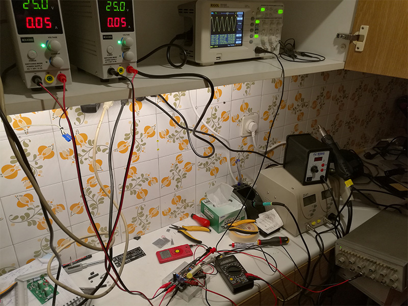

Here we go. Some progress.
The pre seems to bias nicely even with random unmatched 610/9610. I am using them for tests so that I do not blow my matched Toshibas.
BTW I really hate how twitchy the pots are (Currently using 1k). I want to try a big series resistor to ballpark bias the MOSFETs and then use a smaller trimmer to fine-tune the dc offset. It should be less sensitive and make it easier to precisely tune the offset. Plus it should be a bit more stable as the trimmer heats up or ages.
Now all I need to decide is what regulation to use...
