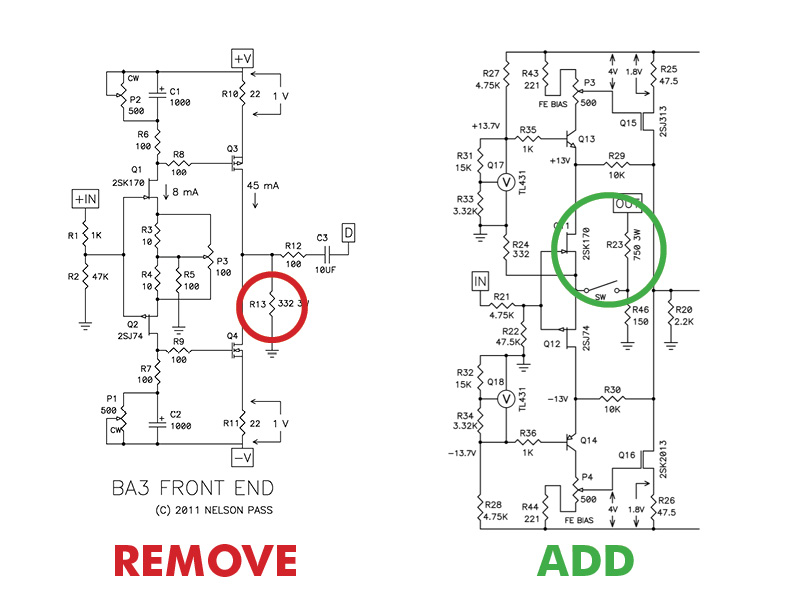

Kind of off topic but I've communicated with someone who has changed the feedback arrangement on the BA-3 to one like the Vfet 2 front end. It's very interesting and it makes the offset stable (no need for a cap). All one needs is a few resistors to try it. I haven't tried it but it's worth a shot.

Kind of off topic but I've communicated with someone who has changed the feedback arrangement on the BA-3 to one like the Vfet 2 front end. It's very interesting and it makes the offset stable (no need for a cap). All one needs is a few resistors to try it. I haven't tried it but it's worth a shot.[/QUOTE]
You can find more on this in the BA3 balanced thread. Generg has experimented with it and has also posted some simulations. I wonder how it changes the sound?

Nasbap - so they are adding feedback. That's a great idea, totally worth trying.
I'd still keep the cap if using this as a preamp, however.
Here's the theory. BA-3 on left, Vfet front end on right.
Yes, it's adding feedback. I have no idea how it sounds but in theory it would work and work well.
