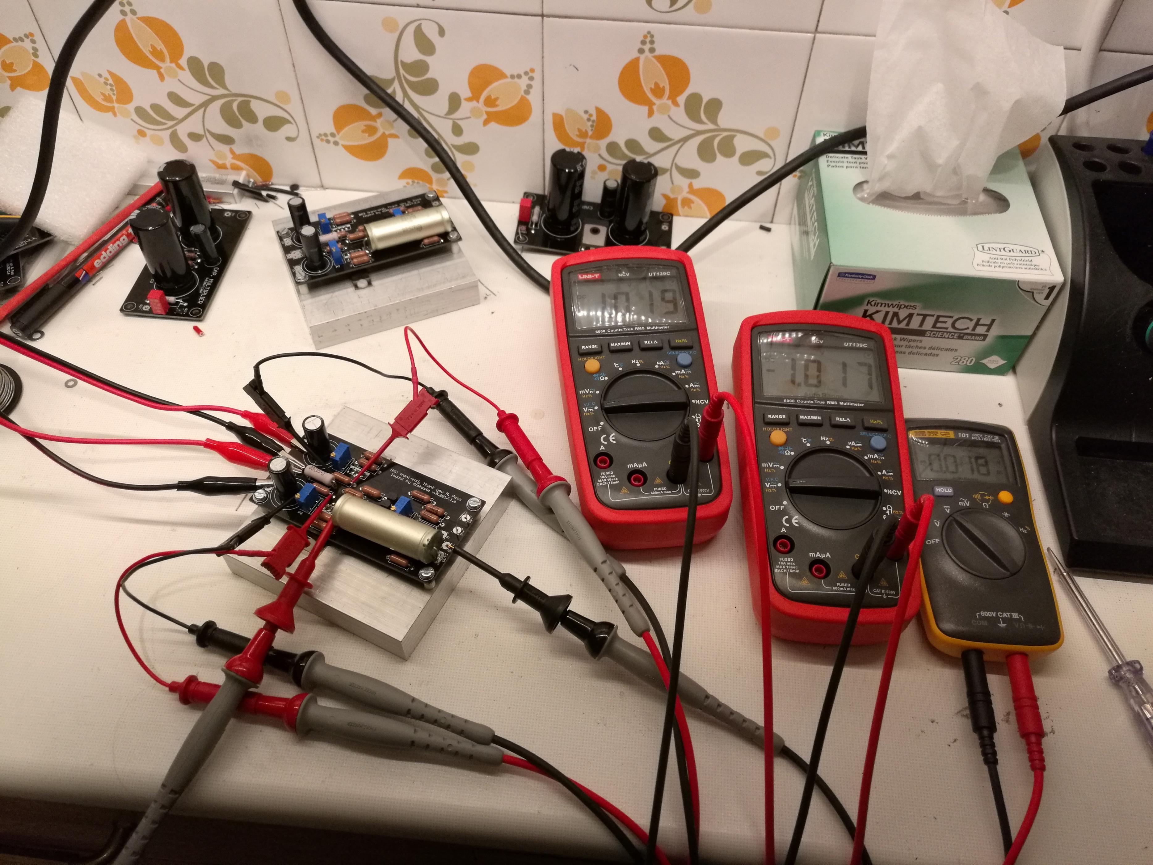

Which points are you using to read DC offset..a pic would be helpful.
Cheers
Here is a photo if it helps. You should be able to extrapolate where to attach the probes on your pcb.
The probes closer to the cap measure offset (back side of cap and output return)
Thank you so much for reverting, meanwhile I used the 330R resistor (R13 as per schematic), put probes around it an set DC offset...Have biased the amp to about 80%, will use it for some time then attempt a full bias...
