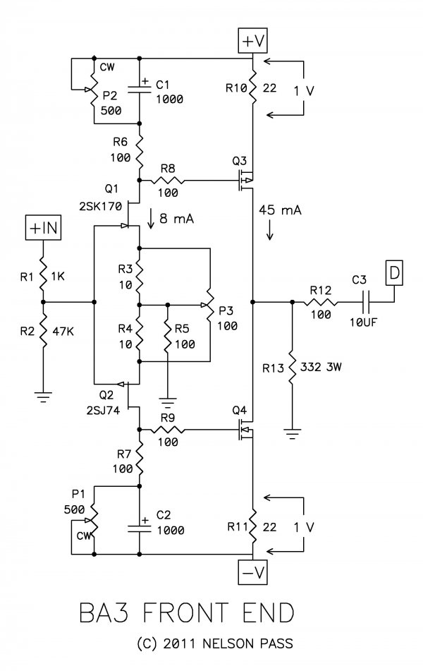

ref. to enclosed sch
decrease R5 until you are satisfied with gain
68R there will give almost 3db of increase
51R will give almost 5db

Thanks Zen, will do. I thought that R5 is one of the resistors to change. Just a solder slingers guess.
This morning I installed another op-amp in my op-amp phono pre with 2 db more gain and the BA-3 has enough oomf with enough volume right now but it would be nice if I can use it with my J-fet phono pre as well. I think I will go with 68 ohms to start. Right now with a higher gain phono pre the sound has more authority with my F4. The F4 is one of, if not, my favorite amplifier among the 6 finished FW clones I have.
About to forget, same schematic used.
I have built this preamp several years ago. Some uf of PP´s in the output and was not so impressed.
Now I revived it. First finding: the nominations of P1 and P2 in the schematic are reversed. Had quite some fun.
With Silmics in the output the preamp is overly polite. With Nichicon FG, KZ and biplolars it is much more fun but still a bit recessed.
I changed the gain according to Zenmod and Andrew - and everything is fine now. Very open and dynamic.
Many thanks.

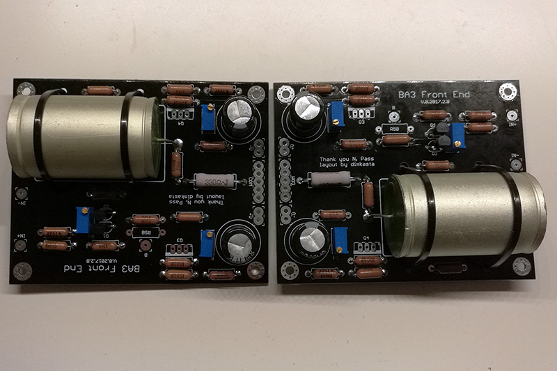

Version b of my boards arrived after almost 2 months in customs. The crisis is now messing with our hobbies as well...
Anway...
They seem to bias up nicely, and the FQP pairs seem very close without any matching.
Here is some porn

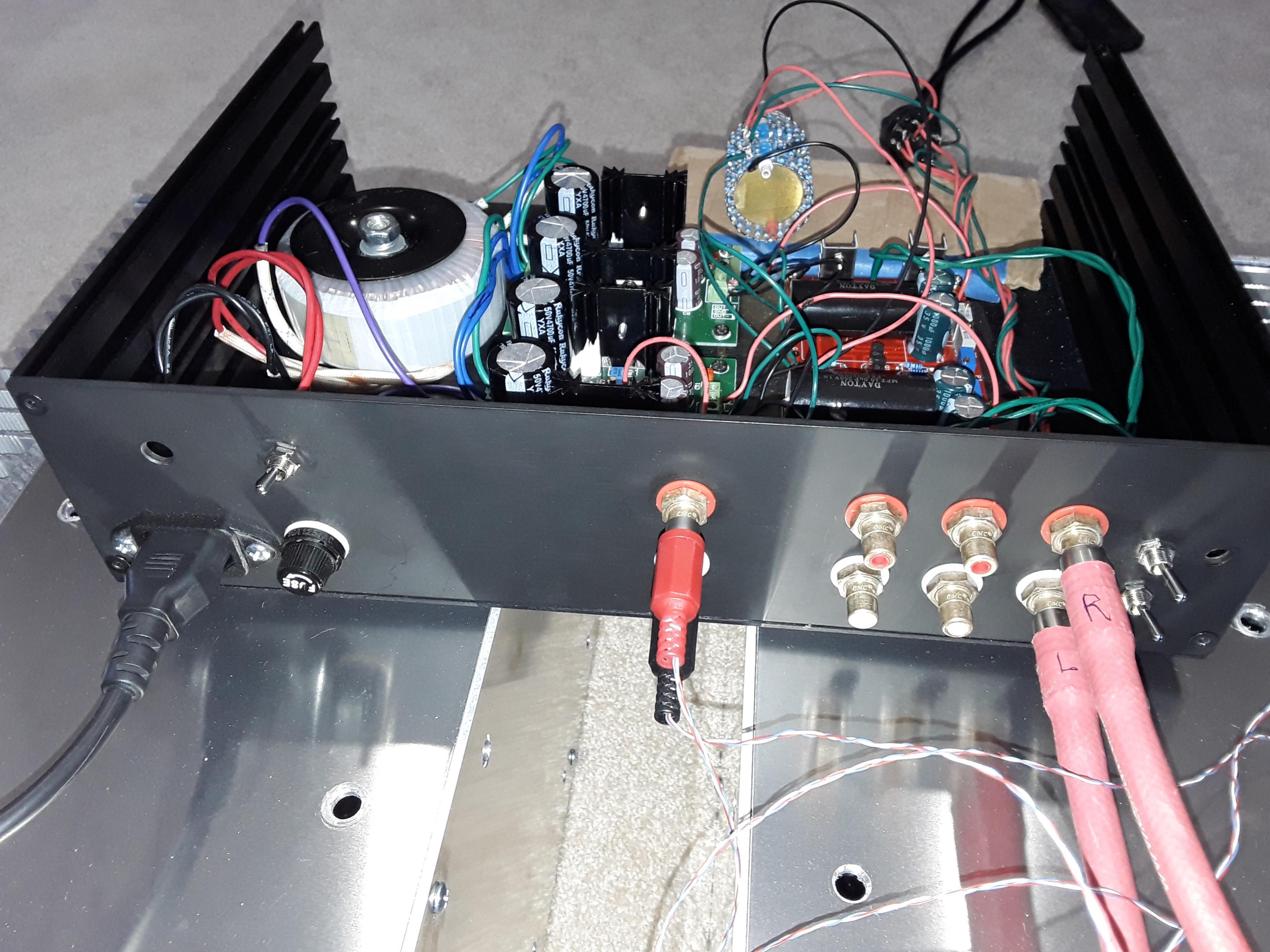

One more..
High\low gain switches
Dayton Audio precision 10uF caps
317/337 regs
24v operation
Galaxy case
Pure silver rcas
Fairchild mosfets
LS jfets
Antek as-0522 transformer
Budget stepped pot
Silver contact selector switch
Generic copper wire
Face plate needs milling.
Driving MoFo monoblocks
Vince

The power supplies are + / - 24V. The unclipped output is 40 v p-p. The gain is just a little over 10X. This seems a lot lower than what NP states in his article. I assume this is due to the gain of the output transistors. To increase gain, is it as simple as increase R6 and R7 or decrease R5?
The -3dB point is about 1 MHz. What a wide bandwidth. I assume I can shave that down with a larger input resistor?
