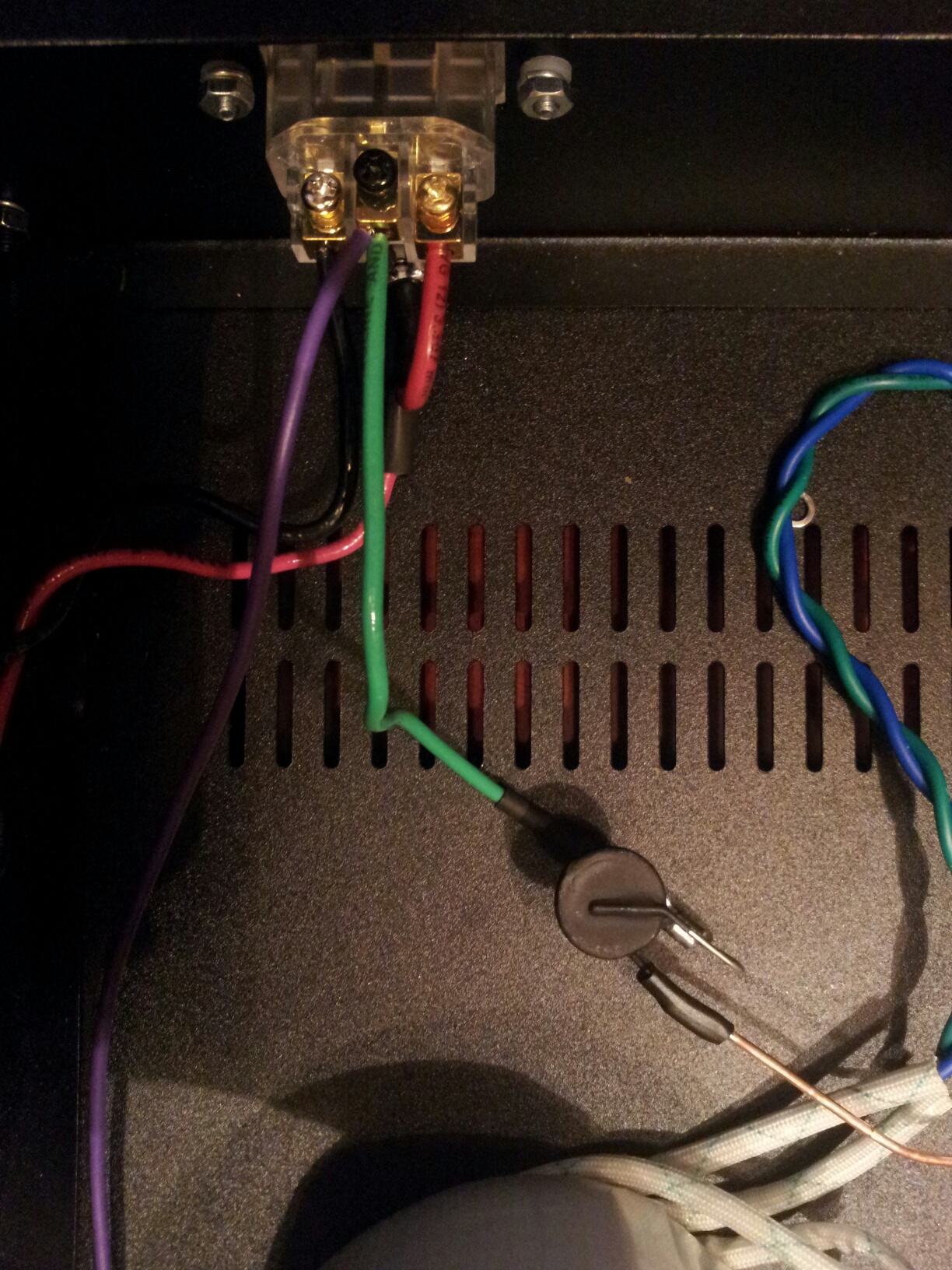

Immediately popped a 2A fast blow fuse. Damn it.

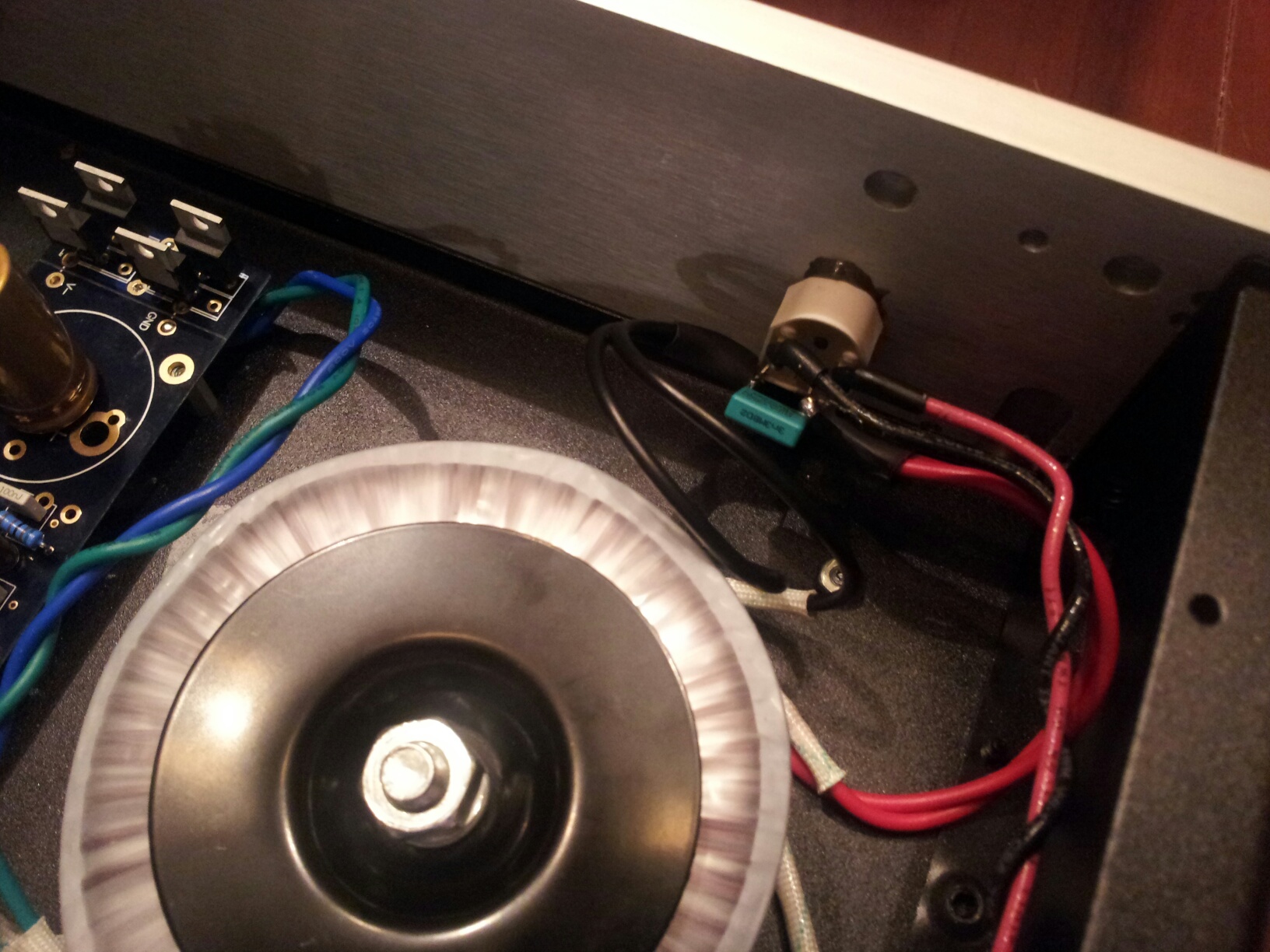

- From the power inlet Red is Live, black is N.
- Antek transformer, Primary has two leads for power. Red and Red/ black and black tied to each other (i.e. red + red = live, black + black = N) after the power switch.
- Purple wire is transformer "static shield" that should be grounded.

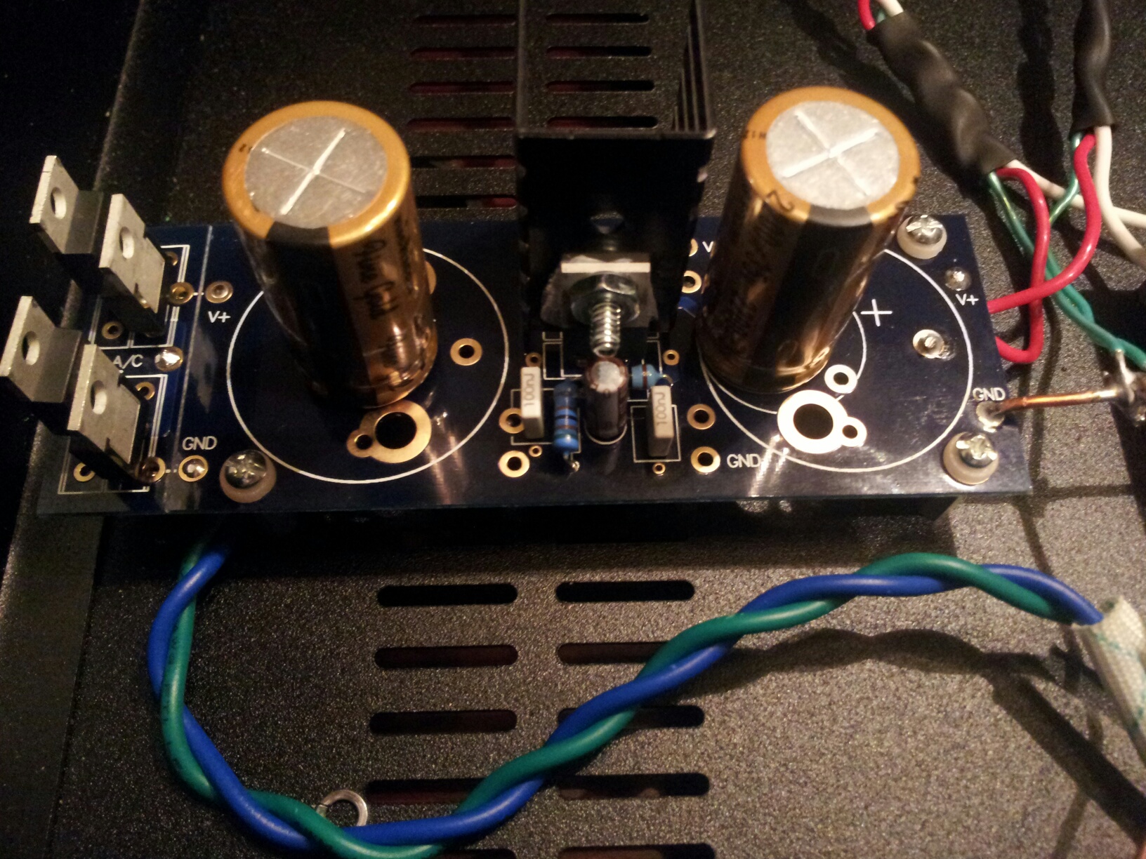

- Secondaries to the PSU boards. Each set of secondaries (green and blue) measure infinate resistance between them.
- Cap on the output of the power switch (Y rated)
- Doesn't matter which secondaries go to the diode bridge right? It's AC so I think it doesn't matter. It's not like the A/C connections on the diode board are specific, right?
- Leads from the PSU (red/White/Green) are not connected to anything yet.
- I briefly measured about 5V on the PSU before I realized the fuse was blown.
Could this just be the the startup load that blew the fuse? I have 1A slow-blow fuses I will use but I thought I'd start it with a fast blow to be safe.
Better check the primary wiring. Antek has PDFs of their transformer wiring.
I believe it's red/red and black/black connected on the primary.

On second thought your primary looks ok. The twisted red and black though me off.
Attach that wire to screw where the thermistor is attached, not AC earth. It's a subtle change, but still worth doing. (That's not causing the fuses to blow, however)
Yes and no, make sure the blue/green are attached to the same places on each bridgeDoesn't matter which secondaries go to the diode bridge right? It's AC so I think it doesn't matter. It's not like the A/C connections on the diode board are specific, right?
Take all that off, including the tied grounds and see if each individual PCB is working properly.- Leads from the PSU (red/White/Green) are not connected to anything yet.

I'll look at the A/C connection from the transformer to the diode board. I am not sure if each board is hooked up the same way. I thought it didn't matter.
6L6, good idea to test each board independently…I'll try that.
Vienna, the thermistor is just a ground loop breaker/isolator. Maybe I should leave it out when testing. Maybe it's safer that way.

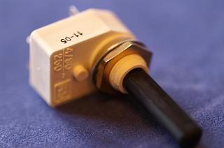

Also I should not that when switched on there was quite a spark/arc inside the power switch. It has a transparent window on the back of the switch and there was some arcing when switched on. Is this normal?

Leave the thermistor, it's not going to make any difference in troubleshooting.
What kind of switch is that? SPST? DPDT? If it only has a single pole you might just have the switch wired wrong...
DPST. Here's the specs:
RS-4A
A DPST switch with a glass-loaded flame retardant body and spindle, and silver contacts.
Capable of withstanding inrush current of 64A for 10ms.
Contact rating 250VAC 4A
