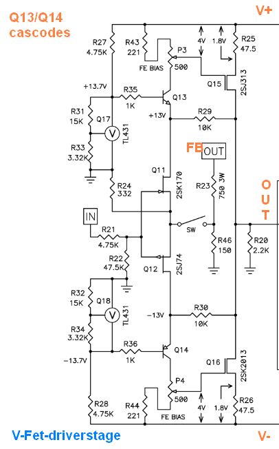

I would like to build a BA-3, but my transformers/PSU gives +/-51VDC. The J-fet will not survive. But can I supply the J-fets with a lover voltage and lift the Source resistors on the board for the Driver mosfets, and supply them with the +/-51VDC as for the output followers? will other parameters be affected, like gain? BIAS settings?

Don’t know about that suggestion, but I would think cascoding the JFETs is the easiest way. Beware that with such a high voltage, class A envelope will be quite small.
I don’t know how to cascode this circuit, but Mighty does. I do think, however, there will be less hassle just buying a new transformer. Maybe even cheaper too.
short - no
TO220 mosfet modulation is referenced to rail, meaning that drain resistors of input JFets and source resistors of TO220 mosfets must be on same potential (top sides of course)
no other way than cascoding input JFets, analyzing dissipation of mosfets, same for output mosfets, rethinking heatsinking of small mosfets and big ones

Hello Andy,
a cascoded BA-3 frontend would look very similar to the V-Fet-driverstage of Mr. Pass. But +-51 V DC on the rails is a lot...

yup
that schm is informative; 2 main details are:
  • Pa is having shitload of TL431 and was in mood to use them ( instead of usual 2 resistors divider, even without filtration)
  • Pa is taking 0V7 as Vbe; one of most important and ofte used constants in Universe
  • 42 is easily divided with 0V7
  • and vice versa
:clown:
not good
you can use that arrangement only if there is one (summed) load at secondary side....... meaning - xformers are summed/combined both at primary and secondary
and even then - in case of parallel summing/combining on secondary side, that's best to arrange after diode bridges
- I had that brilliant idea too, eons ago, but ppl smarter than me told me reasons against
