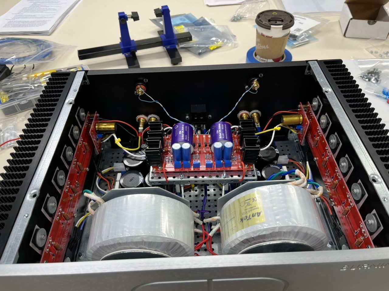

Pics of what exactly? I can take pics tonight.

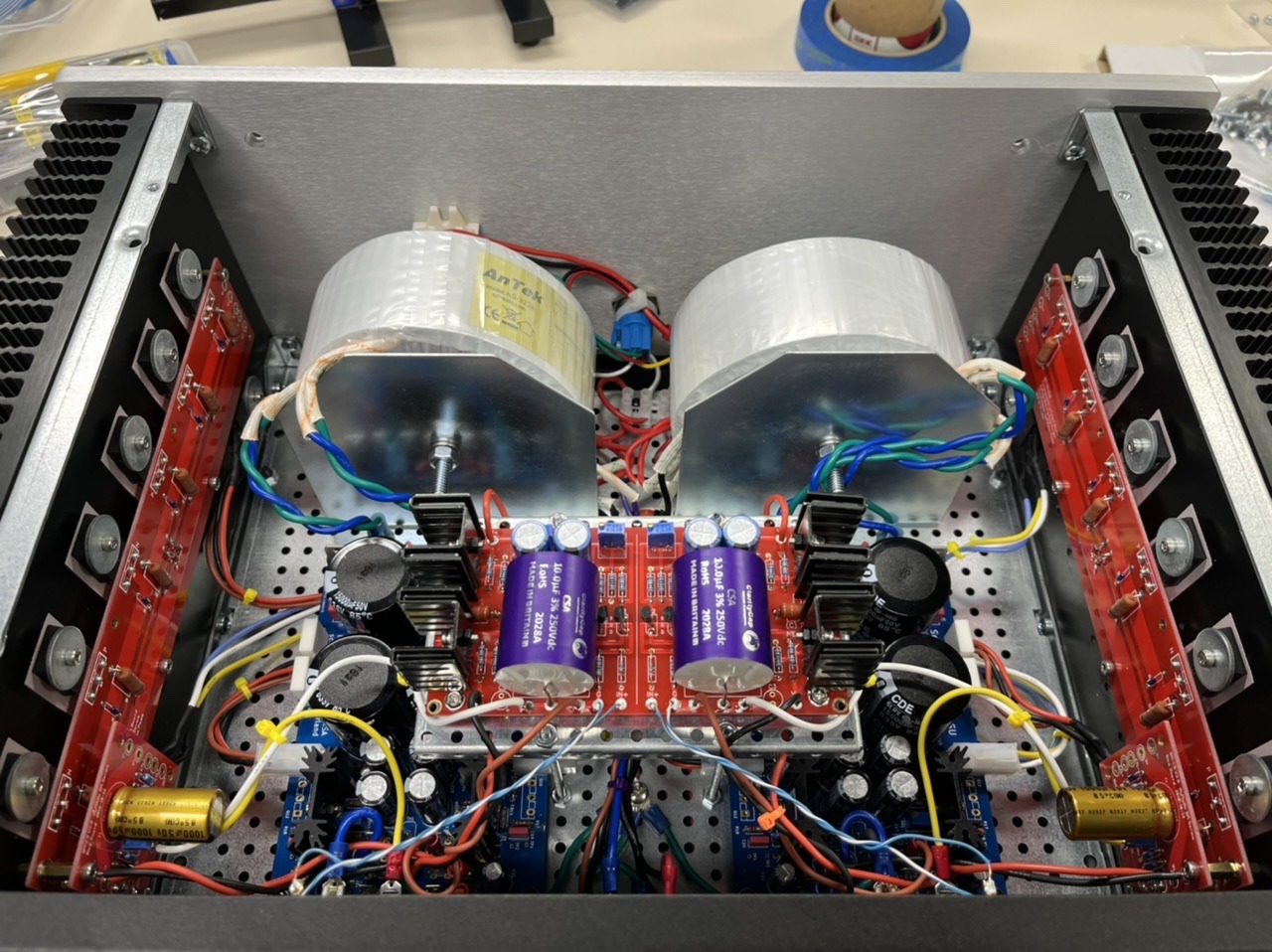

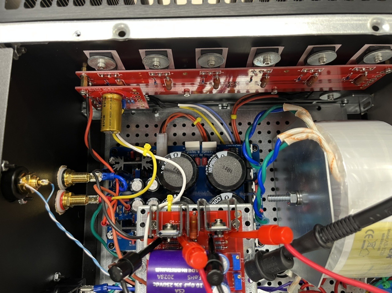

You asked «pics of what?». The answer is pics of the amplifier, several angles, overview an closeups, so that we are enabled to help you.
If measured at the correct test points, your post-cap offset on the front end indicates something severely wrong with both your front end circuit, but also that the output caps are not working.
I recommend you post pics, then come back with front end measurements:

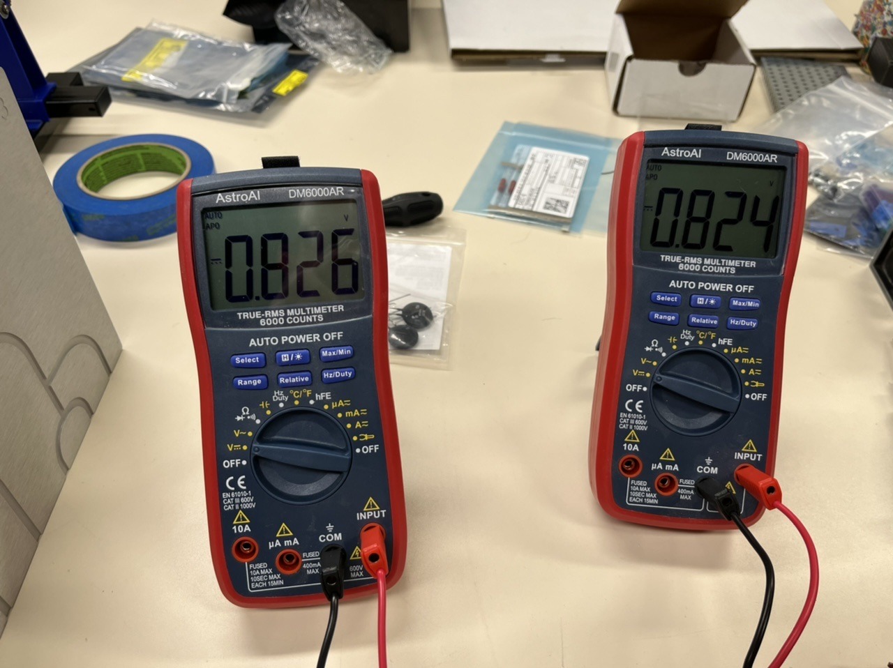

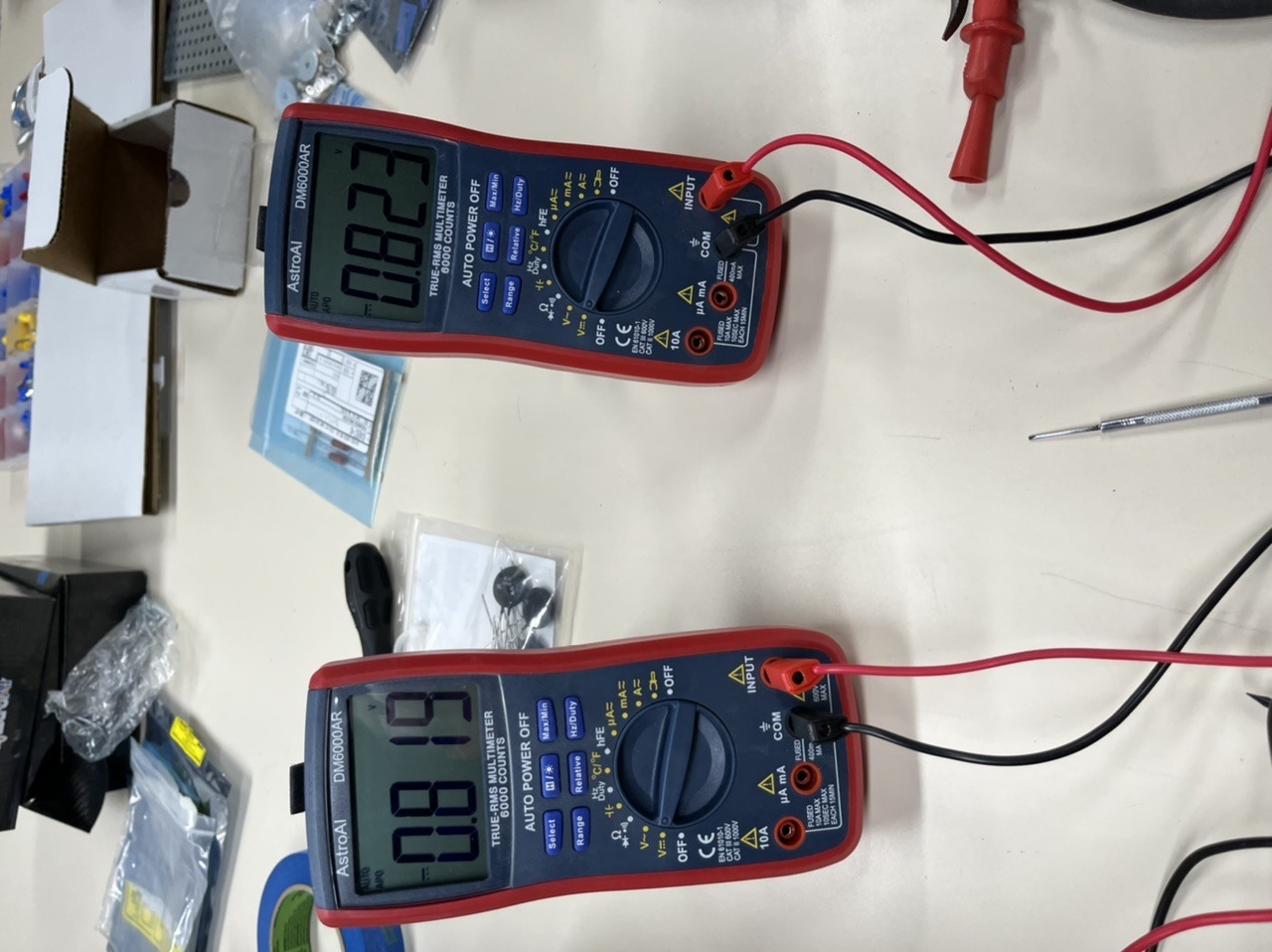

1: Voltage drop across R11 and R12 on both channels. Adjust to equalize @ 800mV drop or so.

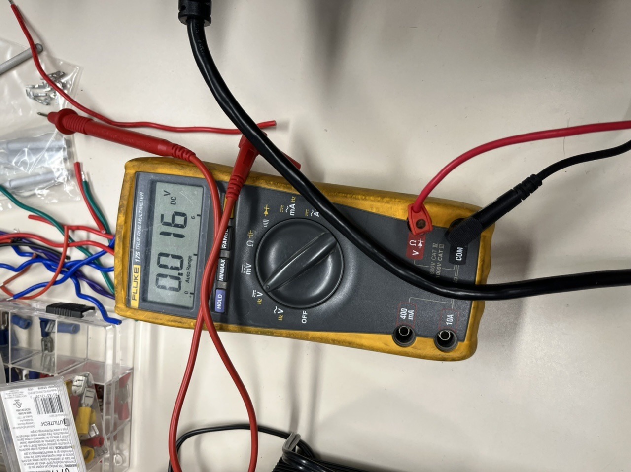

2: FE DC offset before the cap. Mount probes at input side of output cap, the other @ audio gnd, either @ FE board or @ PSU 0v / gnd takeoff.

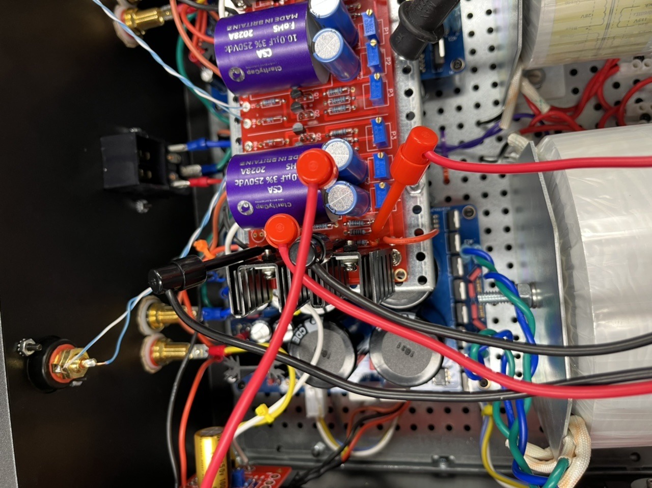

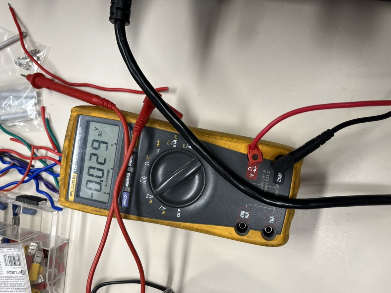

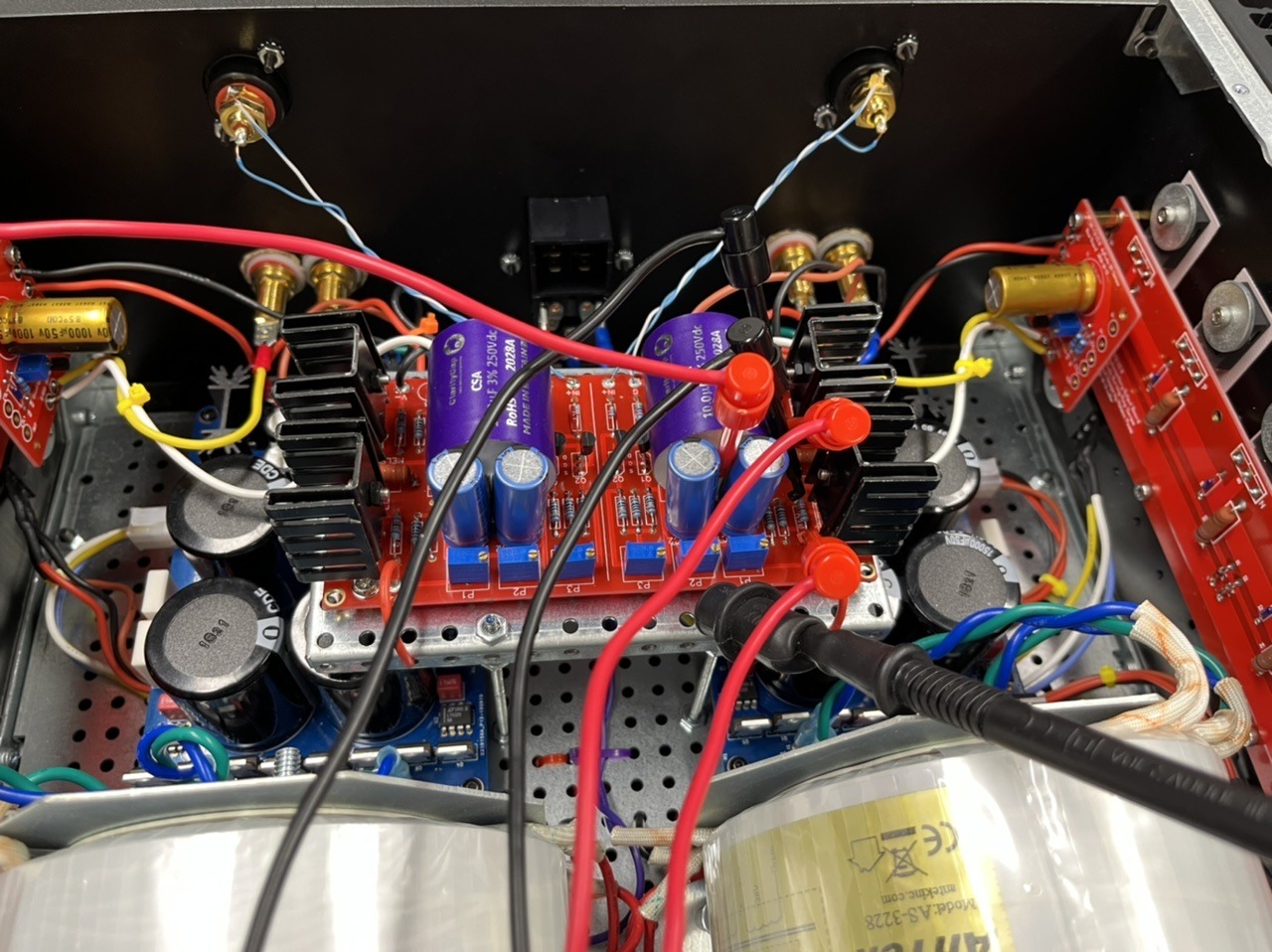

Here’s the left channel
Assuming you are measuring the voltage across R10 and R11 in the ~800+mV pics for both left and right channels
AND
that you're measuring the offset in the correct place... and getting 29 and 16mV for R and L
THEN
That looks good to me. No crazy voltages like before. Did you do anything differently?
I can't see if your FE board has ground connections. Does it? I can pretty clearly seen V+ and V- along with the Input signal wiring and the signal to the output stage boards, but I can't see the GND. Not a great angle in any of the pics. Have you posted a wiring diagram previously?
Pics are enlightening. Looks like you are handy with the soldering iron.
In conclusion: measurements indicate FE is OK. Do however check the following:
1: Those wires going through the riser panel holes: make sure they are fully intact. Plan to reroute or protect them better, for the long term. Those holes are quite sharp.
2: I think you allready did this, but if not make sure the front end MOSFET heatsinks are not touching anything, especially the nuts under them.
3: Let’s move on to the output stage. Starting with closeups of the boards. We need closeups of:
  • bias boards
  • both output stages.
  • wiring to and from
  • Also, please remove the big washers on your transistors, and confirm all the P channel and N channels are in the right place.
  • also, confirm with DMM that there is no direct conductivity between transistor and heatsink due to metal fragments or crooked mounting. Put one probe at center pin (middle of the three solder joints on output stage), the other probe at the sink (use another CLEAN hole at the sink, so that the anodization doesn’t hinder conductivity. You want to se «OL» (over limit), or very high resistance.
  • provide closeups of your zener diodes, and try to confirm correct orientation and good solder joints.
When all this is confirmed, I suggest moving along to powering up with bias levels completely turned down.
