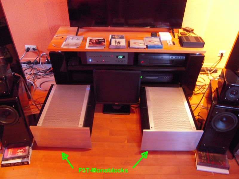

Hello out there,
good suggestion from ItsAllInMyHead in post #1151!
I did exactly that for my F5T-Monoblocks a few years ago. I have ordered 8 heatsinks with a size of 250mm x 210mm and did the rest of the case on my own.
More work to build a case on your own - but classA-heat has to be transfered... temperature coefficient of one heatsink is 0,19 C°/W
https://modushop.biz/site/index.php?route=product/product&path=305&product_id=347
Cheers
Dirk
