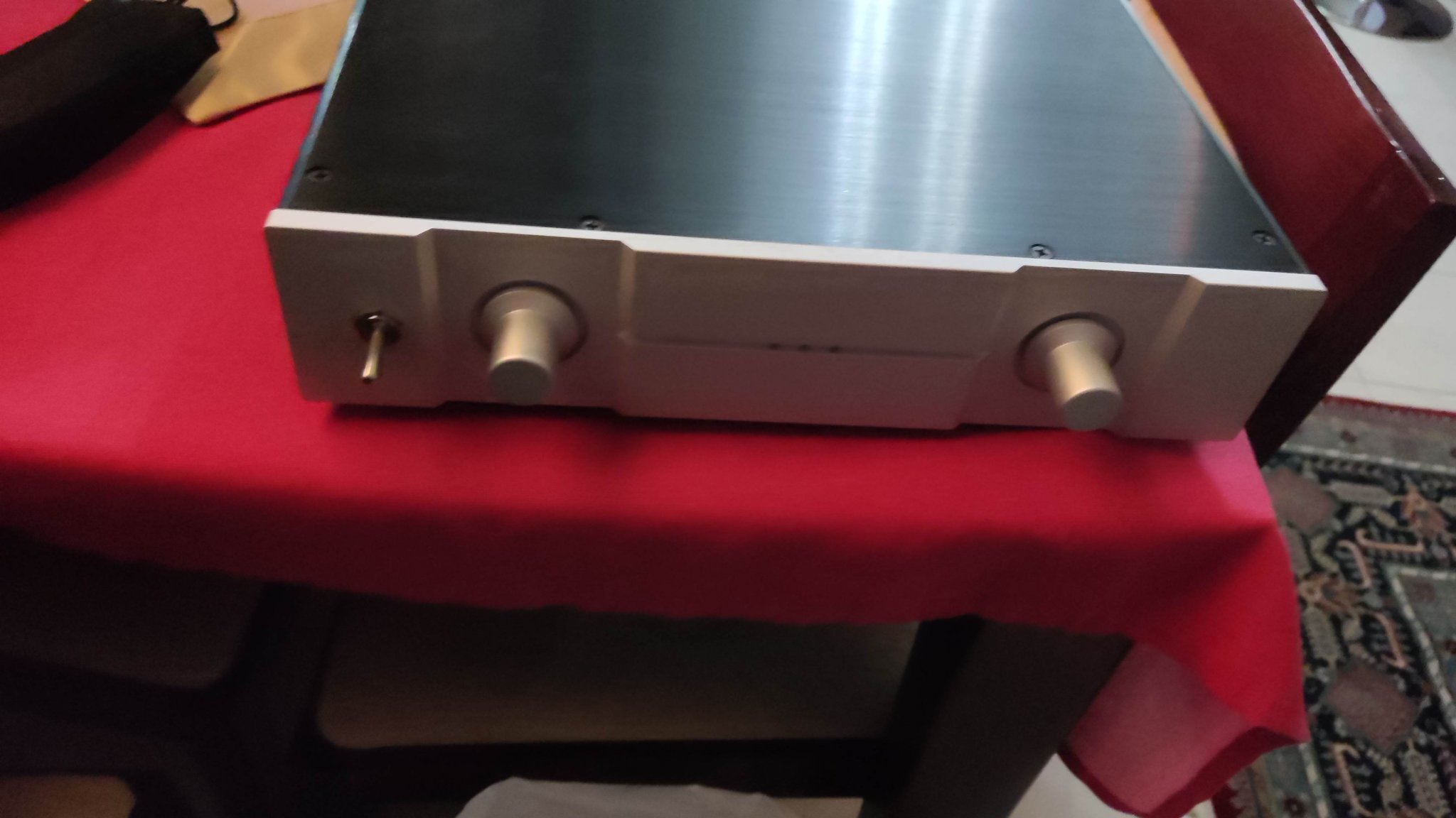

I have a ba-3 preamplifier.
I decided to build the Ba-3 burning amp without to have the pre inside tha same case

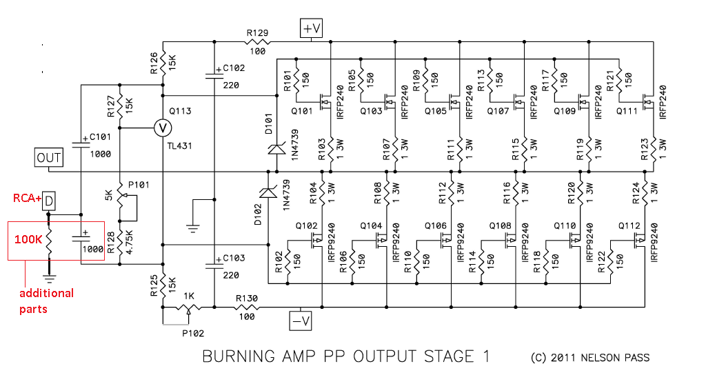

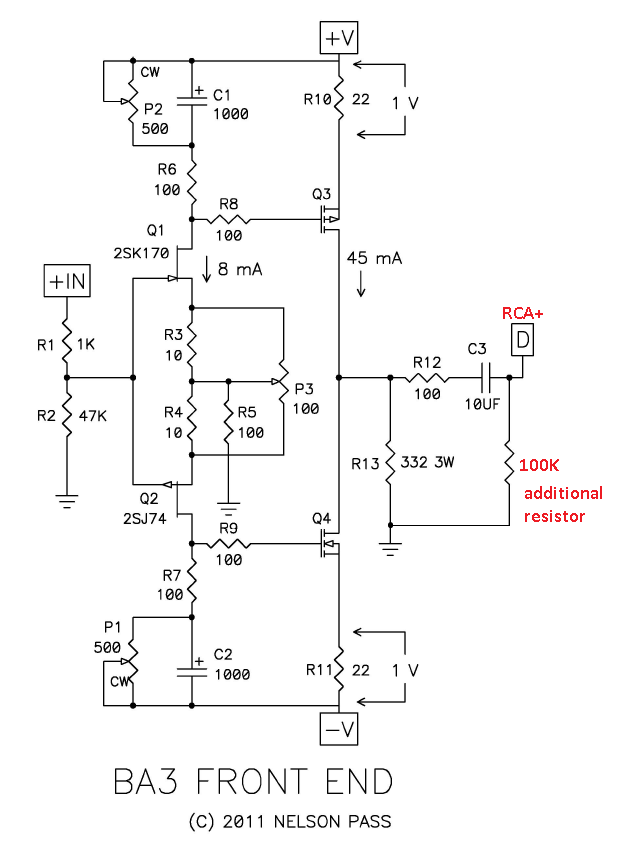

for second part, that's needing some pics

You should understand that having the BA-3 FE boards in a separate case does not make it a pre-amp. Are we not understanding or did you build a full BA-3 pre-amp with volume control and RCA outputs / input selection etc?
So, you do not have a BA-3 pre amp fully built with RCA outputs?
Why are you putting it in a different box?
Diagram of what you have, please? A picture is worth 1000 words.
Andy, awesome as always. I thought that's what was happening, and that's what I was trying to ask in #1205.
You are perfect. That answers a key thing. There is no way I could try to do this in another language. As Andy said, your English is very good. I am trying to be more simple, so I can better help.
Next
Are you trying to leave out the "Front End" boards or the "BA-3" board in the amplifier? If so, why?
The part that is confusing us together is that a BA-3 amplifier has the output boards (and bias boards) that you show in your picture, but it ALSO uses the same board you used in your BA-3 pre-amplifier as a "Front-End".
BA-3 input stage or front end + Complimentary output stage (BA-2) => BA-3 amplifier
Are you intentionally trying to leave out the front end of the amplifier b/c you think you don't need it because it is the same as in your pre-amp? Did you want more of an F4?
Is there something we missed? We can help you with any solution, but we need to be sure of what you want.
