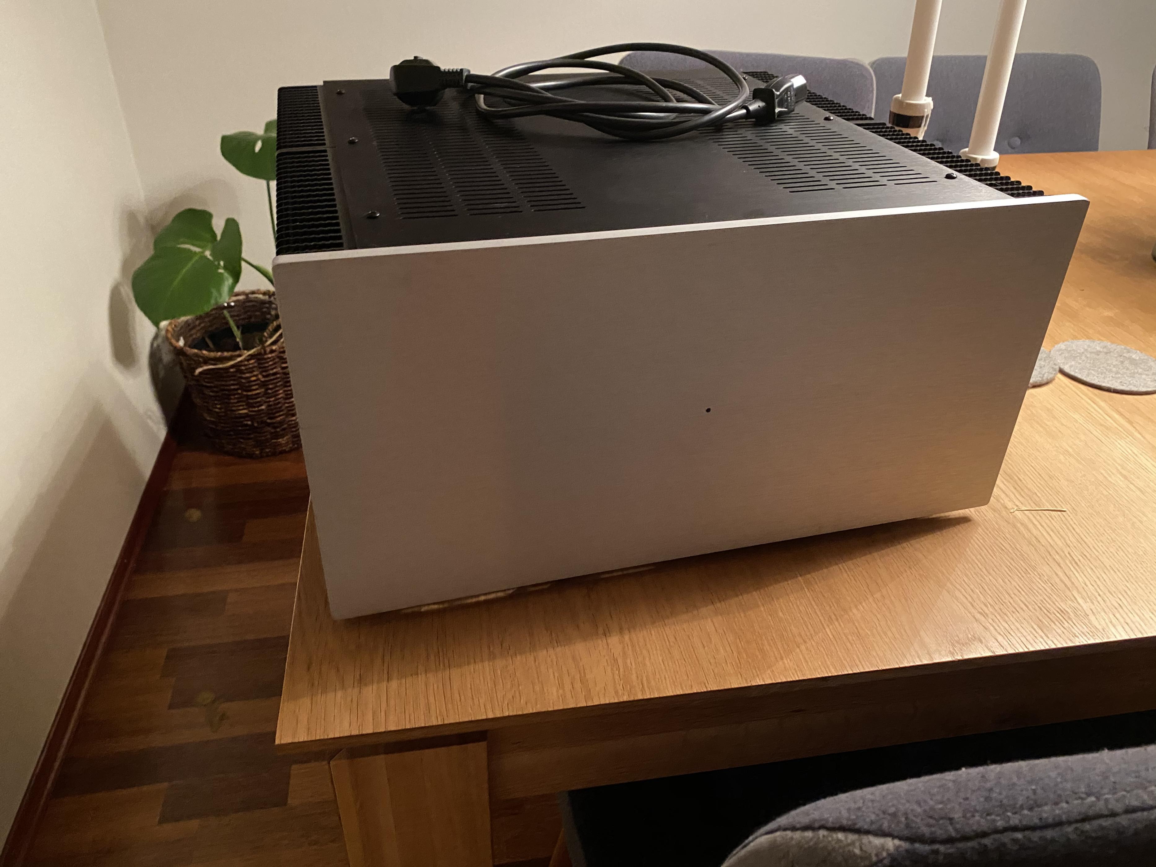

Btw: my bias boards work. In dialogue with Zen Mod, I have concluded that one of my N channel MOSFETs is not matched. 60%-ish more IQ draw to one of them, leaving the other two rather in the cold, so to speak. An error from the store in other words. Hoping for a partial refund. Have ordered a new set of FETs. It is a bummer, since the amp was finished.
Well well, those who wait for something good.
But the guys do a great job for and at the store, and **** happens, a wise man said. For future projects, I may have to make a test jig for FETs myself. And buy a lab PSU. And lots of other things. When I am rich maybe? Yes...
