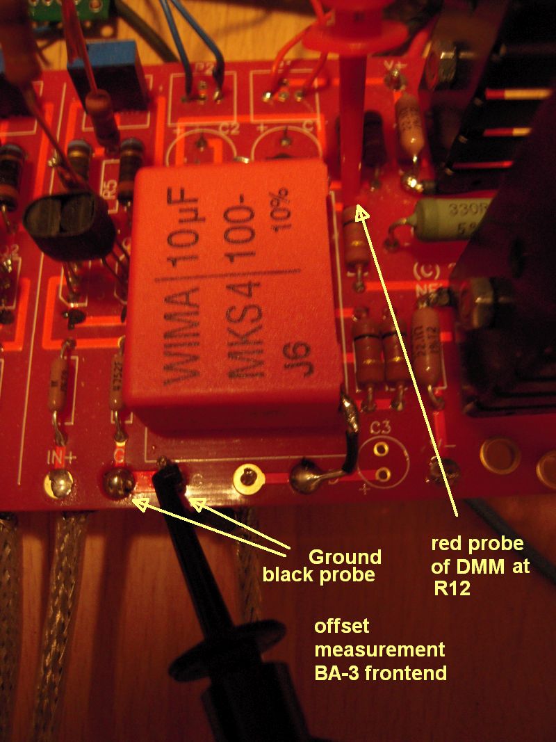

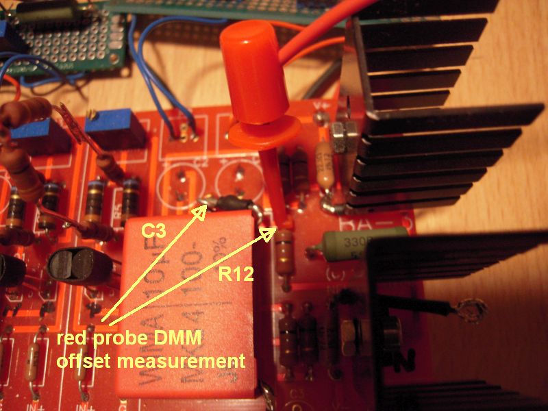

Offset measurement at BA-3FE
Hello BA-3-builders,
the following pics show, where I measure offset of the BA-3 frontend.
It doesn't matter if you put your red probe to the correct side of R12 or
of C3 - because they are directly connected by a trace on the pcb.
This PCB was used for a lot of testing - so it looks..... 🙄
The offset is fluctuating some mV around. This is a normal behaviour of this circuit. If you bias higher - give the Mosfets time to warm up a little bit.
But then it will be pretty stable.
You should easily get below 10mV offset - below 1mV is really good.
Greets
Dirk 😀

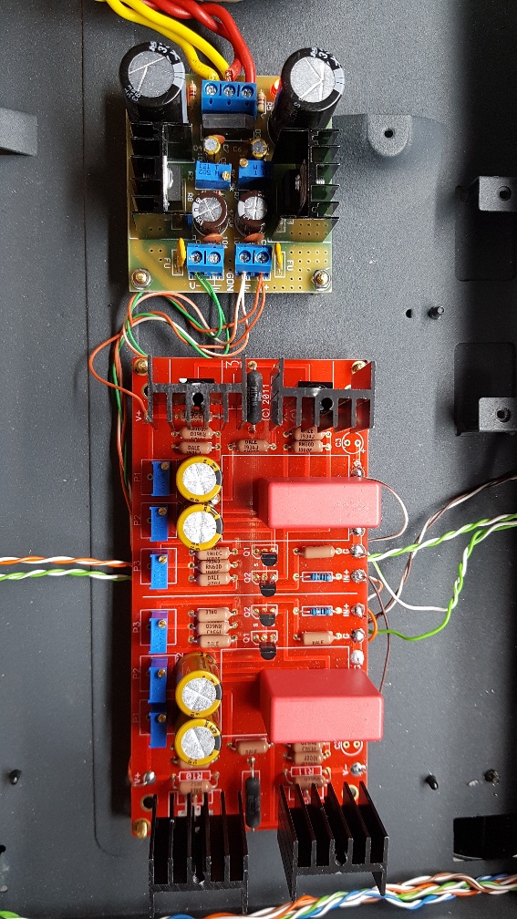

Really nice. Thanks! That is how I did it in the end. I have been thinking, and maybe my positioning of the R12 probe was unstable, or touched the MOSFET heatsink (though not conductive). Another fluke in the house now, so will check tomorrow.
Btw: you say higher bias means less and more stable offset. How high can you bias with those heatsinks? I have the same, wanna go to 1,25 volts, but uncertain if I should start with that or standard 1v.
Btw: did it help in any aignificant way tieing the JFETs together like that?

to andynor #453
Hello Andy,
as higher your bias as higher is the sensitivity of the offset (my experience).
I saw this behaviour especially at a bias voltage over R10 and R11 between
900mV and 1V.
Only minimal adjustments at P1 or P2 made a huge difference at the offset
( in the range of 900mV to 1v over R10/R11).
I got close to 950mV over R10/R11 but never biased higher. Heatsink temperature was not the problem. It was more runaway of my measured values.
The JFets are tied together with heatshrink to get a better thermal coupling
(between the N-channel- and P-channel- JFet). It can help to stabilize. But it doesn't make a big difference to me. I have made one board without the thermal coupling/heatshrink and it behaves very similar.
It gets better if your case / toplid is closed and no wind/airblows influence
the active devices ( good thermal equilibrium in the case).
Cheers
Dirk

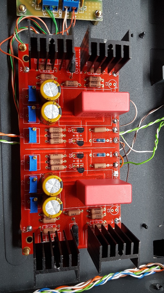

I built 3rd BA3 preamp for a friend. But this one has strong white noise on one channel. Couldn't find any miswiring, voltage problem or component mismatch.
Biasing fine for both channel, offset is acceptable. But somehow one channel has strong hissing sound.
Used linear systems jfets and fairchild fets.
Attached.
I accidentally replied to amp thread. Sorry about that.
I am no expert. And today I destroyed a bias PCB due to loosening a solder joint. But I would start by reflowing all solder joints where the solder has not flowed completely through. Especially on your JFETs. Also, rinse the board thoroughly to remove all flux, on both sides. Thats my two cents, awaiting Zen Mod to enlighten us all.
Attached.
is PSU common for both channels ?
improvise, or buy another pcb ( set)
I would improvise - waste to change entire populated pcb just because of few pads
