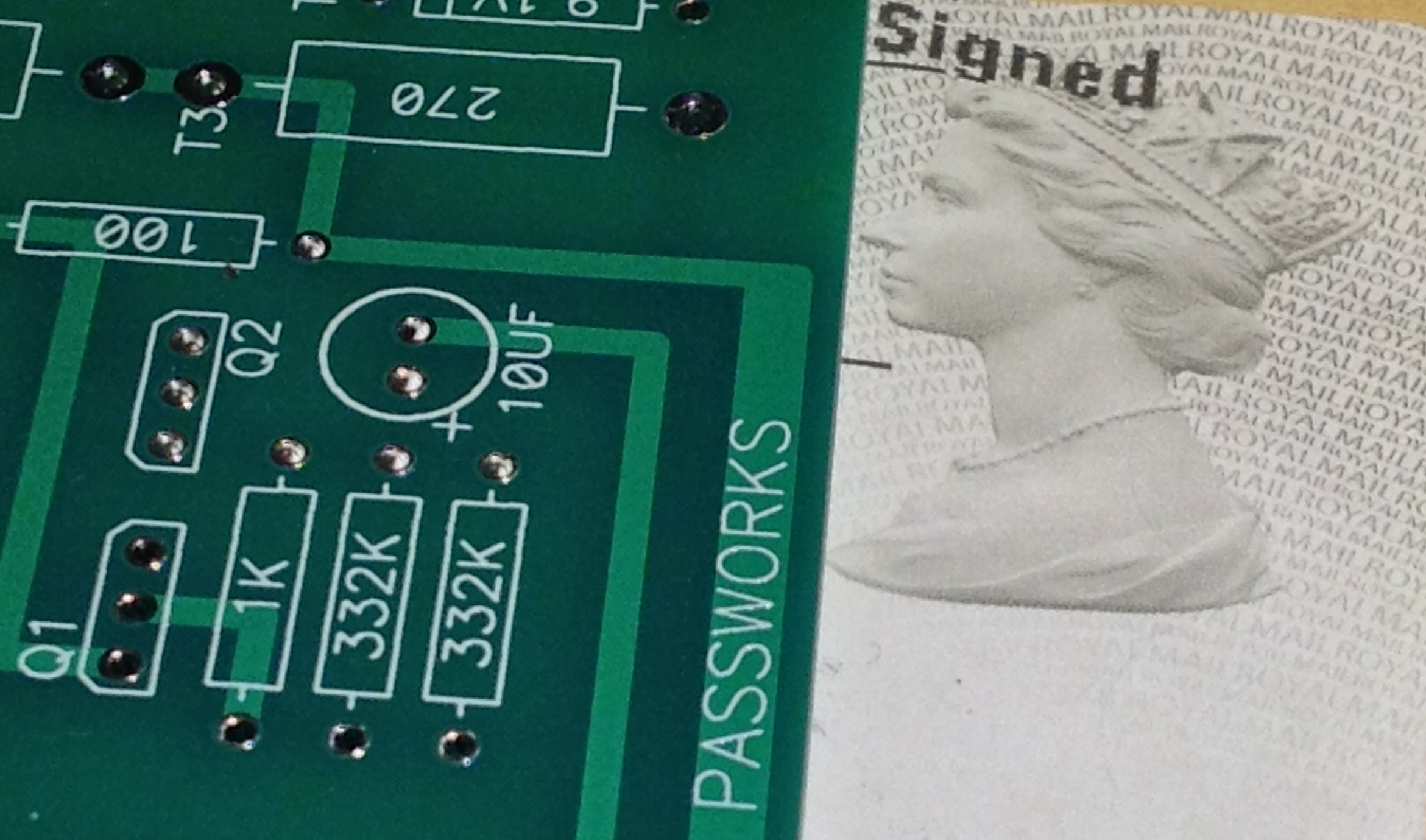

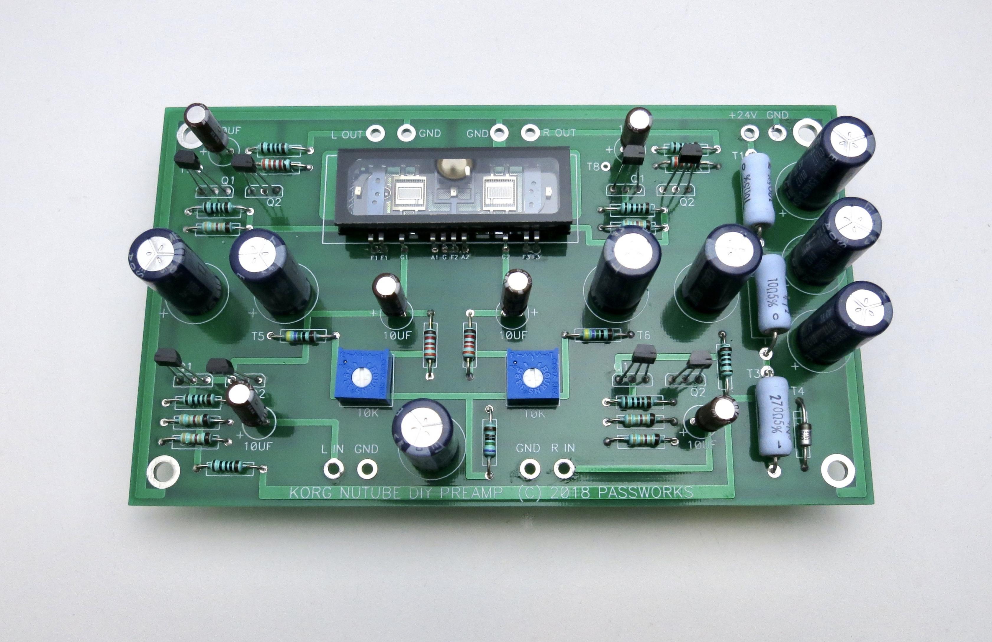

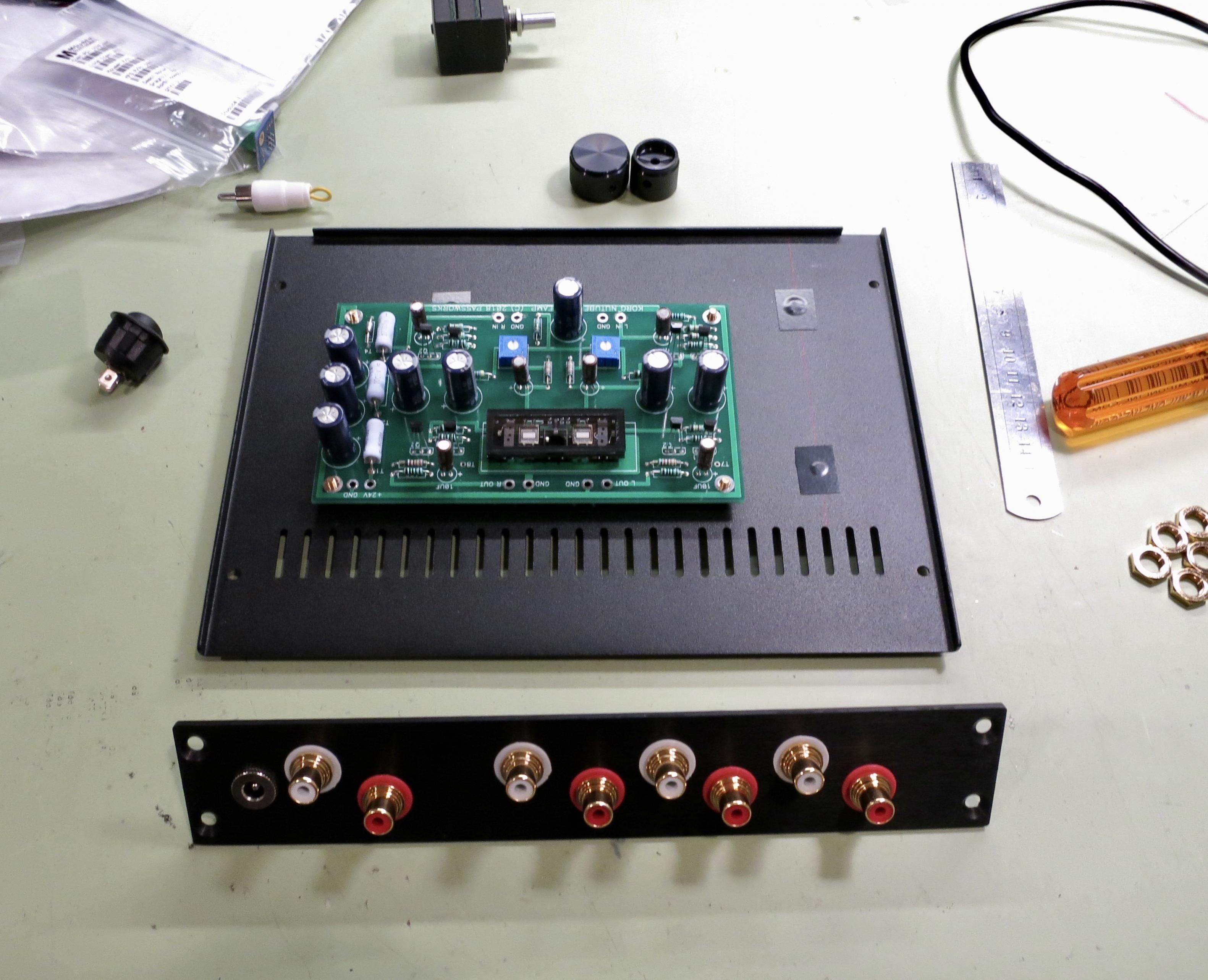

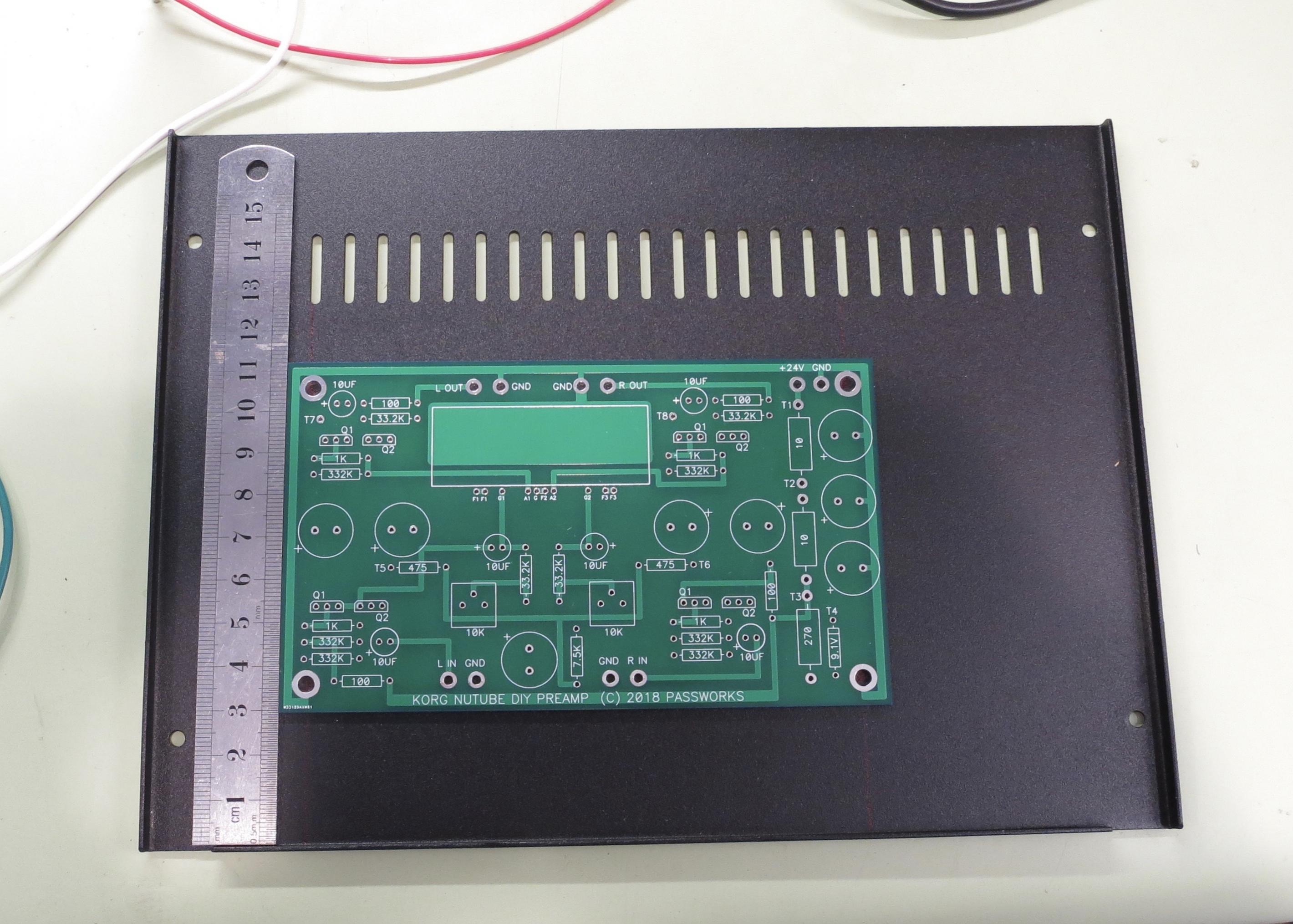

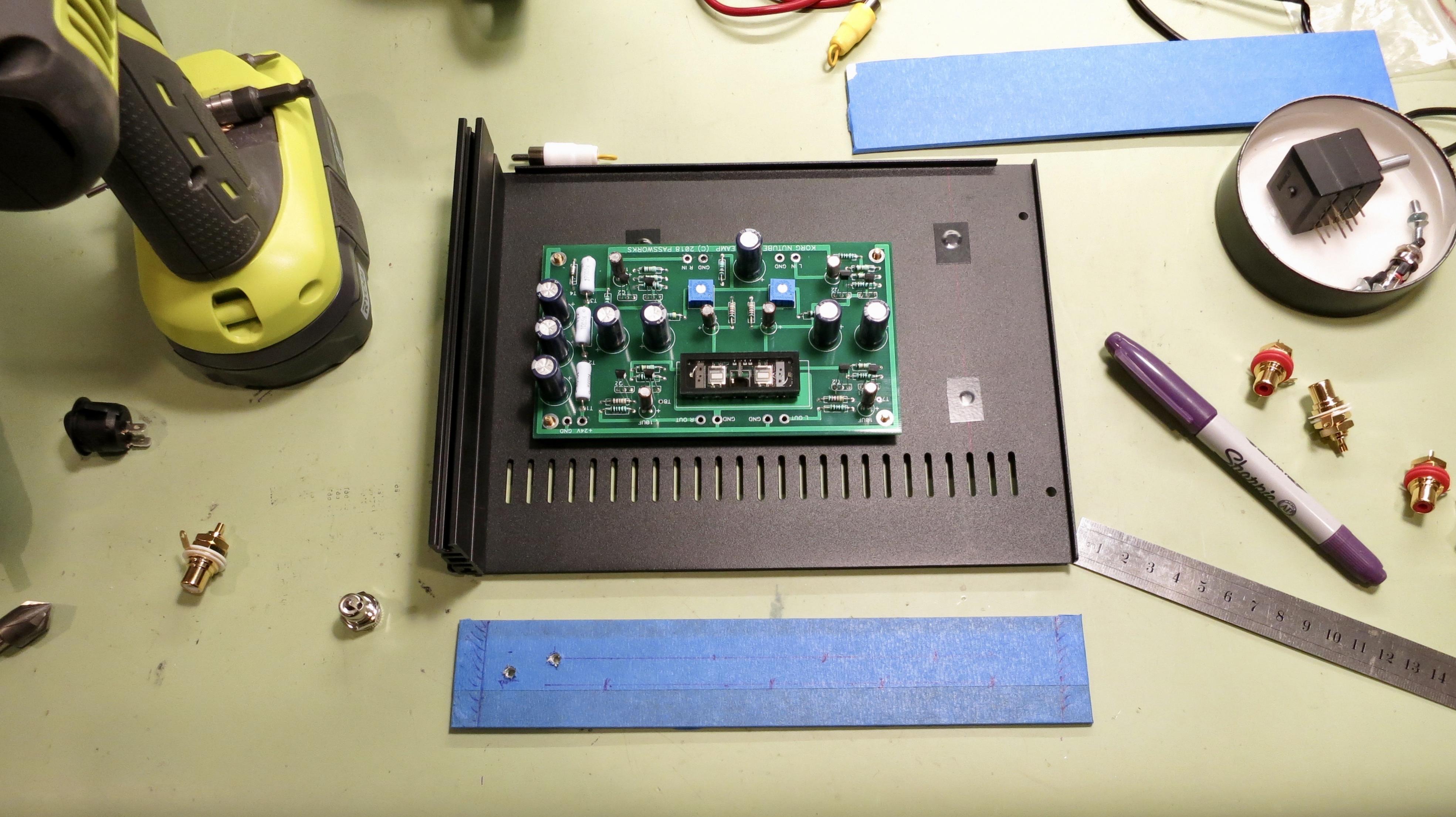

In a document none of you have read yet, but will soon, Papa said "As I write this he is putting one together..." And here are the first photos of that build. 😀
This is the CHRISTMAS version, put together in an evening by me using parts and pieces I had on hand. There will be a store version of the PCB that's just a touch different and most likely a full kit with a chassis. This is not the kit nor an official build guide.
Shown using a small 1U Galaxy chassis I had on the shelf, it's almost the perfect size. Galaxy 1U w/Steel Covers – diyAudio Store
The black pot is a long discontinued 50K Noble, the rotary switch a 3-position Grayhill. Other random bits from my coffee cans of parts. It's quiet, small, and sounds fantastic. This will be a very popular project, and you guys are on the leading edge.
I will have photo of the PCB being stuffed as well, although there's really nothing to it...
