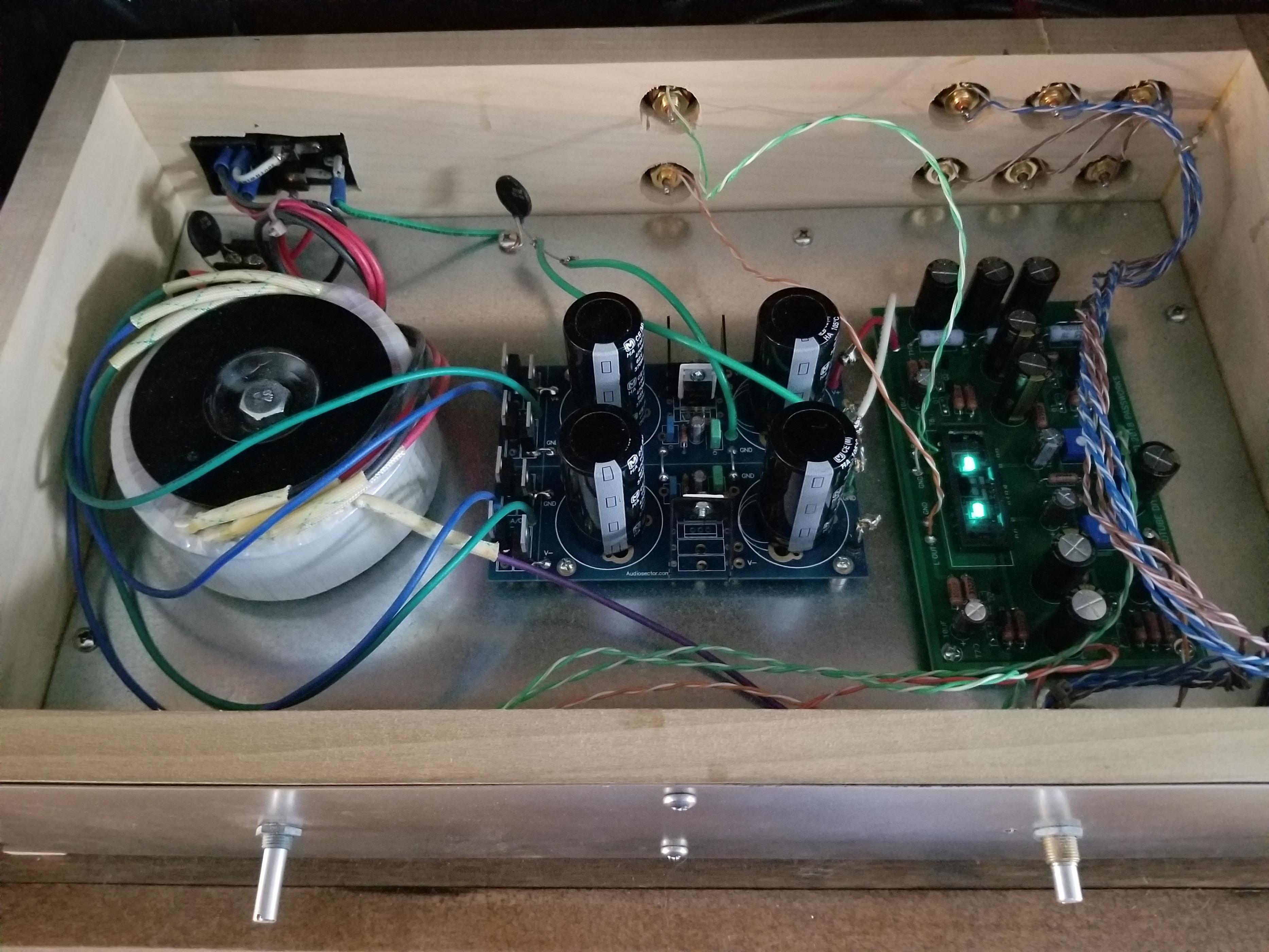

Oh. My. That sounds verrrrrrrrrrrrrry nice. I know I'll eventually want to run it through a distortion analyzer ( dont have one yet ), but I am more than happy with how it sounds now. And could be content with it as such for a very long time. Still more than enough gain with my vfet amp.
For the pics or it didn't happen crowd:

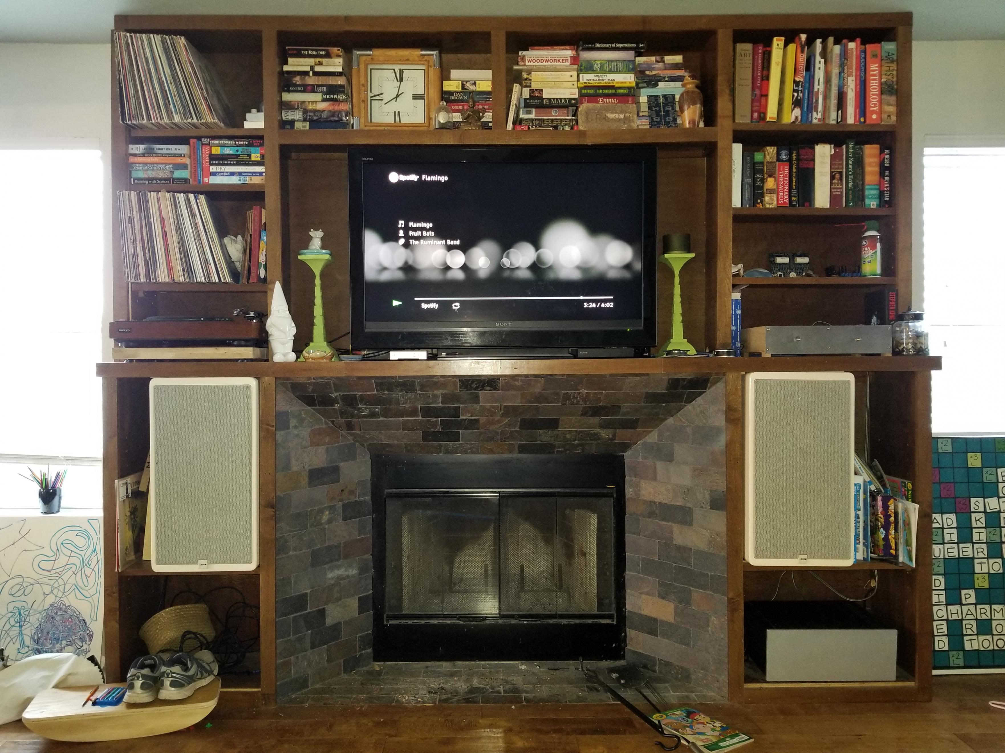

Could you tell us Some more About the sound? Soundstage, detail etc?

As for the sound...very detailed. Points of reference are a DCB1 and a BA3-FE. Given the many ways to build those, dial them in, and pair them up - I will not say better or worse. Too many variables. But I will say, in my system, it yields the detail of the DCB1 with the warmth of the BA3-FE. Which I like. A lot. My speakers are terribly positioned ( for bass response, at least ) but don't have any close walls to the side so tend to throw a good sound stage unless something is wrong. They're pulling the full disappearing act right now. As with all combos that dredge a lot of detail: GIGO. But throw it a nice track from a good source and you will be rewarded. Very.
Its also been playing cartoons half the day, with aplomb 😀

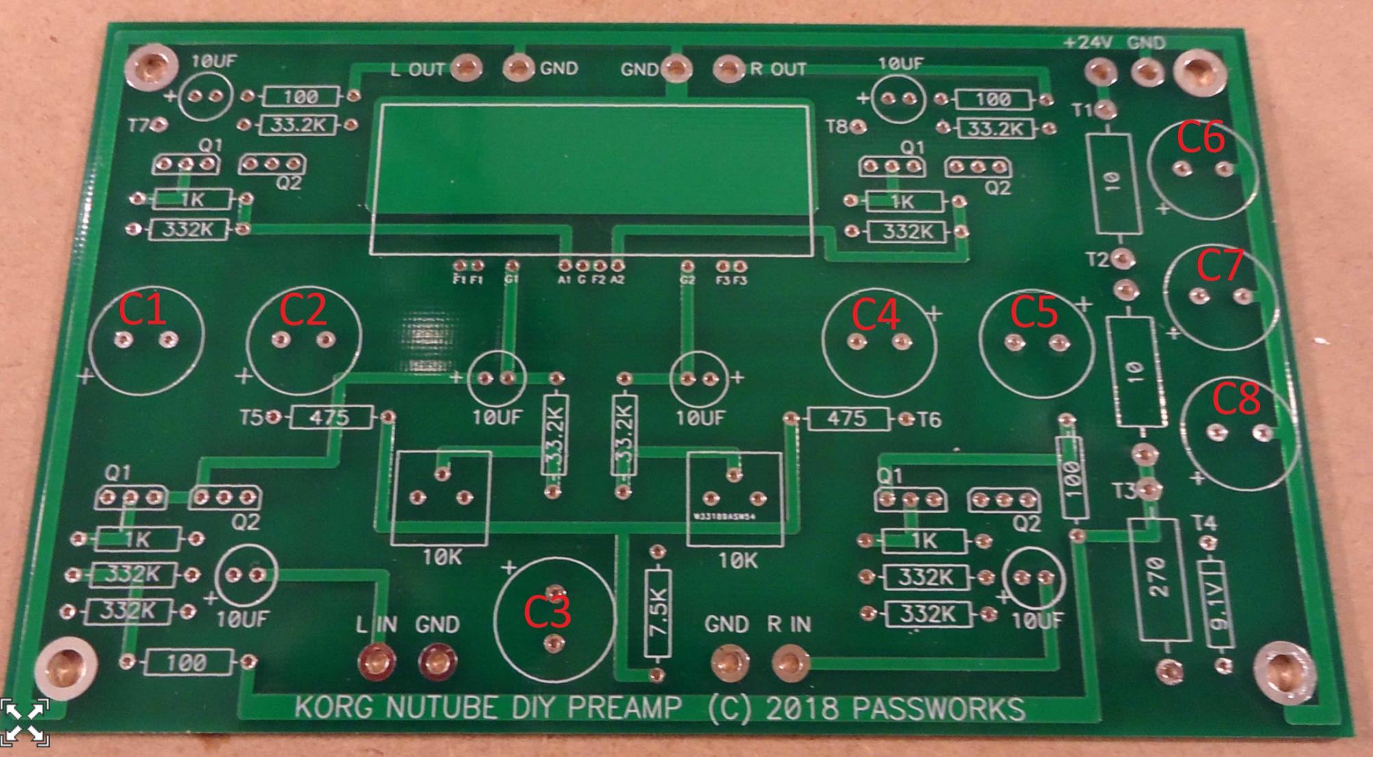

Need a bit of help,
I'm just about done stuffing the board but can't figure out the exact placement of the capacitors. I'm not smart enough yet to read the schematic....
Here is a picture with each capacitor labeled C1 to C8.
Can someone help me fill in the blanks or correct my mistakes?

The BOM's listed 4 2200 caps and 4 1000 caps so it has me thrown off.

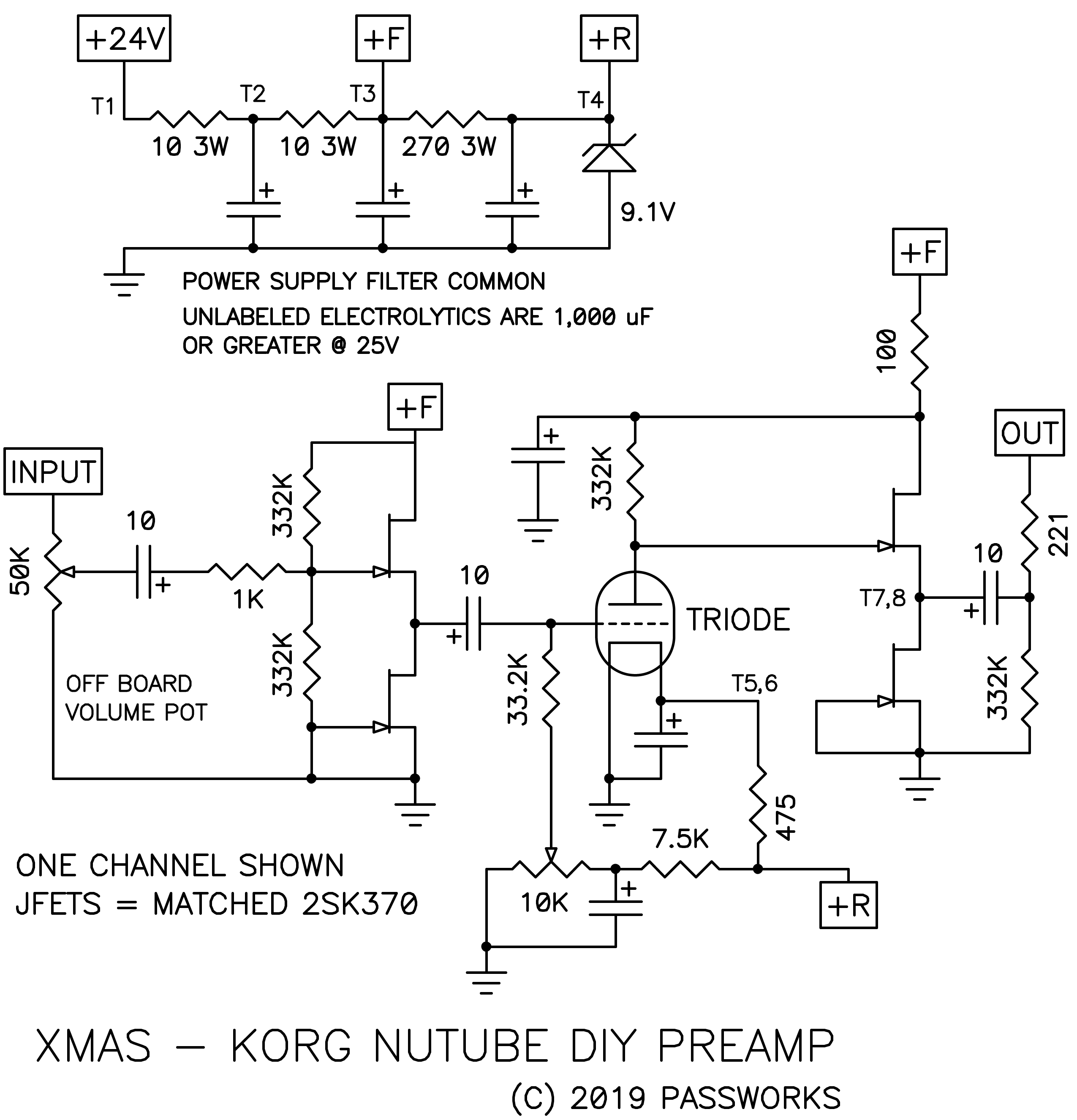

I believe NP's updated schematic stated that ALL those particular caps C1-8 on the Christmas board are 1000 microfarad, but larger values to 2200 for the C6-8 are OK. The original circuit diagram cited some 2200 caps, but the specs were modified for the newer board.
Regarding the 10uF output cap, if you hang this output to a power amp with 10 kOhms input impedance your -3dB will be 1.6 Hz. 10k will be dominant to the 221k or 332k output resistor to ground.

The first 10 ohm resistor in the filter should limit the inrush current to max. 2.4A for a 24V supply? …..then the 24V/5A Meanwell SMPS that replaced the smaller 19V supply should be able to handle the inrush even with 2200 uF caps?
Depends on the supply. Some of these appear to sample the load at lower voltage,
and if they see current presume that it will be lots more at higher voltage.
