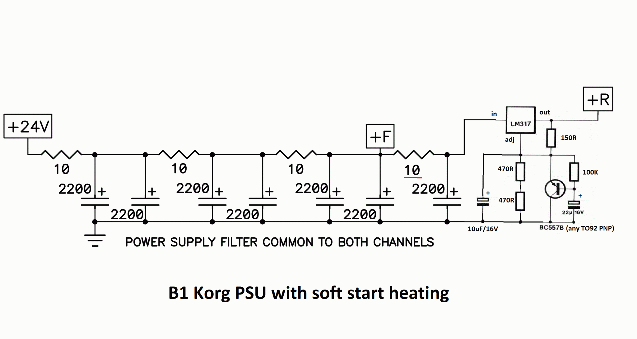

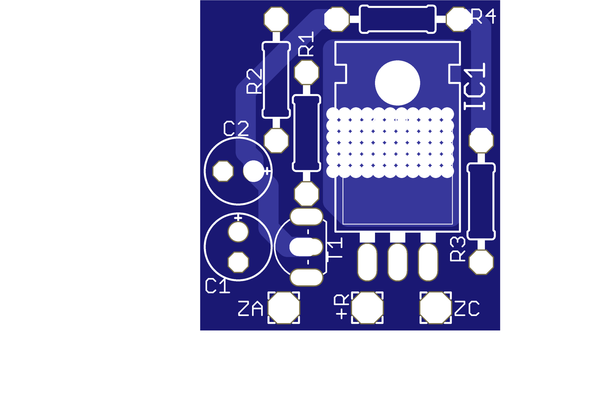

maaaaaaaybe worth trying, as last attempt of indulging puny blind DVD screen, is to introduce soft start heating circuit
Reactions: birdbox
Thanks ZM! I'm willing to try it out! I suspect no one has turned this schematic into a PCB yet to try out.
I'm taking a PCB design short course right now at a local community college. Im a comete noob at KiCaD. Is this something I can do for extra credit if it may benefit the Korg B1 diyaudio community? I'm willing to give it a try. I don't mind screwing up and having everyone tell me where I went wrong.
Edit: Since the failures seem to happen while the preamp is left on, does a "soft start" provide protection both for warm up and long term running?
if you're married, you know that question as that only your wife can answer
:rofl:
I reckon Papa's solution with zener is reg stable enough and precise enough; though, as old saying goes - Bad Rooster is obstructed even with a Feather ....... so, if Korg tube is destined to go poof, there is no protection from that
besides soft start and then voltage stability, one can't do more

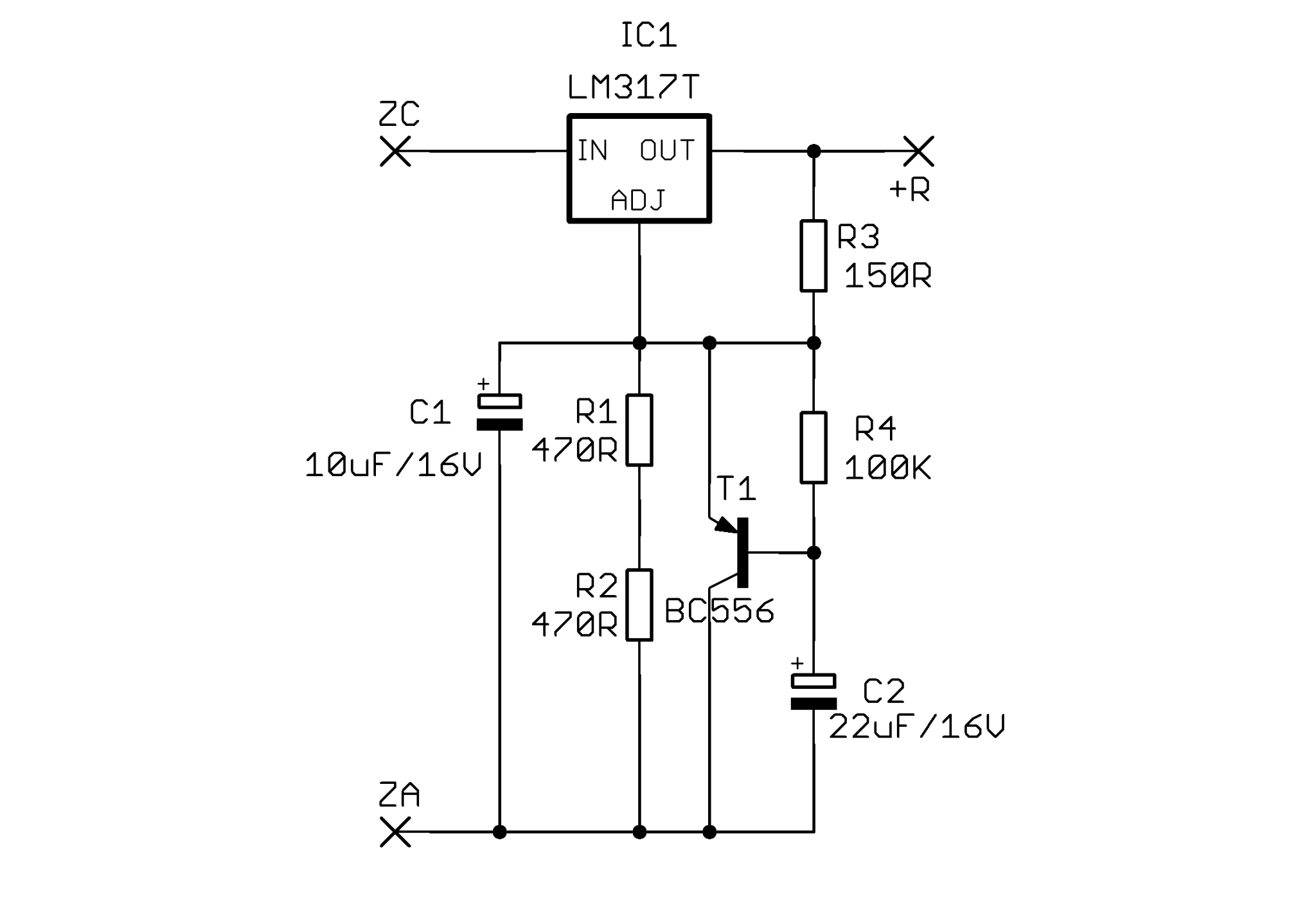

said circuit with LM317 can be made on small veroboard, as two-pin thingie and can be inserted in place of zeners...... so no need for main pcb change at all
edit - just tiny xacto knife hoorah! on original pcb should be needed, to isolate present zener cathode trace from +R output trace

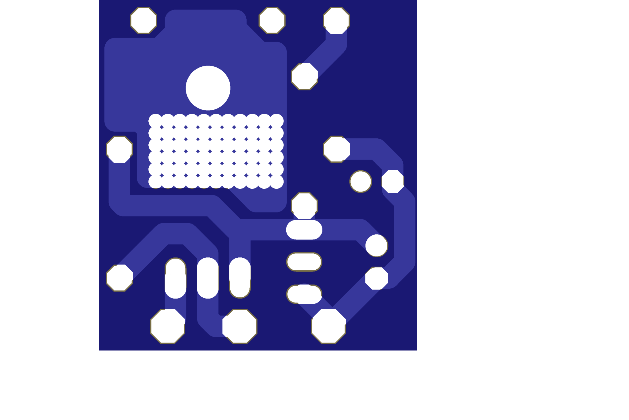

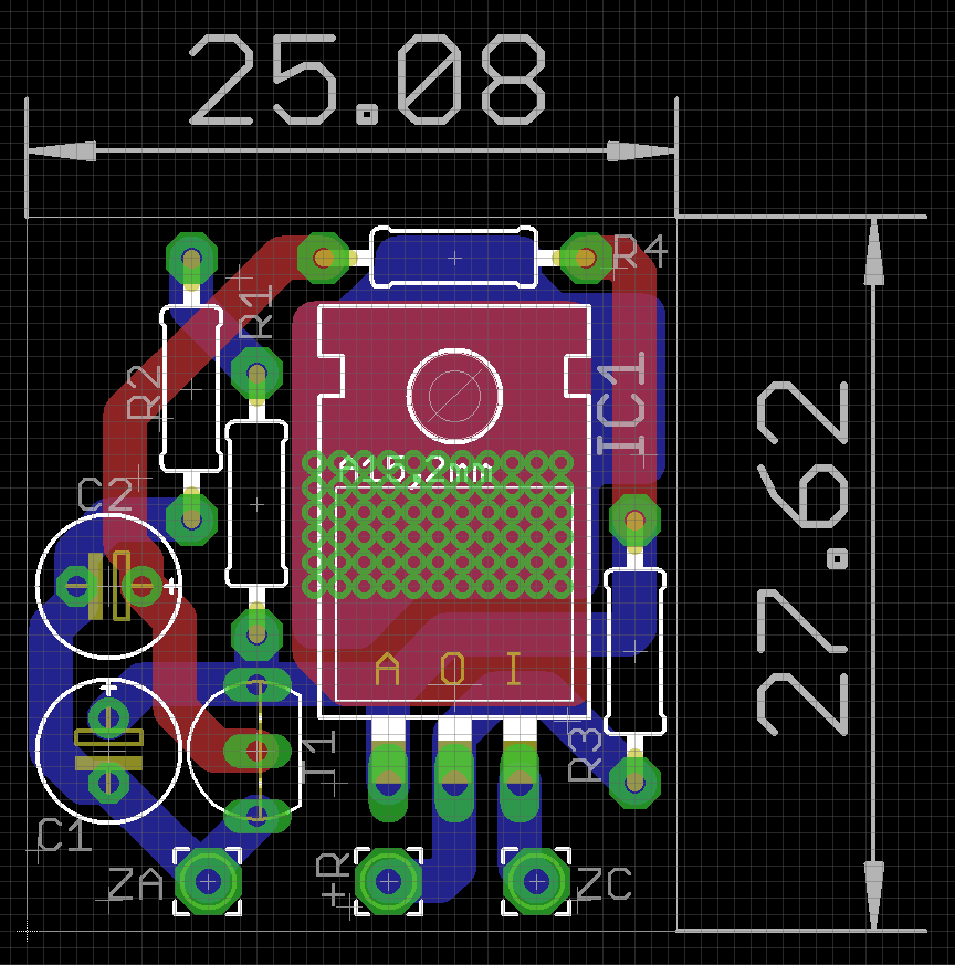

implementation is easypeasy
this, fast and dirty; it can be made nicer, but must zzzzzz

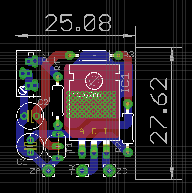

  • Gerbers softheat.zip

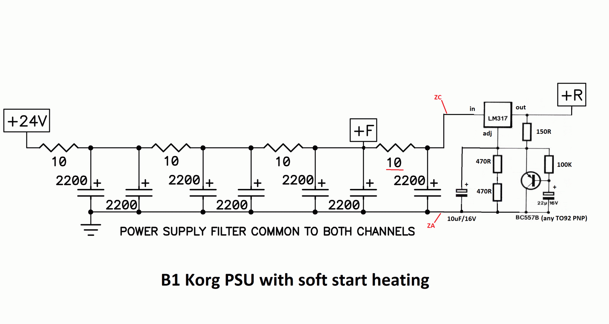

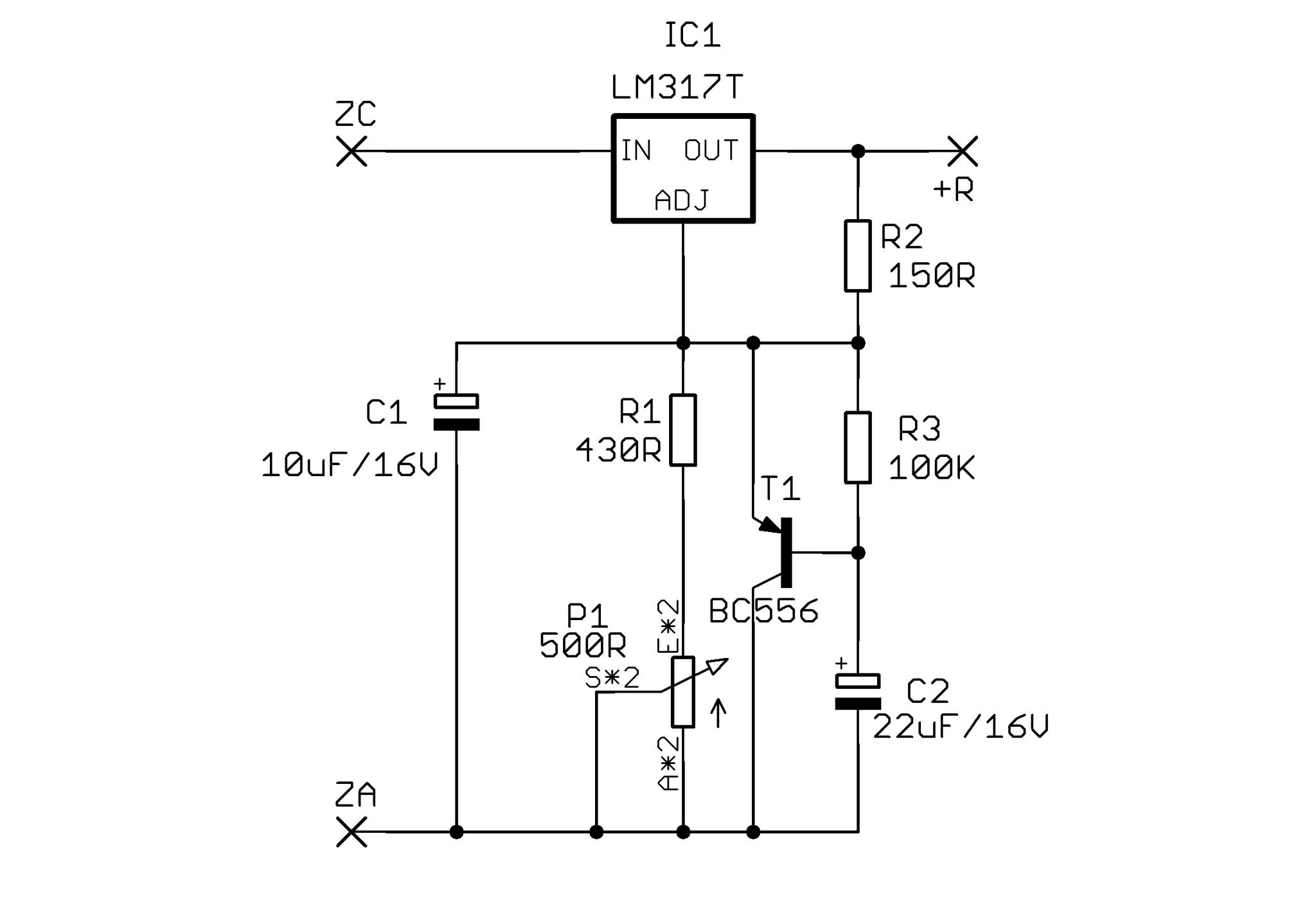

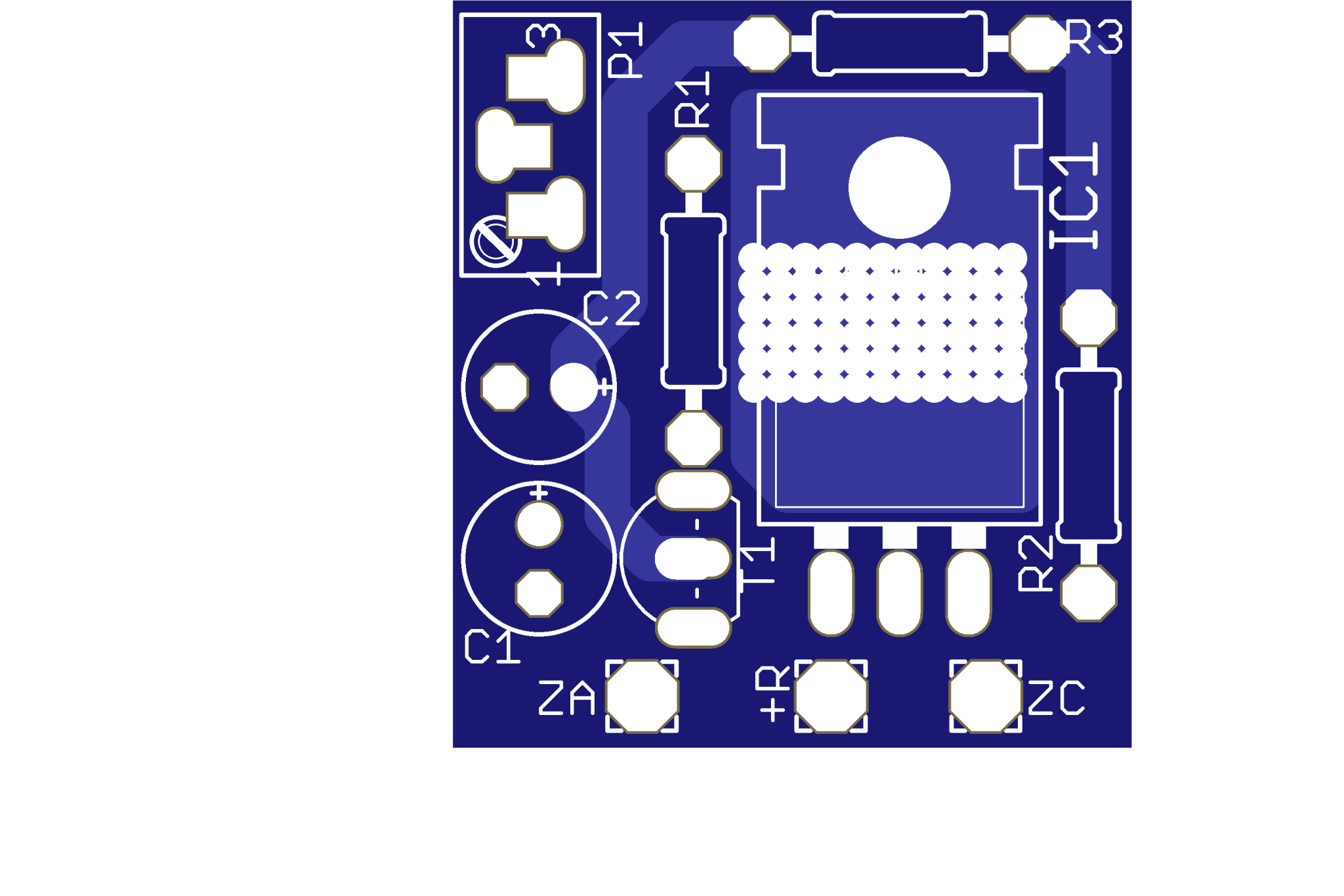

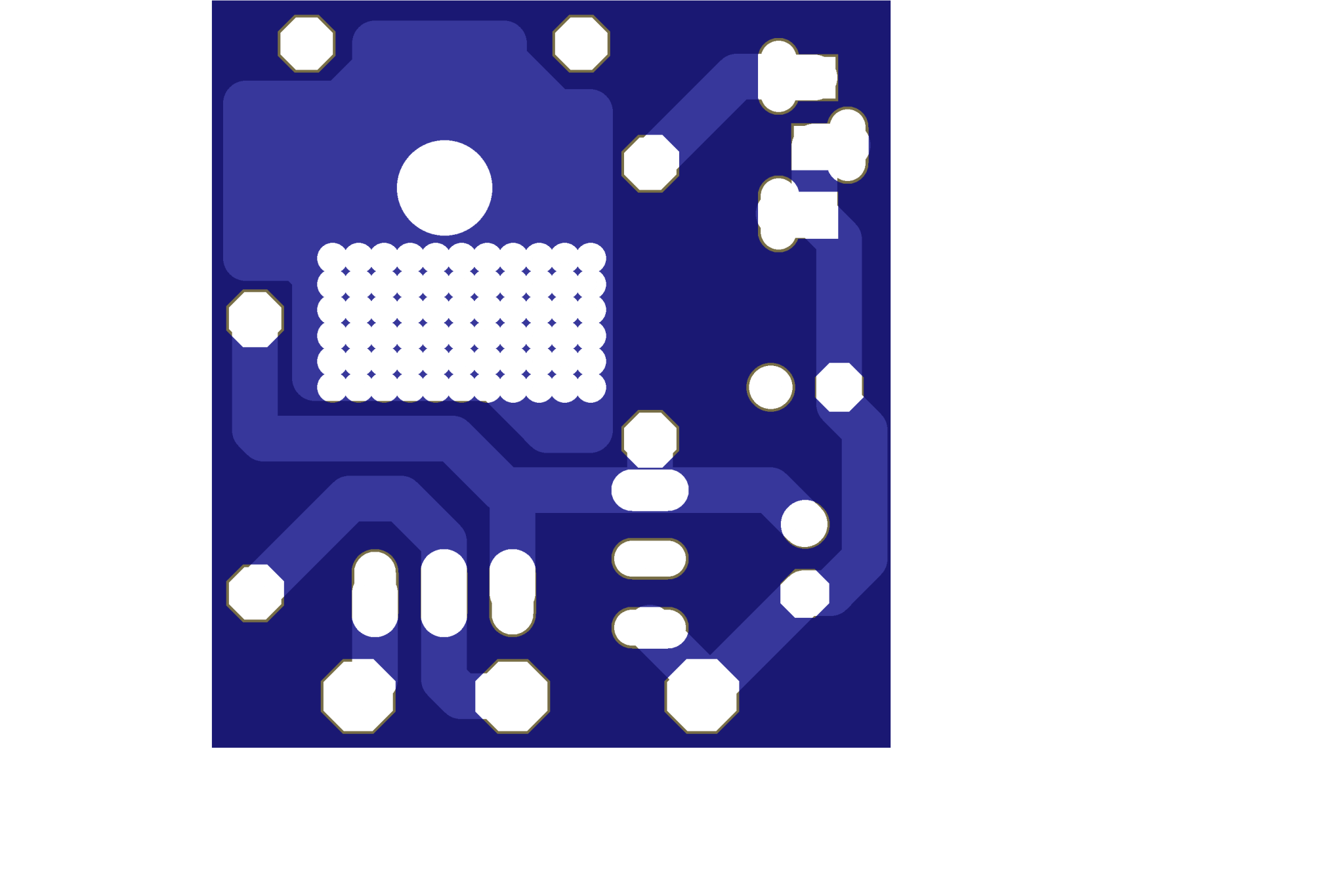

here it is, adjustable
monitor voltage at heaters (as Ben said 700mV is magic figure!!), twiddledee with trimpot to get it exact, et voila!
voltage with zener substitution is adjustable from 9V0 to 4V83
if R1 is 750R and P1 is 200R, then voltage span is lesser (finer twiddledee), from 9V16 to 7V5
do not forget that is necessary to cut +R trace at appropriate place on original pcb and then fed output side of it from +R pad on small pcb

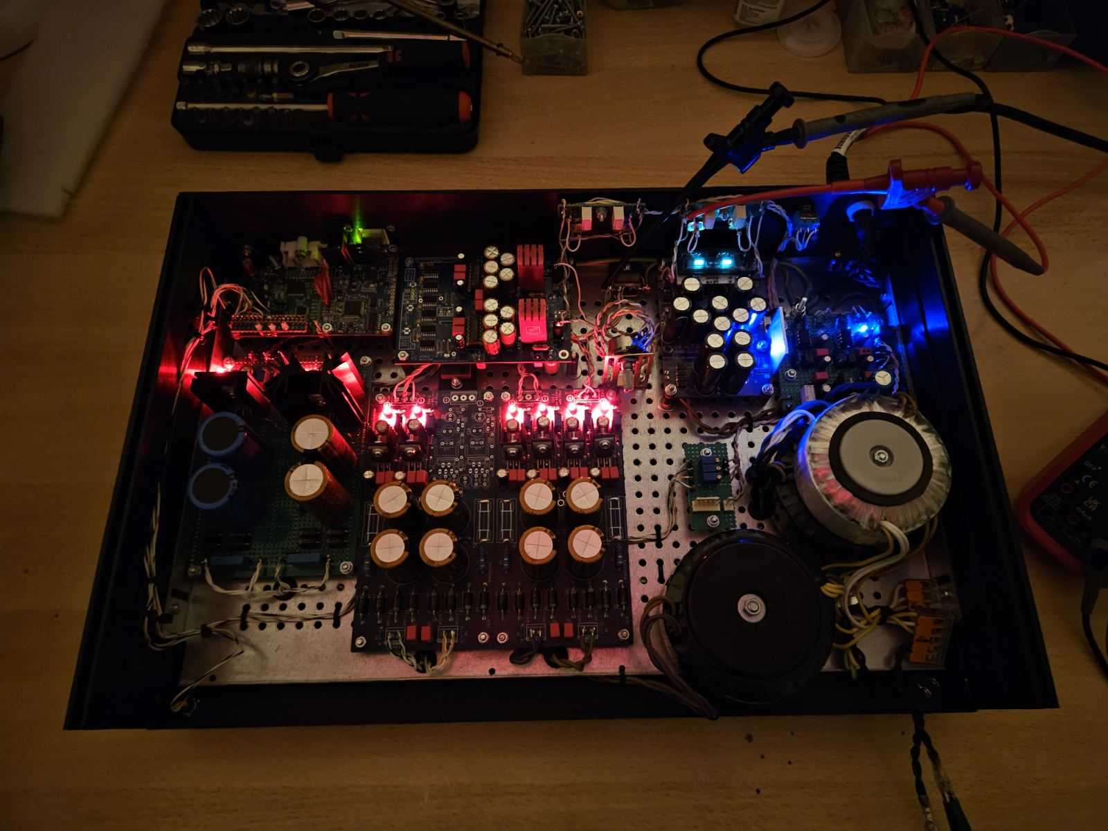

@ClaudeG linear smd b1k nutube is implemented in my friends dac.
First remark, when someone farts in the movie you can smell it 🤣
Music wise, there are more noticable details which weren't heard before, more refined sound, and 3d stage is much clearer now.
General conclusion, audibly better than with smps. Which is a nice improvement since the smd design sounds a lot better than default one.
I have one more idea in mind, which i currently don't have time to design. But in general even smaller board, without post supply crcrc and passive drop, all tps7a4701 regulated close to load. Which should bring this to another level, but at that point it couldn't be called b1k nutube. This was done as homage to pops.
