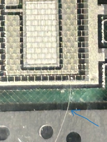

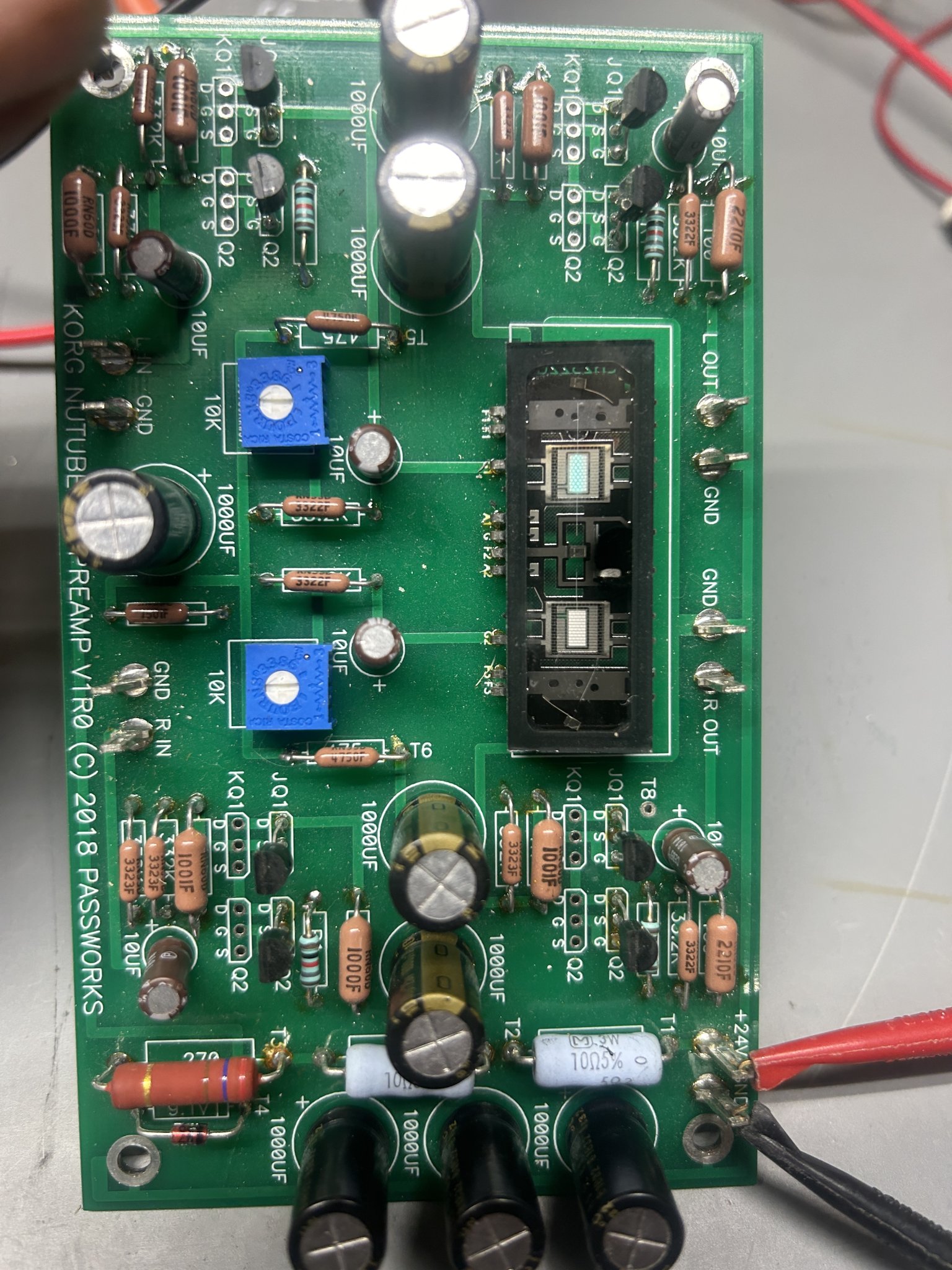

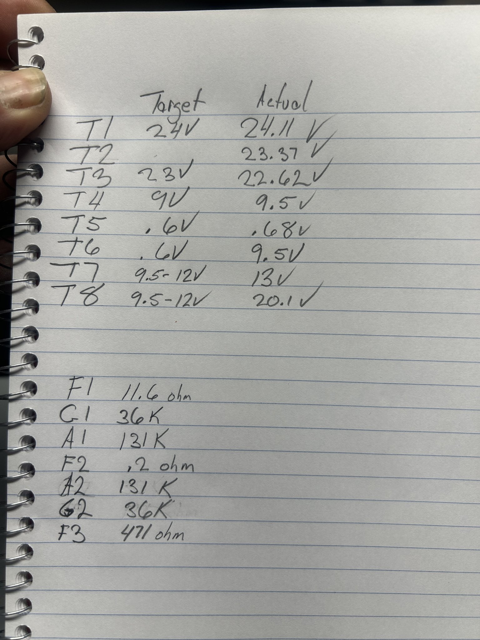

I’ve had a failure in one side of the Nutube 6P1. The B1 w/ Korg has worked fine for years, then nothing on the one channel after startup. I pulled the board, and other than the one filament not glowing everything looks fine. I have the board connected to a lab supply and I have taken voltage measurements at T1-8. I also took resistance measurements at the tube pins. I’ve order a new 6P1 from the store, but need to be sure it’s safe to just solder in place. My brother has been using this preamp for the past couple years and it has NOT been left on 24/7. Measurements are attached as well as a pic of the board. Thanks for your help! Please take note of the voltage at T-6 and T8, and the resistance at pin F3.
Trim pots were set to halfway point for voltage measurements.
The power supply voltages are in the ballpark. 9.5V at T4 is within tolerance but a bit high. That is the filament supply voltage so a bit high does stress the filament a bit. However the left channel filament voltage T5 at 0.68V is within specification (Korg specified Min 0.6V Typ 0.7V Max 0.8V).

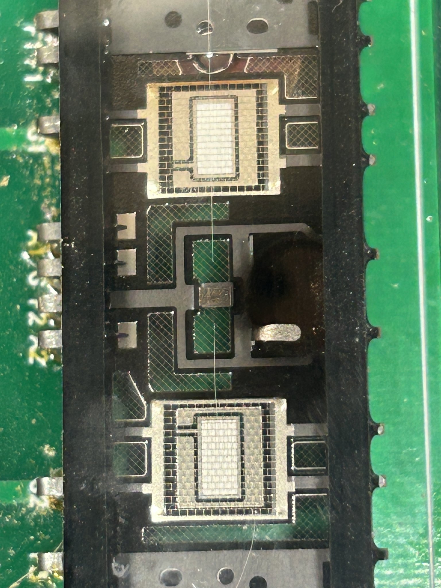

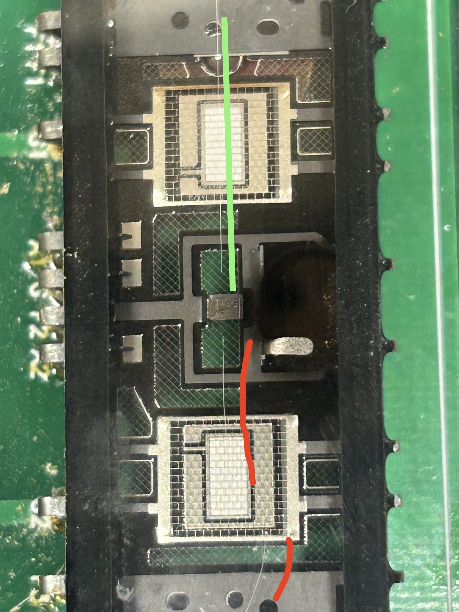

The rest of the voltages indicate a filament issue with the right channel of the Nutube. There was no measured current through it. However the filament resistance measured 471 Ohm, not infinite resistance. Does the right channel filament appear broken (discontinuous)? If so then it is no good. Do the solder joints look good? Try redoing the right channel filament solder joints. If that does not have any effect, then the filament is probably toast, and replacement is needed.
So the voltages appear within specification and installation of a new Nutube should be ok. Since you have a lab power supply, use it to bring the voltage up while monitoring the voltage at T5 and T6, which should not go higher than 0.8V (0.6V to 0.7V preferred).

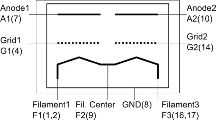

that's directly heated tube, where heater is also serving as Cathode
so, if filament is broken, no heated Cathode and no electron emission
