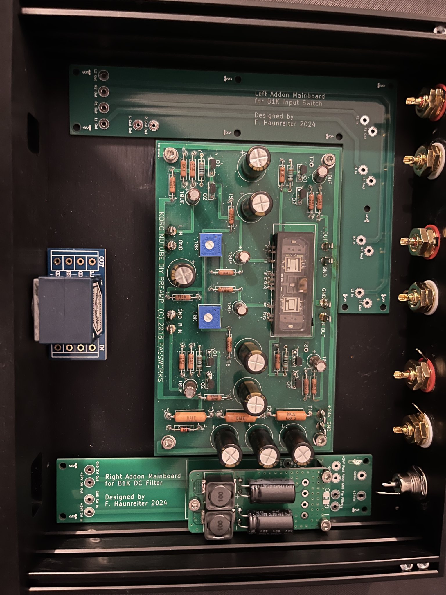

I hate cable routing. Thats, in my opinion one of the most annoying thing in DIY. Thats why I lay out 2 simple addon boards. The right board carrying the slim version of AmyAlice, filters DC, routes it to front where it can be connected to On / Off switch, then it will be routed back where it can be wired with short wires to B1K Board.
Left Mainboard is simpler. Its just the L-shaped board, all inputs can be accomodated here while on front layer, the signal layers run in parallel to input switch, on back layer, common grounds for left and right channels are routed to the front. I like it clean 🙄
My main idea in designing these two helper boards was to use up the space within the "official DIYAUDIO case" from Modushop and minimize cable salad routed through it.
Added some explanation @ItsAllInMyHead ;-)
Sadly I couldnt wait and thats why the right board has some small hickup. The lower of the 3 holes carrying SlimAlice is about 1mm too close, so the spacer is no absolute perfect fit. Kinda annoys me, but I only had gerbers of the DC Filter and had to measure from them in gerber viewer. Maybe I will do a rework, cause I hate this imperfection. (in the end absolutely no one will see it, but i know it 🤣)

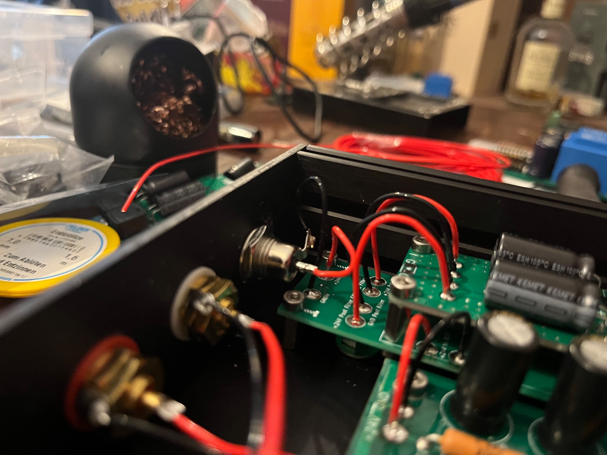

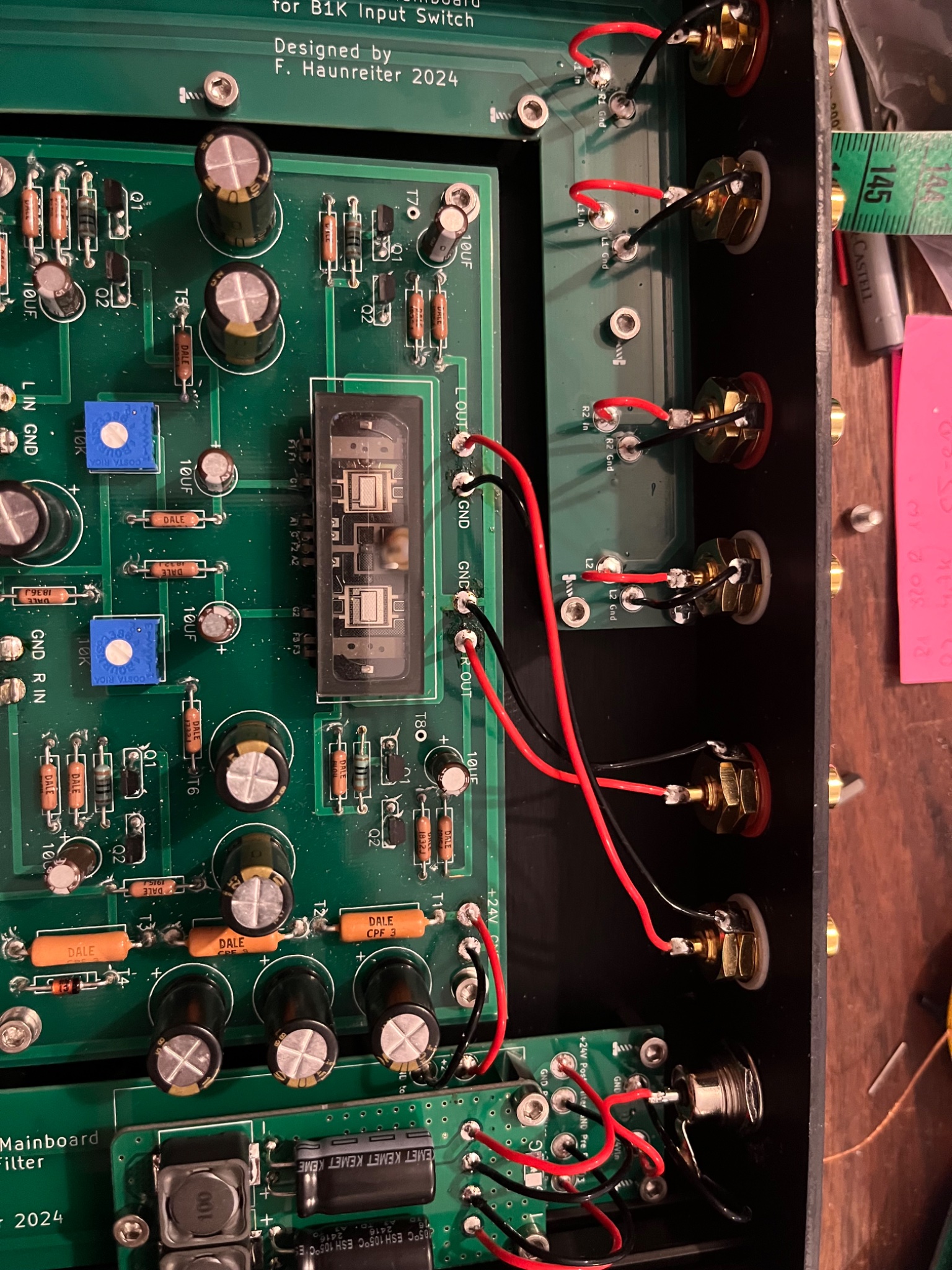

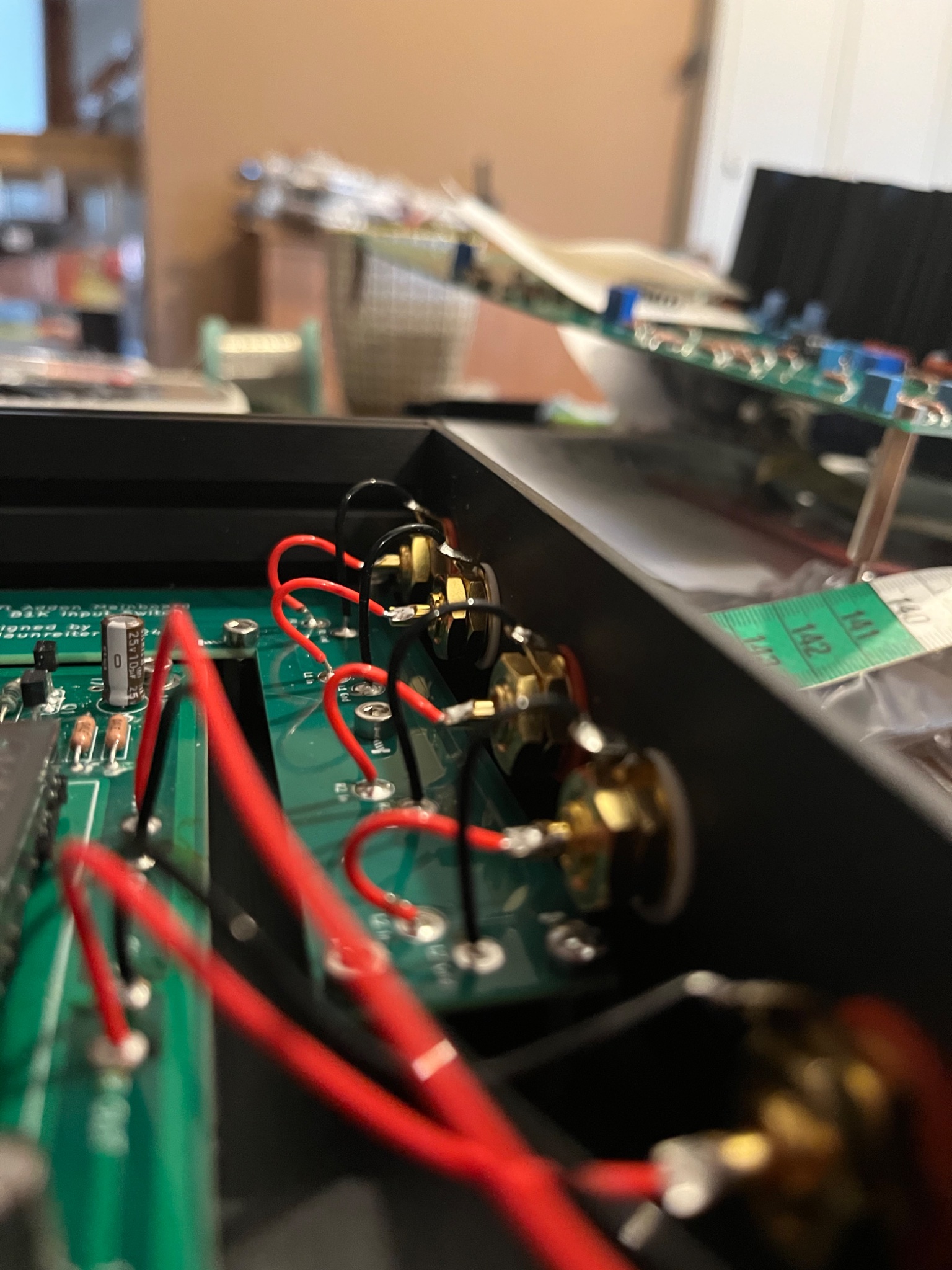

Continue building it into the case. As planned, solid core silver cables. AmyAlice (thanks for that @Mark Johnson ) foes a perfect job. Completely got rid of wall wart ringing. Test setup is rock silent. Now waiting for the switches to do the final front panel wiring.
If anyone would like to have the gerbers for the Addon boards I can share them for free ofc.
