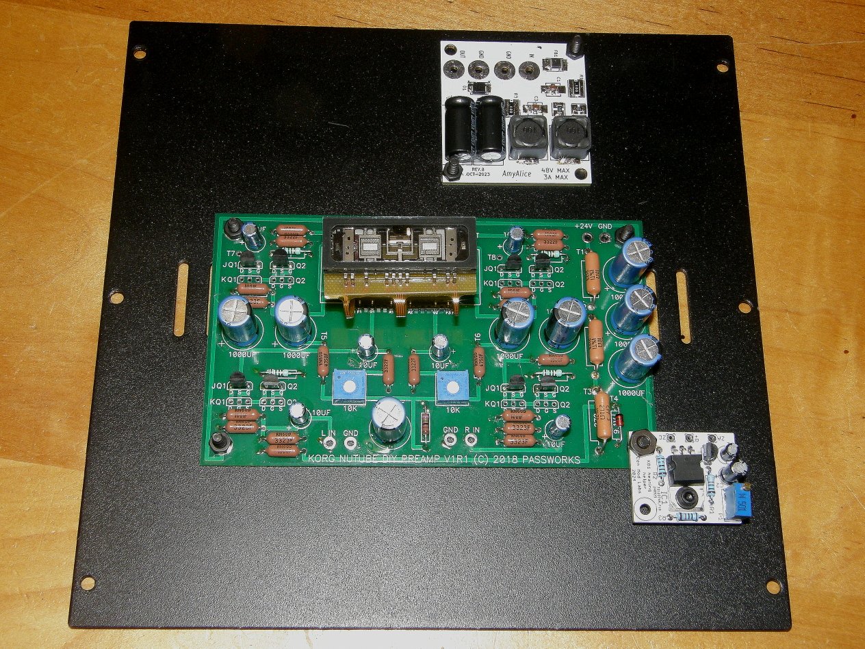

Did a little drilling and mounting scheme for boards. Soft heat is hanging on there. What do you think of the arrangement? :> Now all I have to do is figure out the Soft Heat wiring. Hint hint
Yah, I remember that now. Thanks for the reminder. I am tempted to do a couple of upgrades to the circuit but let's see how this goes first.
Ok, guys between Zen Mod, Birdbox and the powers that be, there is a simple to understand drawing of the implementation of the Soft Heat board. I for one am very appreciative of the effort made for our sake. Maybe I will even post a photo. In my world it isn't just the wiring but an additional attempt to make it look good as well. Not as easy as it looks sometimes.

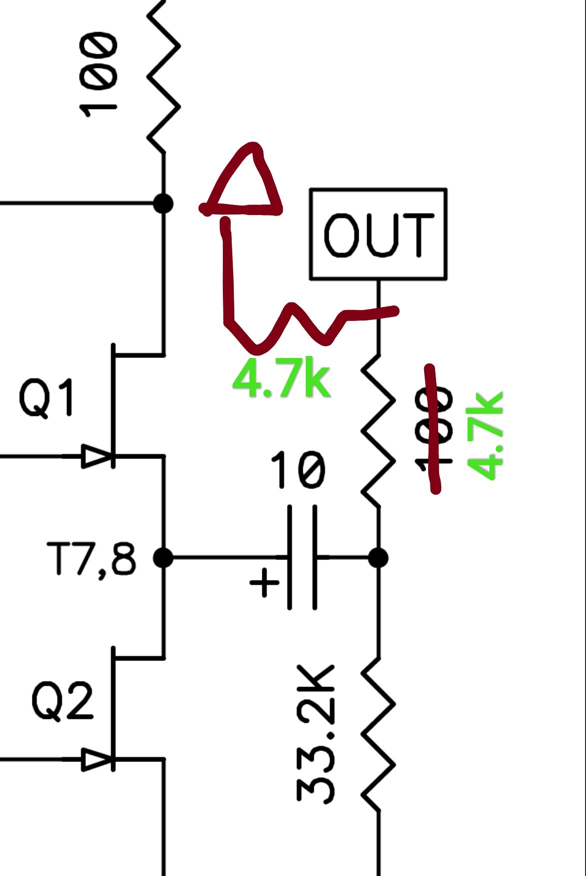

@Brijac can you please make a quick drawing of the mods that attenuated the hiss on your board? I'm having the same issues, sound is good, no hum or buzz with the ground loop breaker for test, just hiss that can be heard like a meter away from the speakers. It does not increase with pot all the way up. Voltages are good and I've disconnected all other boards just to keep this issue minimized to one part.
You have to check the gain structure in your chain. Mine was easy, purifi amps have a FE bypass, so i removed around 14db and it reduced it a lot (b1k nutube is buffered so it can drive it). And as i use custom dac, i just reduced output vrms and it was silent.
You may have other issues, but it's what solved mine, and if you have a way of reducing gain in your chain it would be a good start.
You can try reducing the gain of the nutube this way, but you will have increased output impedance to around 2.4k, and the gain reduced will be by around 6db (sorry for my horrid finger drawing on phone). Simple voltage divider with two 4.7k resistors.
