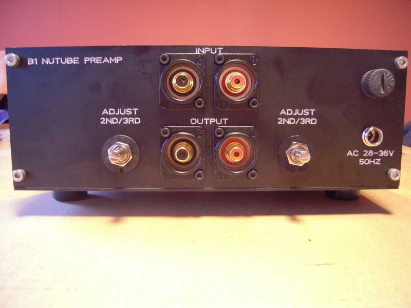

B1 with Korg Triode
...so I'm considering using a single dual-gang pot to adjust bias without dissasembling the unit and perhaps even set it differently depending on what music I'm listening to... Are there any reasons (sonic? or other) to avoid a single pot or perhaps to do this even with separate pots?
pics...

Thank you all for answers regarding the common dual-gang pot.

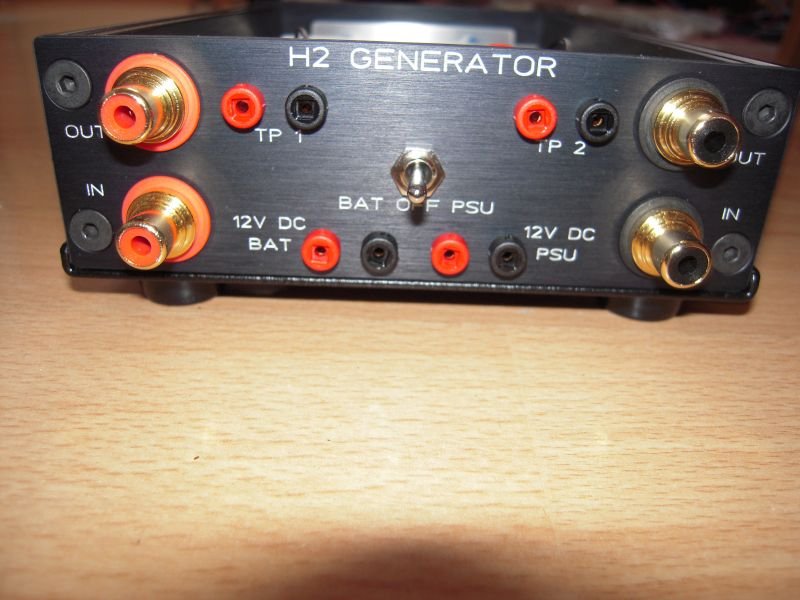

Cubicincher, I assume your testpoints are made to ensure the (separate) external adjustments are yielding equal results per channel.
But if I understand Dad's ;-) suggestion right, the internal pots could be kept to adjust "balance" and then subsequent variation made with the central dualgang.
Thus, if the pot is dual-gang, do I, as an embryonic nerd, still need the testpoints?
Hello rokikiki,
my experience is: once you have found your 'adjustment to your preferred sound' you will not turn the pots anymore.
Only if you change an poweramp, speaker,...
It was an idea I realized for me - easier access without removing top lid. But absolutely not necessary to become happy
with the B1 NUTUBE-pre.
Cheers
Dirk
