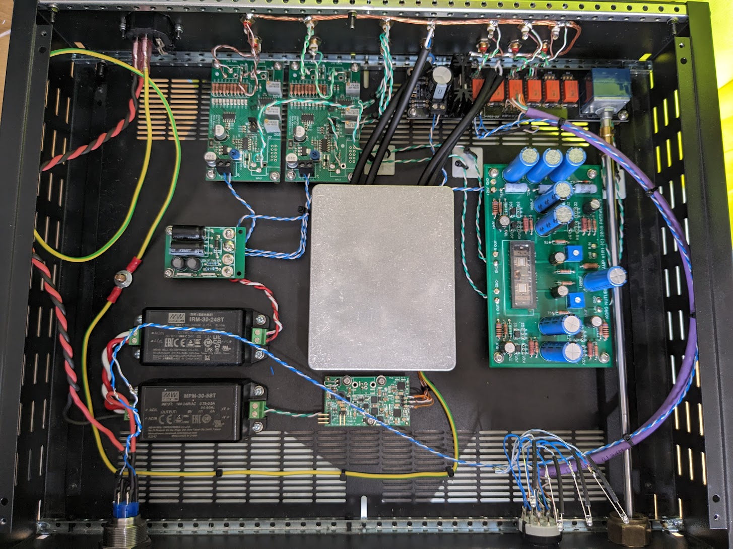

Bulit another Korg B1 that uses 2200uF power caps and WIMA poly bypass caps on the underside of things (the bypass caps worked on the last build just fine).
This one's built into a pre with a Salas I-select, some Xkitz crossovers and an ESP P-06 phono pre + P-99 subsonic filter. All power is switchmode (the phono stage gets a silentswitcher, there's a filter on the 24V rail too).
(Without judging my wiring which isn't finished) - just powered it up for a check, when flicking the selector switch the nutube 'flares up' (lights temporarily). Is this normal? Acceptable?

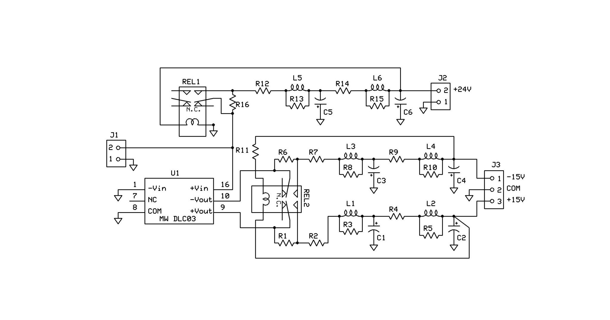

Using larger capacitance can throw smps in protection mode (i've not tried that meanwell, rs works fine with large caps though). Which may be the case here. Just in case, power b1k with just direct 24vdc, no filter, no anything on that supply, just b1k, to avoid additional cap reserves along the way.
Thank you - I'll try that tomorrow. I'd taken a look to see if there was a supply rail dip when switching and nothing came up, though response on the multimeter is slow.
Yup, ran into that problem with my B1K which includes three of Mark's PO89ZB filters -- for the 24V and two more for the Meanwell smps +/-15V dc-dc converter in my chassis which adds up to a lot of capacitance when you also include the B1K's filter caps. The symptom was the 'power on' LED would turn on, then off, then back on whenever I applied power to the chassis.Using larger capacitance can throw smps in protection mode (i've not tried that meanwell, rs works fine with large caps though). Which may be the case here. Just in case, power b1k with just direct 24vdc, no filter, no anything on that supply, just b1k, to avoid additional cap reserves along the way.
My solution was to install current-limiting resistors which, when voltages rose adequately, are bypassed by relays. I used 24V mini relays (2 amp contacts) which have a must-operate voltage around 17 volts. I use one relay directly across the 24V line and a second relay for the 15V lines with R11 to compensate for the total 30V across the second relay.
