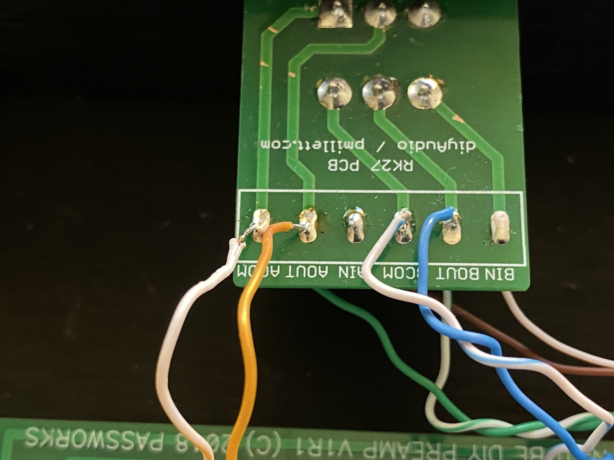

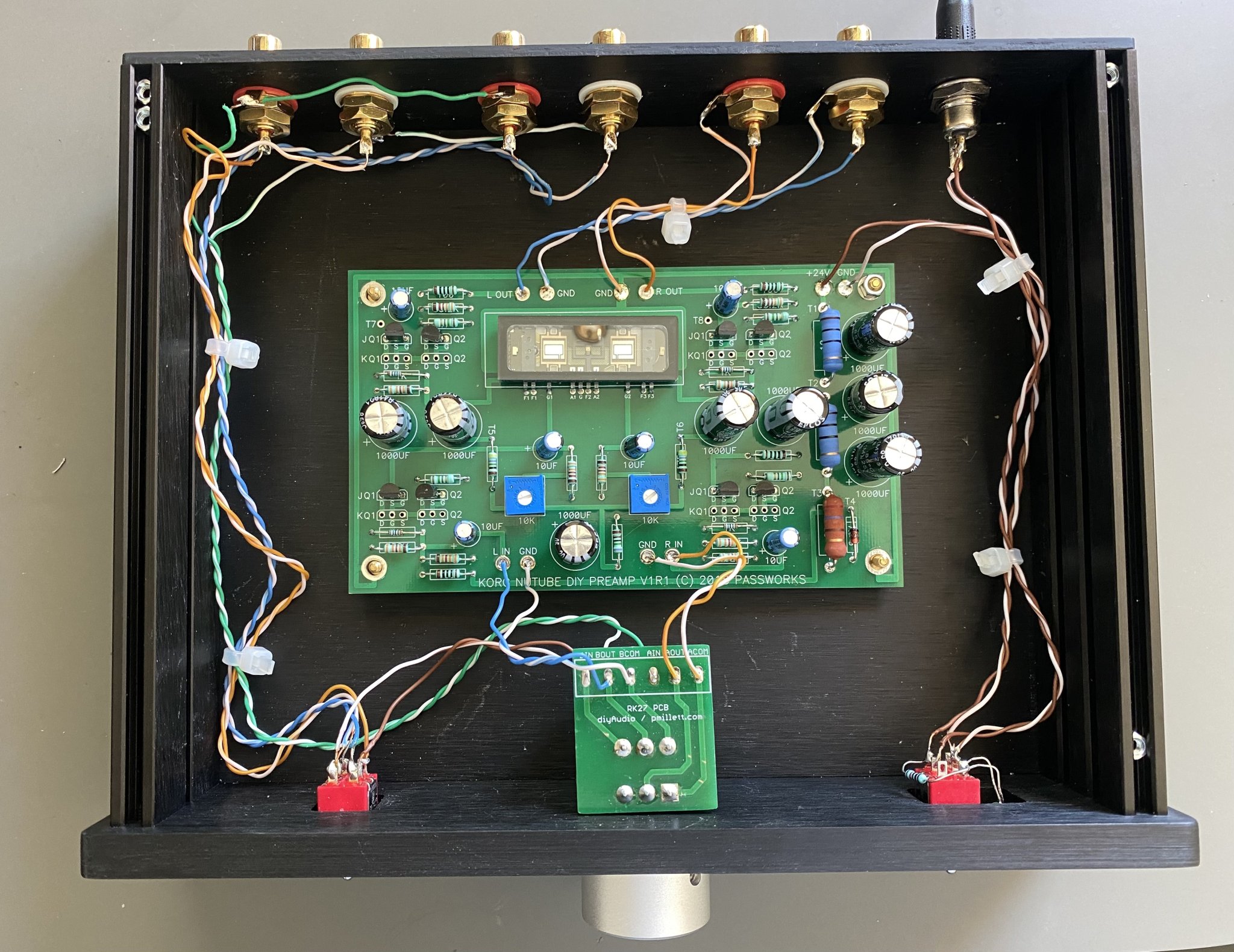

i'm a complete novice and this is my first build. I essentially followed the DIY guide like a cake recipe. Made a mistake and soldered the Peter Millet potentiometer board upside down and then damaged the pot trying to separate. Salvaged the board I think and ordered a new potentiometer on ebay which just arrived. Put it all together and it powers up fine, and works but the R line out channel is not working. Both inputs work with two different sources and changing RCA cables did not rectify the problem.
Voltages

The voltages look good so the board is probably good.

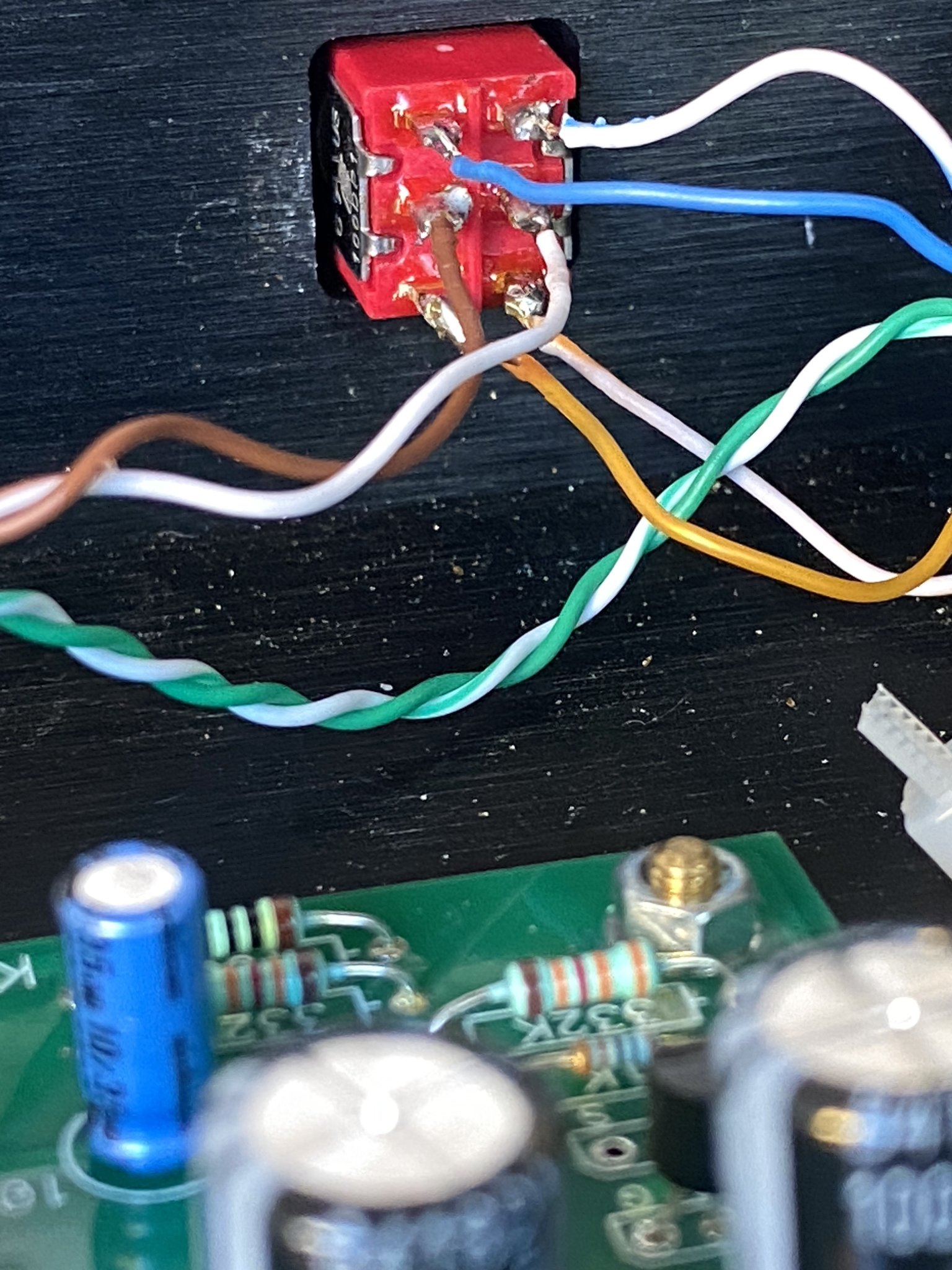

You should have a good look at the input selector switch. Check that the wiring is correct and the soldering is good. It looks like there are exposed wires so check to make sure that there are no shorts between signal wires and ground wires.

check input selector switch with ohmmeter
these are easy to melt, contact stud moving in plastic and there is no proper contact

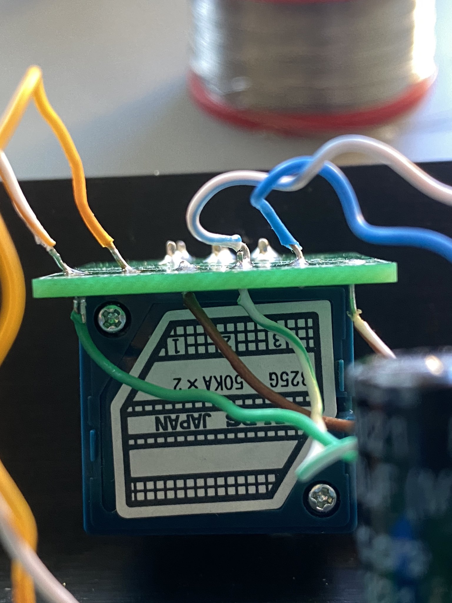

I was going to suggest you can verify potentiometer circuit board is good with quick check of continuity from each wire(s) to pot post(s) The top traces don't look damaged (few nics) and only one trace is on bottom.
ok I got about 150-160 ohms across the blue and blue and white , similar on the brown and brown and white, and OL on the orange and orange and white.check input selector switch with ohmmeter

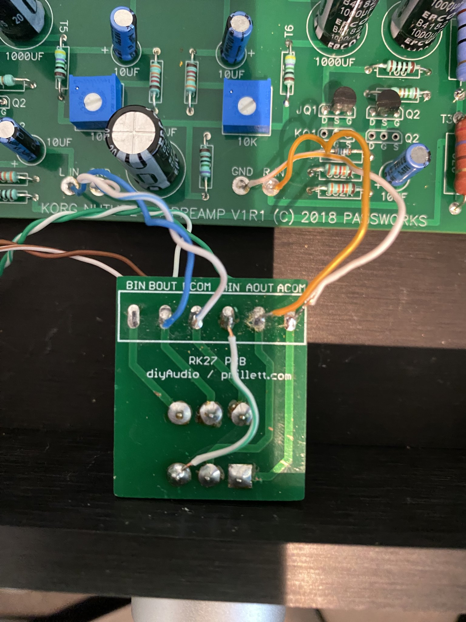

Tried to short and didn't seem to make a difference.
now - gentle play of music - short with tweezers two input pads on pot pcb
best to have isolated tweezers from your hand, to not induce hum by fingers; use some tape or heatshrink if need to isolate them
if you don't get second channel that way, then
short two mid pins of pot ( outputs to preamp pcb)

edit: what birdbox said - input selector switch - as shown on pic - vertically divided - left is one channel, right is other channel
mid stud on both is output to pot
upper studs are wires from one input RCAs
bottom studs are wires from second input RCAs
if you want to test mono - tweezers - connect two mid studs
if you want to test contact to present input - connect mid stud with either top or bottom stud on same side

Thanks Birdbox- I'm really not very good at this. I appreciate your help. I was getting OL on the meter with both poles.[Edited] I'm gonna get outta the way and let ZM help you. He's gonna be better at this than I am by miles and miles. Or kilometers x 1.6.
Zen Mod- I got both channels working with some hum ( with slightly dodgy insulation holding heatshrink with tweezers) when I shorted B out (blue) and A out (orange) on the R27 PCB

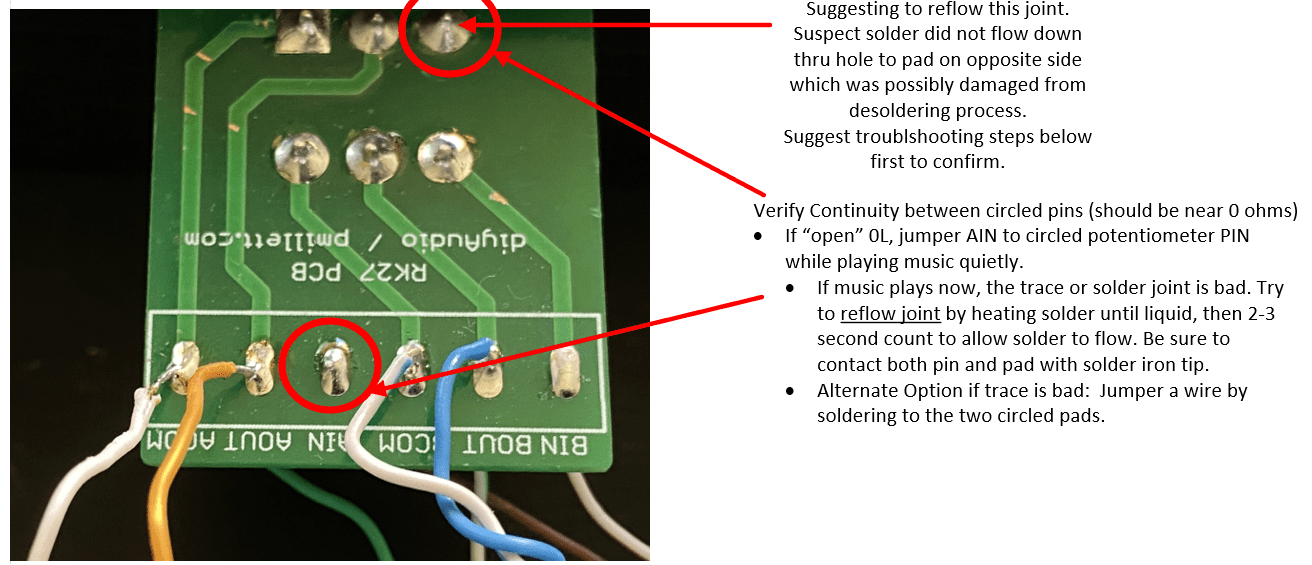

it is, if shorting two inputs on pot invoke sound on Dodo channel
if shorting inputs is not working but shorting outputs works, then pot is either toasted or badly soldered (anything on its pcb)

No- only shorting A out and B outdo you have sound in both channels when you short BIN and AIN on pot pcb?
before proceeding with anything else - take ohmmeter and check for shorts directly on input RCA of channel in question
black probe on RCA GND, red probe on RCA hot - you must read same as on proper channel
if said input is not selected with input switch ( not seeing vol pot) it must show open circuit
if said input is selected , it must show approx 50K (vol pot value)
if everything OK there, you can proceed - resolder everything on pot pcb;
if that not helps, time for changing the pot
now - do you have an idea how to check pot with ohmmeter, is it functional/ having proper readings with ohmmeter?

Thank you @birdbox and @Zen Mod !! I did as you suggested above. Was not getting any continuity between the circled pot pin and AIN, used tweezers to connect and started getting sound in the bad channel, soldered a jumper wire and now it's working!! I would never have got there without your help. Fantastic!
