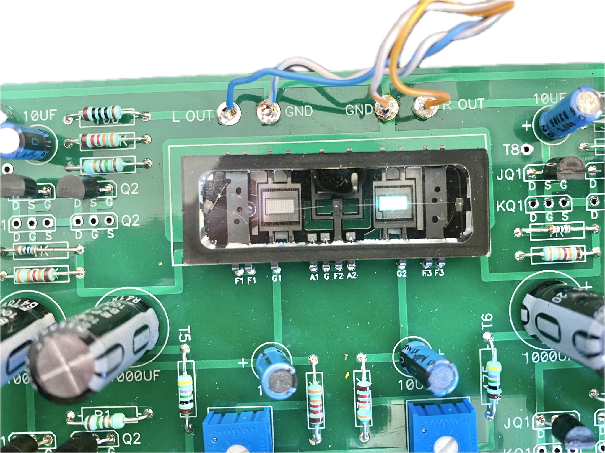

Was working fine with the jumper wire fix but been away for 2 weeks and amp was left on. Came back and only one channel working again. Opened up the back and only one green light on the nutube now...urrrggghhh. What to do?
I had dialled in T7 and T8 to around 9.6V before I left.
Now readings are
T1 23.8 V
T2 23.07 V
T3 22.33 V
T4 9.11 V
T5 9.11 V
T6 0.65 V
T7 20.59 V
T8 9.6 V

Well that's a big bummer @gwam. You finally get the right channel working and the left fails. It does appear you're going to need a new Korg nutube. Store does have them for $50. The question is why did it fail. Last thing you want to do is swap in a new one only to have that fail due to some other issue. I'm not sure how to figure this one out. More experienced builders will have to chime in.

Random failure is a possibility but Korg is clear that if the filament glows red you have a problem with
too much current.

Hello everyone, I see others have had similar problems, any recommendations on things I can check to find out why I've blown two NuTubes in my preamp? Far as I know, voltages/biases have measured fine, sound quality has been excellent while working. But twice now, a channel has stopped working permanently, I'm about to plunk another $50 on one of these, but this is going to be my last one. They're also MEGA microphonic, both of them have been, right out of the box, like clap from across the room and my speakers are ringing a high frequency for 2 seconds. I love this preamp otherwise, sounds excellent, so I would very much want to mitigate these things if possible. Thank you!
I've replaced my NuTube once, and if that one fails I will not be replacing it again. Quality control appears to be low.
I used a foam mount from @pmillett to help with microphonics and it works very well. Search on eBay for "Anti-vibration mount for Korg nutube 6P1".
I ordered my last tube from Japan, and zilch, none, nada, microphonics. Although it was on my custom decouple board. My suggestion is decouple entire board with rubber washers, and use wire to gnd the board to case. Also it's of great importance to use decoupling board for nutube itself, either use pmillet set or make your own (i can post gerbers here when i return home). It will reduce microphonics to minimum. And use something like vibrofiltr to dampen the case if issues persist. In theory, it will also improve nutube life.

I commented much earlier about apparent lack of QC by Korg, but ultimately concluded that nothing can be definitively determined. As I am thinking this through, another possibility is that electrical surges in the AC mains may result in transients in the filament/heater that cause it to fail prematurely. But, I do not know if it even possible for such surges to be propagated through a switched power supply. Is anyone knowledgeable about switched PS design that they could comment on my supposition (not a theory).

Here’s a thought…my Nu tube has been powered continuously for 4 years BUT powered by a linear supply with a lm317 regulator. Iam not using an smps. Coincidence? Iam not sure.
