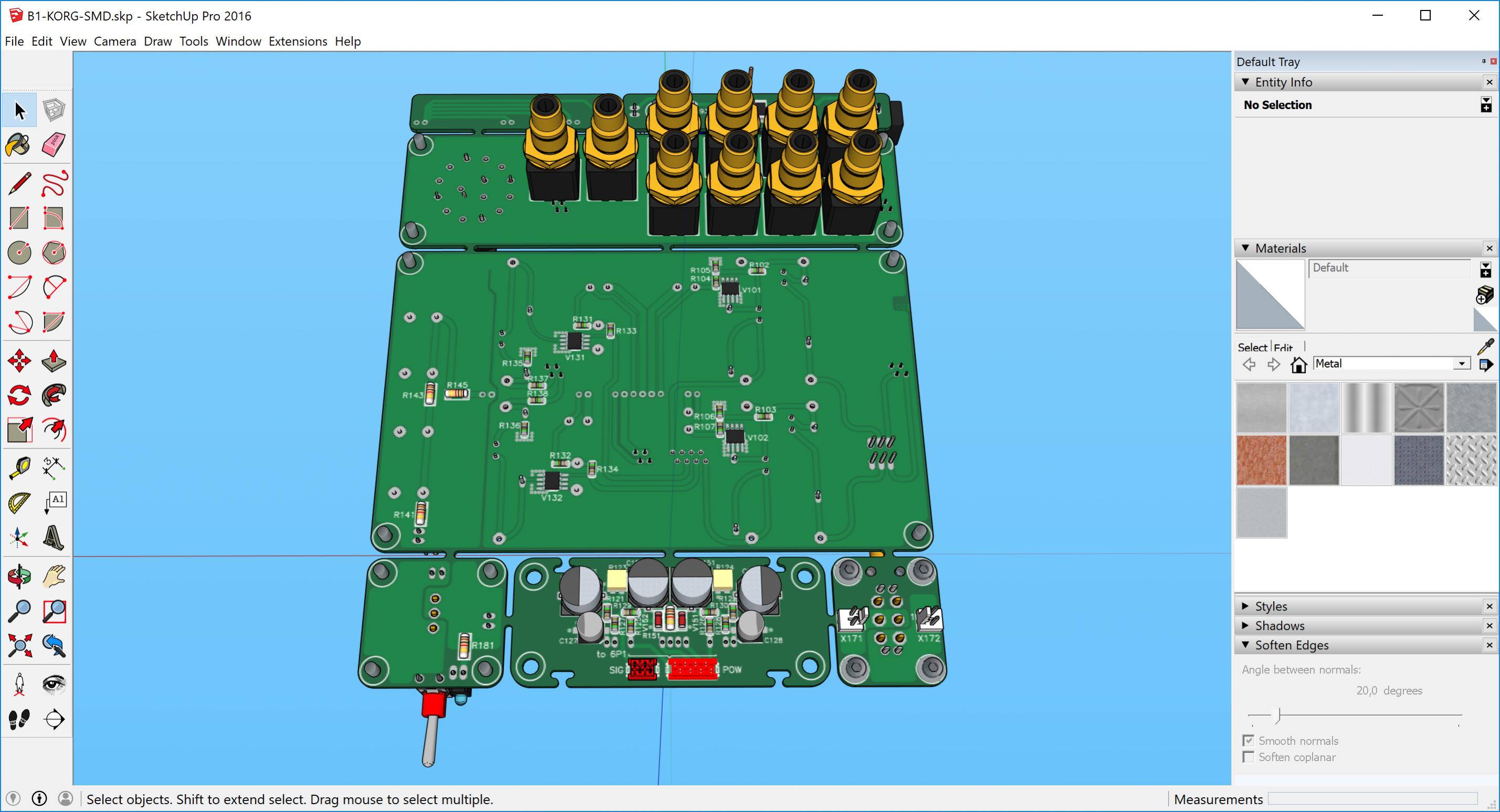

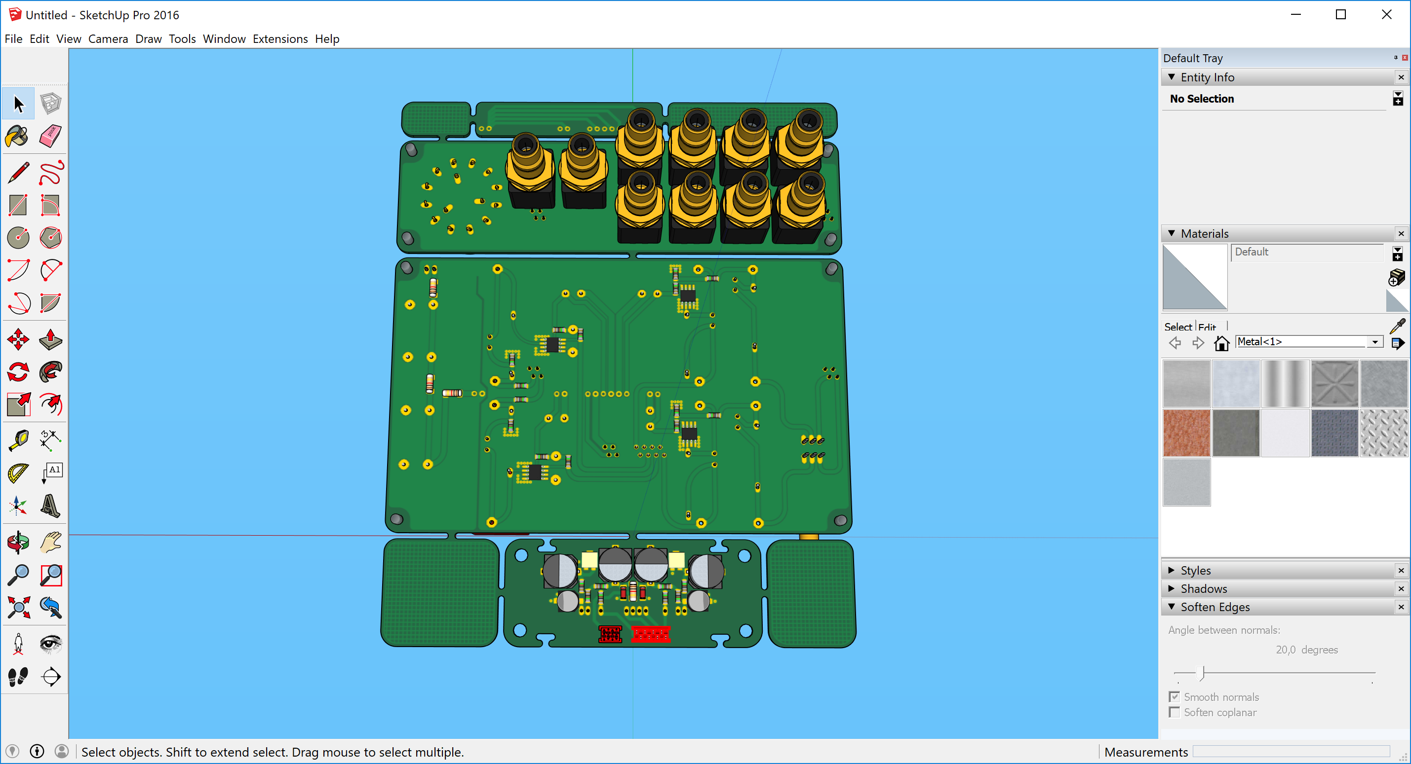

B1 with Korg Triode
with SMD components (LSK389-B-SO8 and Melf/Minimelf).
JP
  • B1-KORG-SMD_SCH.pdf
    B1-KORG-SMD_SCH.pdf

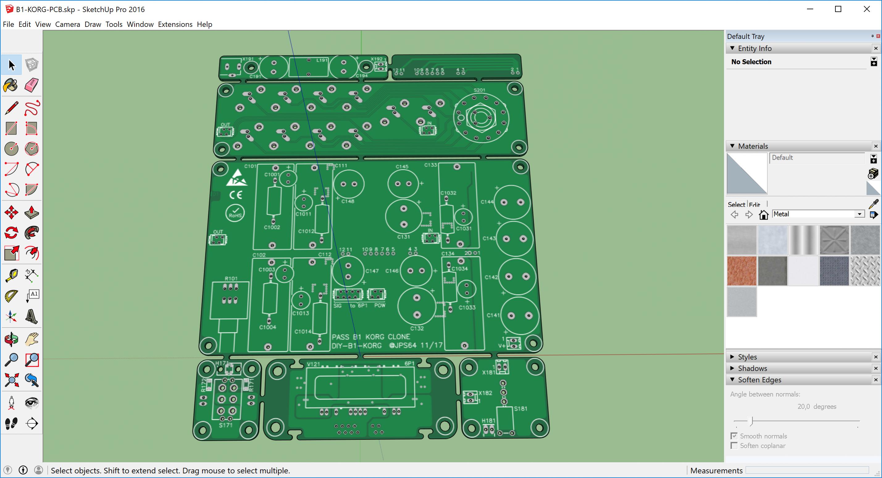

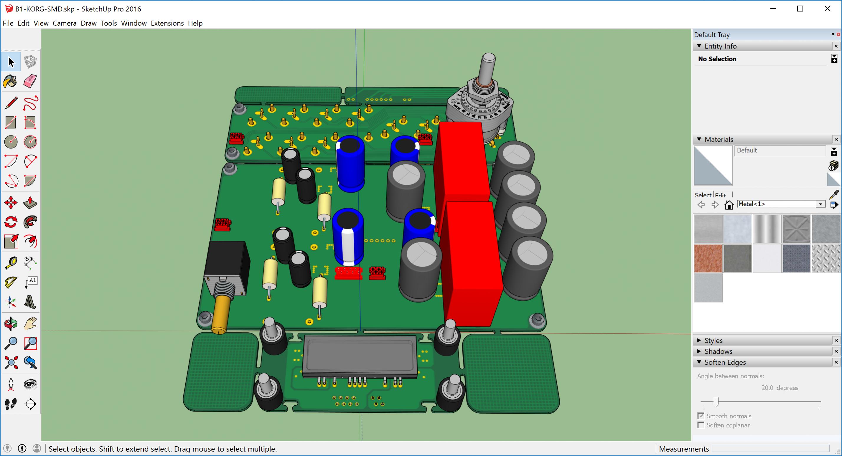

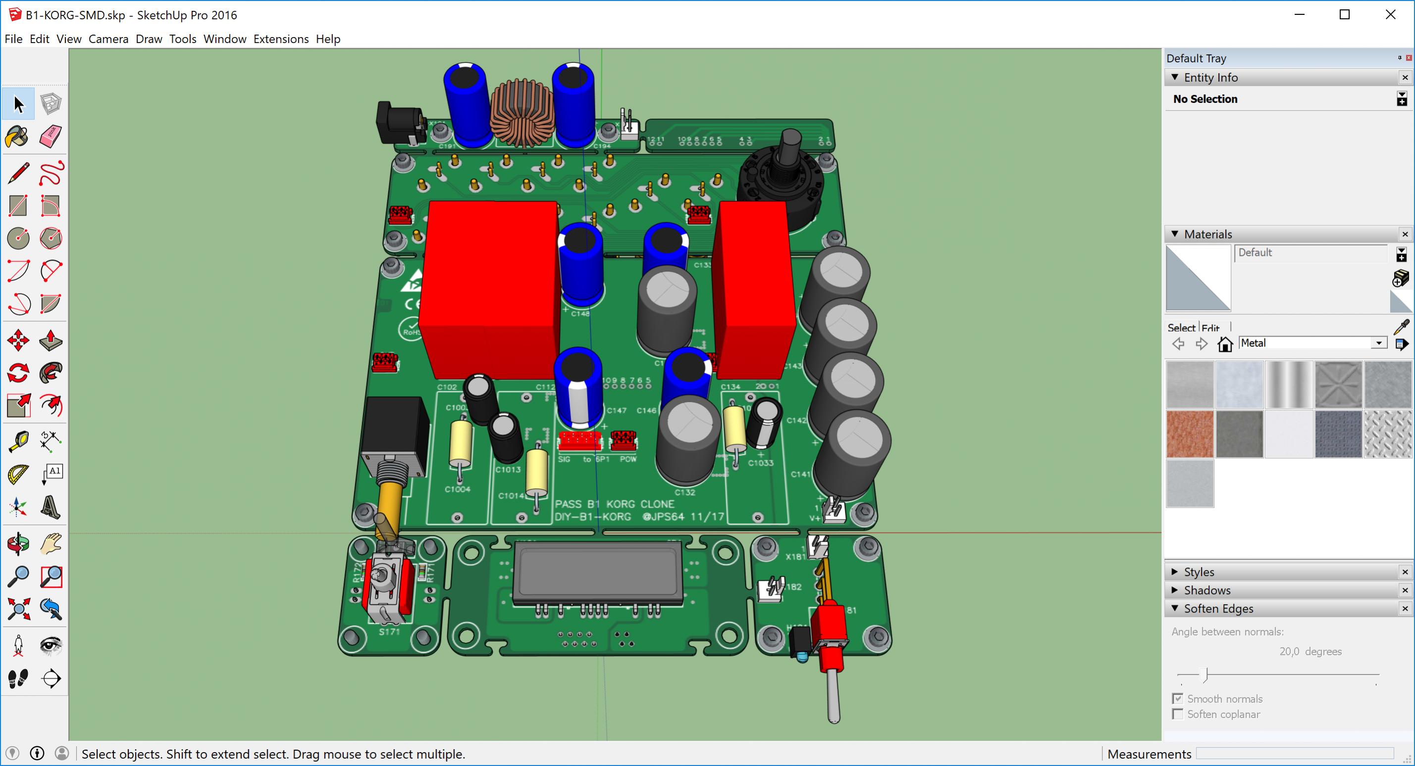

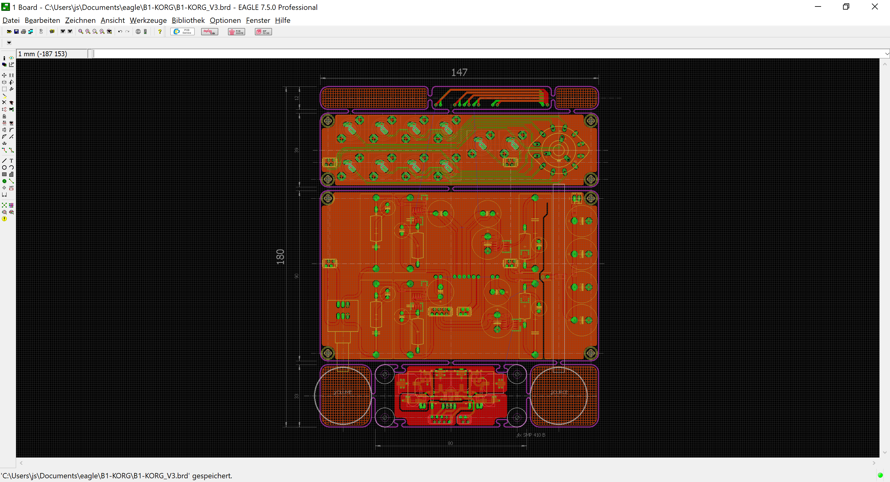

Here my implementation: mixed THT/SMD.
Will order a batch of 10.
JP
  • B1-KORG_PBA-BOT.pdf
    B1-KORG_PBA-BOT.pdf
  • B1-KORG_PBA-TOP.pdf
    B1-KORG_PBA-TOP.pdf
  • B1-KORG_SCH.pdf
    B1-KORG_SCH.pdf
