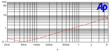

I assumed that it doesn't have enough gain (I thought 10 db at most) or that it can't swing enough voltage to drive a mosfet follower (like F4).
You would want to look at the distortion curve and decide for yourself.
My take on it is that you don't probably want more than 1% thd, which keeps
you in the "sub 1 volt" output region.

Maybe I got it wrong, but does it mean that its distortion would be too high if it was requested to swing high voltsges, as required for a mosfet follower?

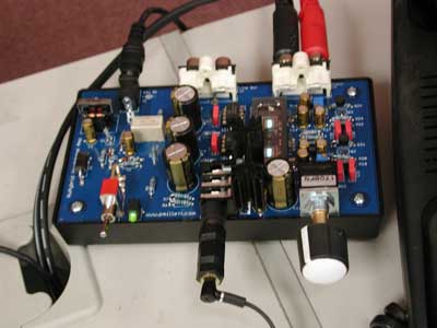

Just touching the volume control on mine (not a stepped control) gets me the fairy dust sound that ChuckT mentioned. That would create a reasonable possibility that typing on the keyboard a foot away is introducing noise into the audio too.
Would it be sacrilegious to put 10dB of feedback on it?Depends on what you mean by "too high".
For those that didn't read the pdf, here's the curve.
Would increasing power supply to 30V bring distortion down?
Looks like the distortion has been designed for an amp with at least 20dB of gain.

If touching the volume control gets a reaction you want to check to see
that the case of the volume control, and maybe the faceplate is grounded.
This is a common problem.

I have a plastic knob on the volume control. I'll have to see if I have any way to shoot a video of it in action with good audio but I can pretty much play a song with different ringing sounds by tapping or brushing anywhere on the plastic case, pcb, components or cords plugged into it. If I really upset it the ringing takes about 1-2 seconds to fully fade from my ability to hear it.
Maybe I have an odd one that likes to sing. I need to experiment with my buffer one and see if it does the same. Although I keep thinking I may disassemble it and my recently completed B1 to make the B1 with Korg 😀
