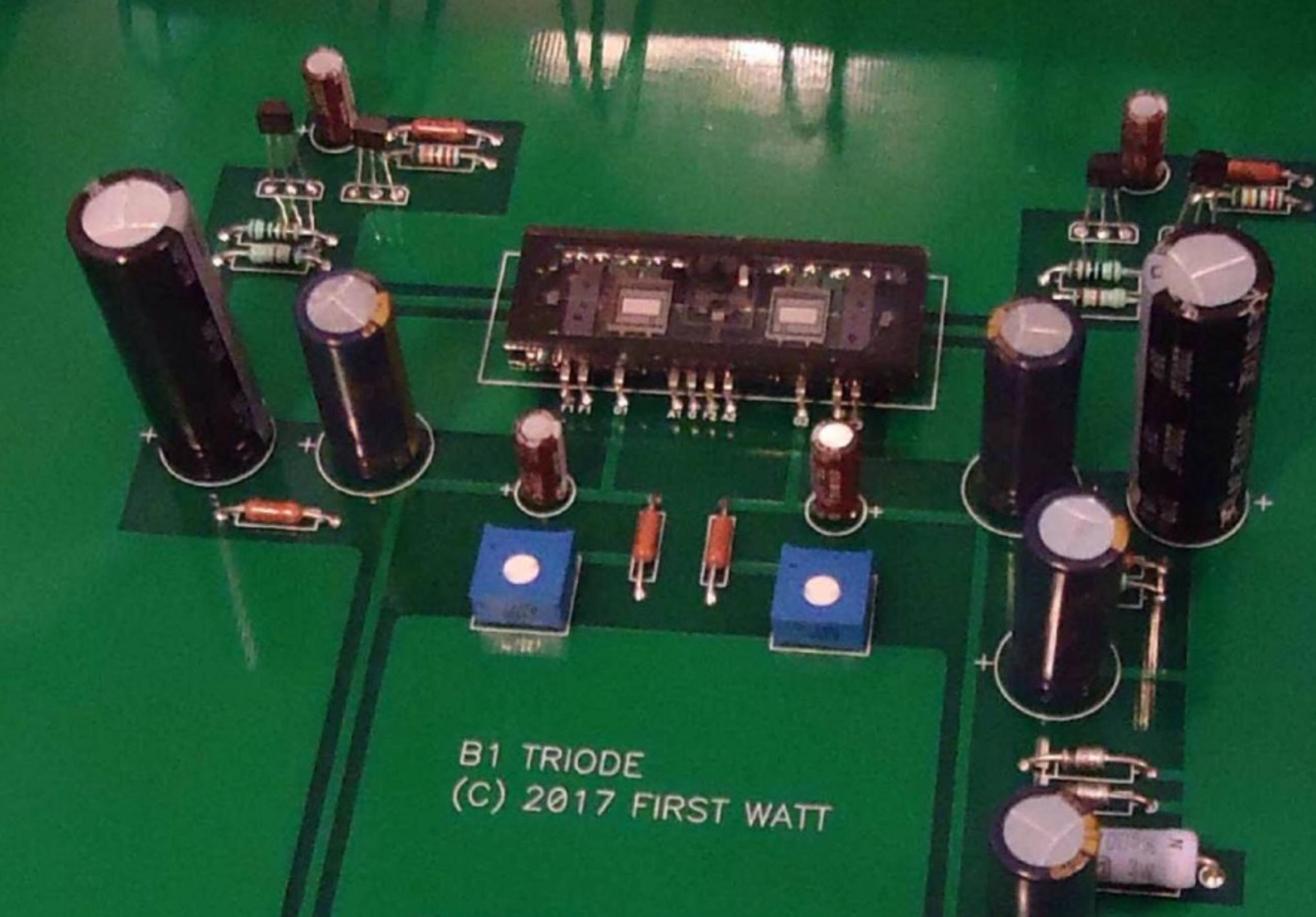

I'm listening to headphones through an amp with the Korg tube in it now and this design is really tempting.

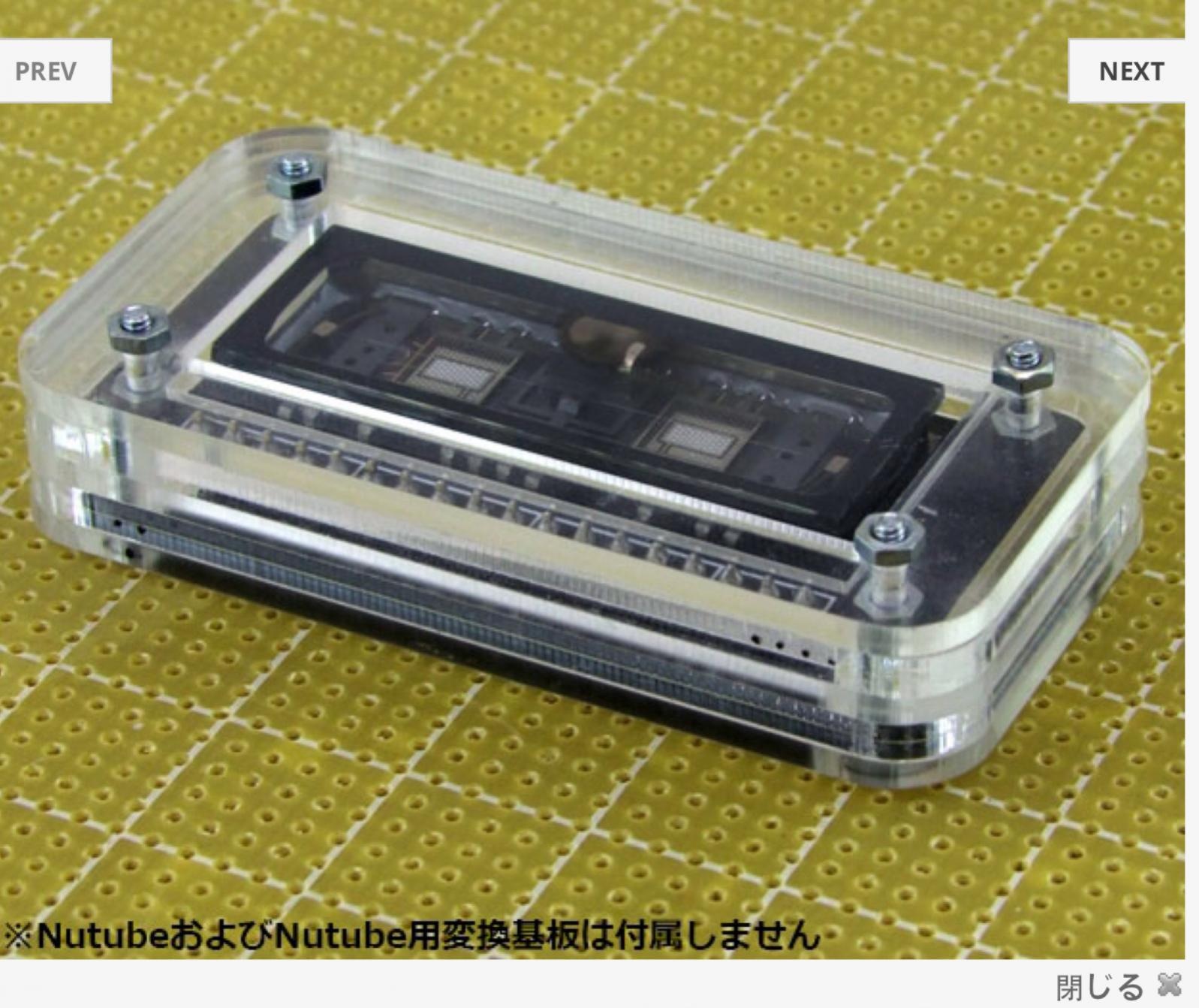

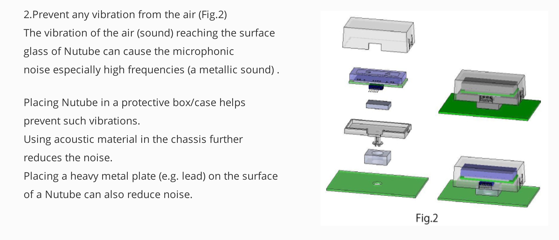

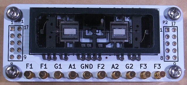

These tubes are pretty microphonic so some sort of cushioning for the mount might be helpful. When the delay relay kicks on the sound on the amp I have I get a high pitch 'ching' sound through the headphones if I don't have audio on it yet. Turning the power switch off gets an even louder sound.

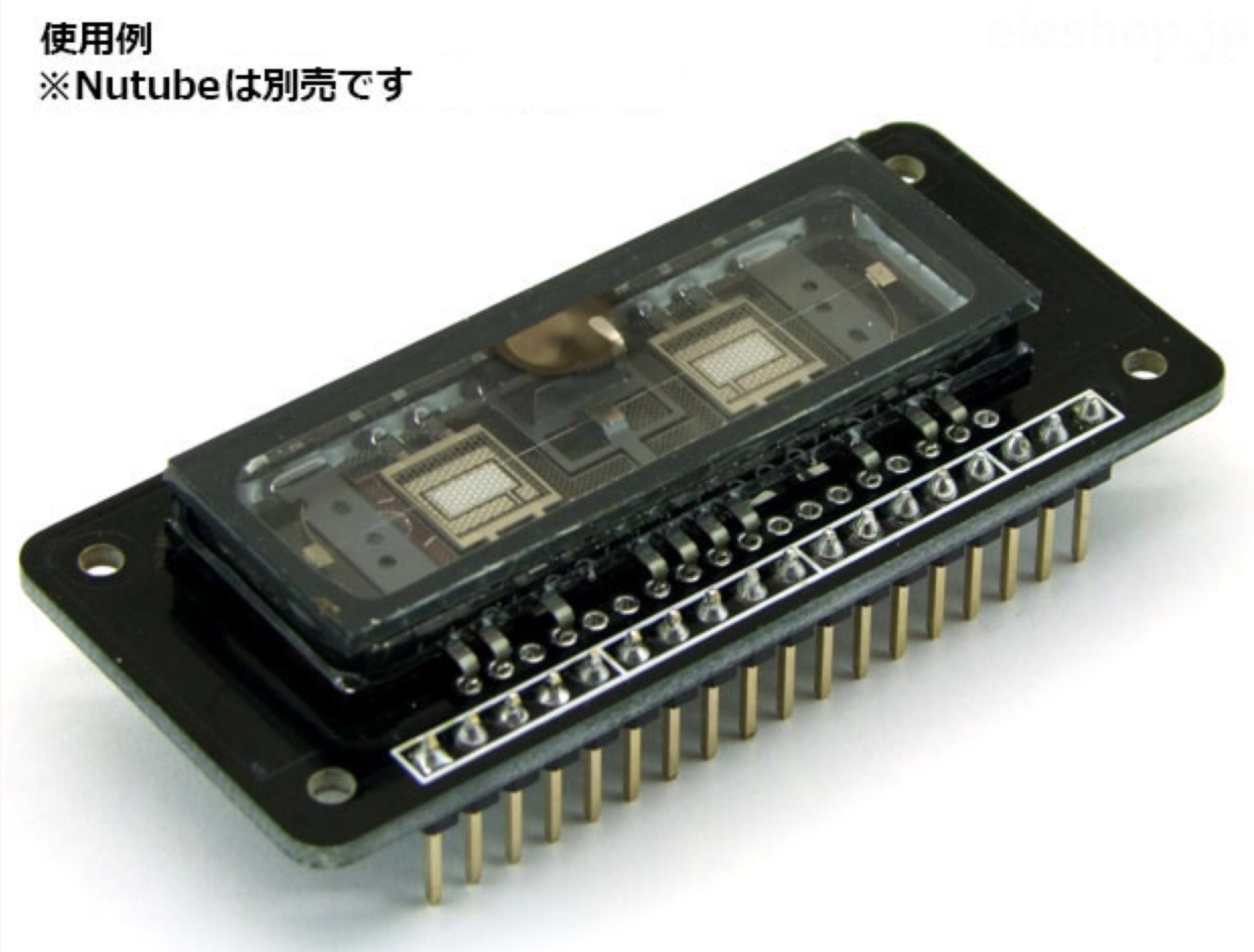

I'm not sure what the side effects of connecting the tube with wires rather than just the pins would have but that would not only help but also allow placement of the tube so it could be seen glowing.

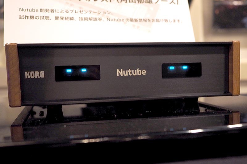

Since that post I received a nice note from Mr. Tohyama of Korg,
and he sent me a picture of the preamp on display at RMAF.
Thanks a bunch Mr Pass !

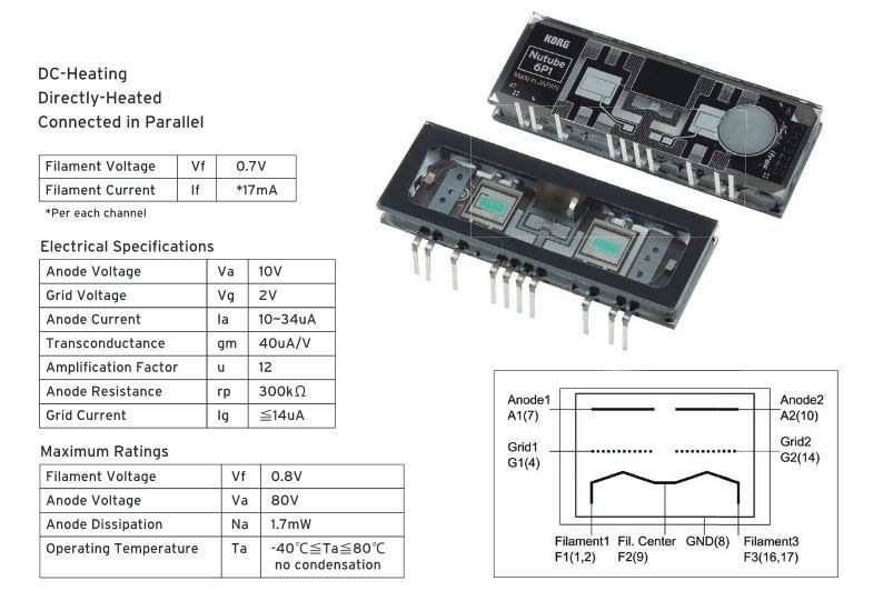

Please 2SK370 or 2SK170 what is Idss range for B1 Triode.

I bought a couple of Pete Millet's on ebay to round out my stock,
and they arrived quickly enough.
The data sheet talks about microphonics, but I tapped away on mine
and didn't see it in the residual thd/noise. Could be overly cautious Japanese,
but they do recommend an absorptive pad.
The other possibility, look at the impedances involved - load resistor is almost
400K, and can probably pick up the electrical noise from any switching.

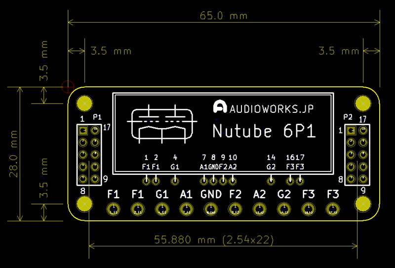

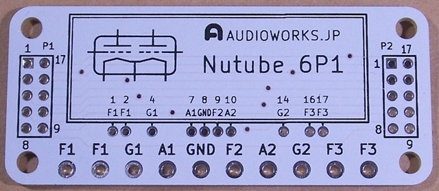

On the buffer that I built with Millet's PCB I have to really tap the tube hard and have the volume full with audio paused to hear any hint of sound.
With the headphone amp also using his PCB if I have the audio paused, volume at 1/4 and just brush my finger against where the headphone is plugged in I get a faint ringing sound like tapping on a crystal glass. Contact with any component on the PCB generates a similar sound. If I tap directly on the tube with the volume on I can hear the 'cling' in the background of the music.
My 6p1 microphonic as I also have Millet's headphone board and I can heard a zinging sound whenever I turn the volume or just touch the chassis. Transferring the board to a wooden box reduce the zinging sound by quite a bit, probably the previous metal case resonates easier.
When mounting the 6p1 best to try to isolated it as much as possible, IMO.

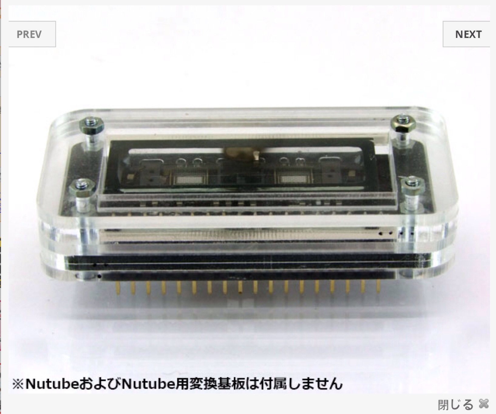

Some people made plexiglass boxes (laser cut or 3D printing ?)
but frankly, who knock the glass or shake his preamp in everyday listening.

as for subminiature tubes, ringing could be a problem but easilly to solve with damping material.

Those who put the volume pot in the same chassis as the 6p1 tube. Mine is a step resistor volume, so there is some very very soft click for each step of turn. The zinging lasts a few seconds and sounds like high pitch fairy dust fading away.😛

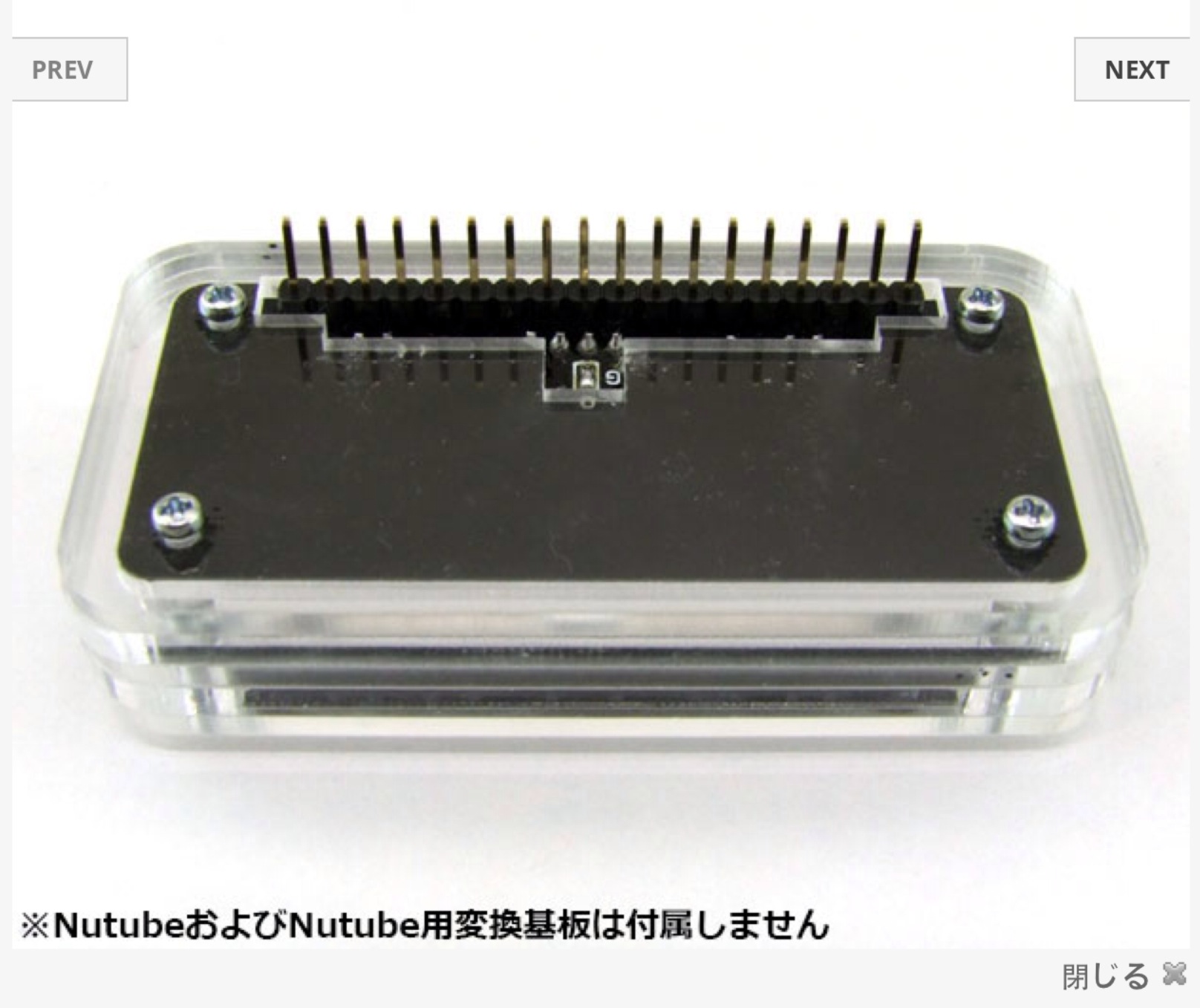

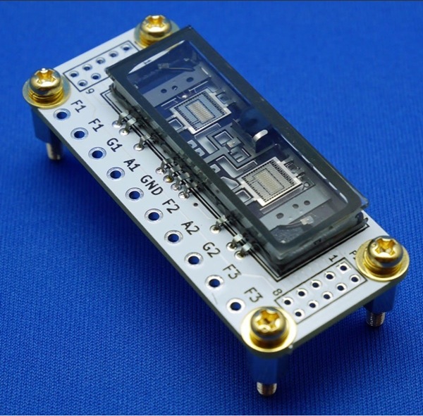

Use soft rubber pads can avoid Nutube mechanical vibrations coupling with the other elements
can erase or greatly minimise microphonic effects, especially with step resistors attenuators imho.

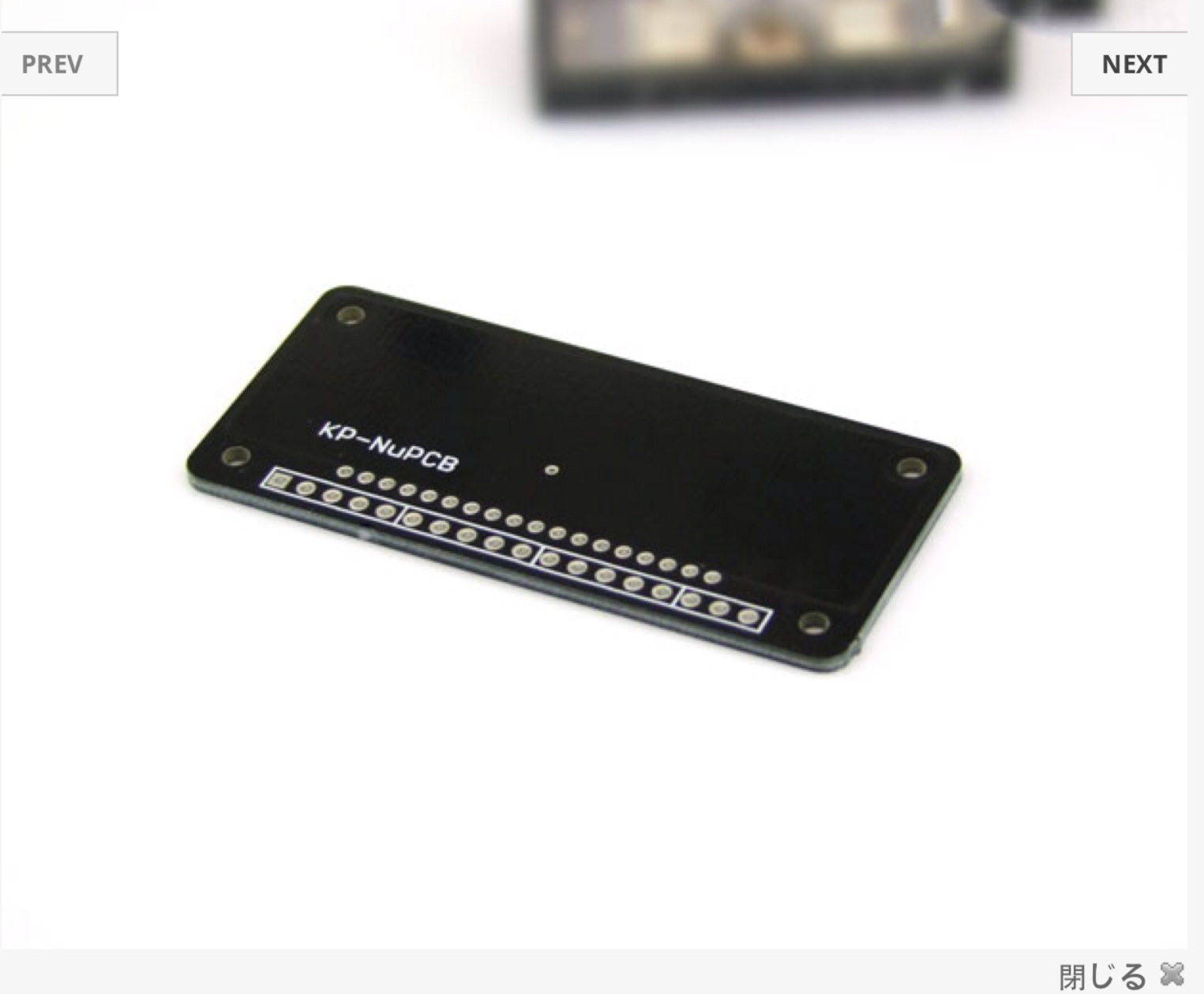

Beautiful turquoise light glow on the front panel is possible with mounting on the small pcb.

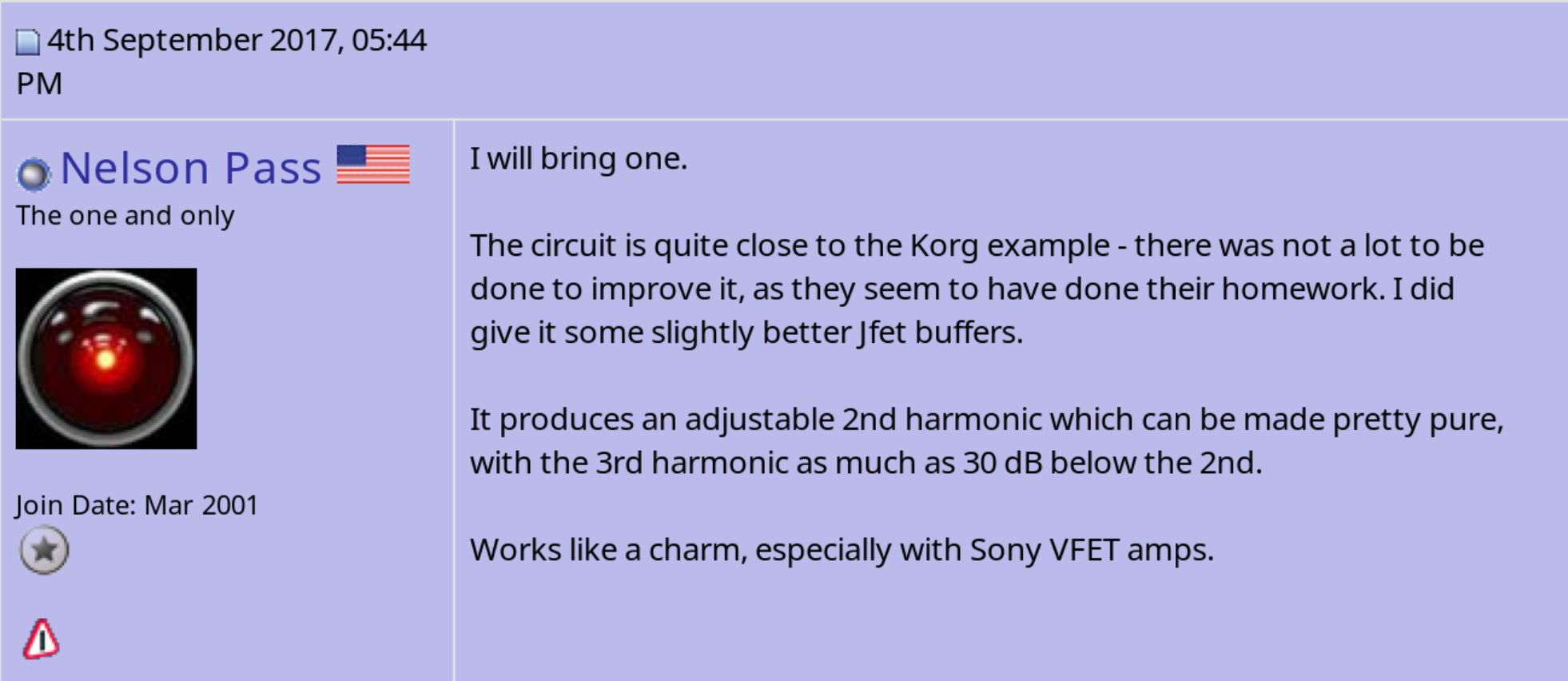

Now, would this one count more as a buffer or a preamp. Ocassionaly I was thinking about such a preamp, with a tube sandwitched between two j-fet buffers, due to a fact that such a tube would need low input impedance but would have high output impedance + eeny weeny current to drive anything but the buffer. But the point was that such a tube wiuld have a high gain, 15 db or so, in order to be used with a mosfet follower (F4 or similar). But, I see that this circuit is neither a buffer nor really a high gain preamp. Then, what it is aiming at? 🙂
Most firstwatt amps don't need a high gain preamp.
6dB is usually enough.

Why you think is not a buffer or + 10 dB gain preamp?
In the article, Mr Pass write he voluntarily limited the gain.
Try maybe read the article first. Bonus feature is sound processor you can tweak your distortion and phase

I assumed that it doesn't have enough gain (I thought 10 db at most) or that it can't swing enough voltage to drive a mosfet follower (like F4).
But if it can, then.. 😎
