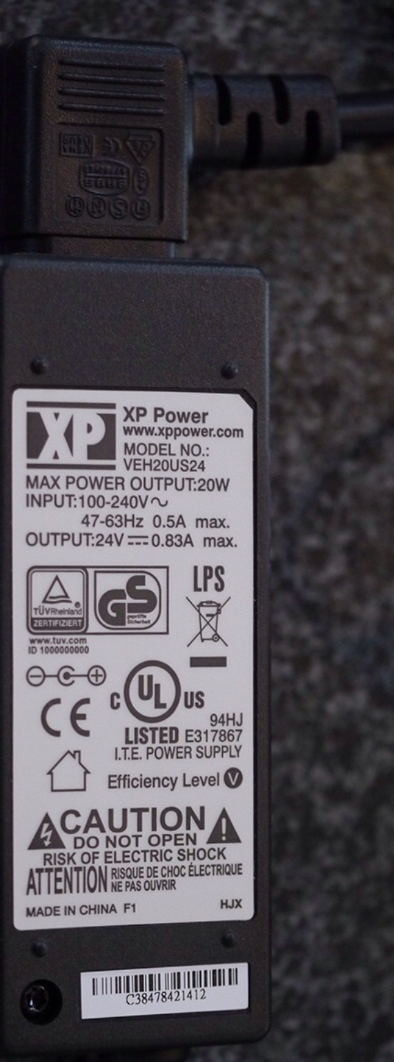

plus minus power supply option?
It's 24V smps with (+) in the center after this photo courtesy of 6moons 🙂

would rather build my own power supply. doable ? just a 24v supply?It's 24V smps with (+) in the center after this photo courtesy of 6moons 🙂
yes, thanks!! Does the notable need its own power supply? I don't see in Pass schematic?
B1 Triode need only one 24V smps brick.
You get two mono outputs. Korg Nutube is double triode in one package.
Just connect Your power supply (+) to the first 10R resistor of the filter and (-) to the ground.
Filter +F output and + R output connection to his corresponding +F and +R buffer circuit input(s).

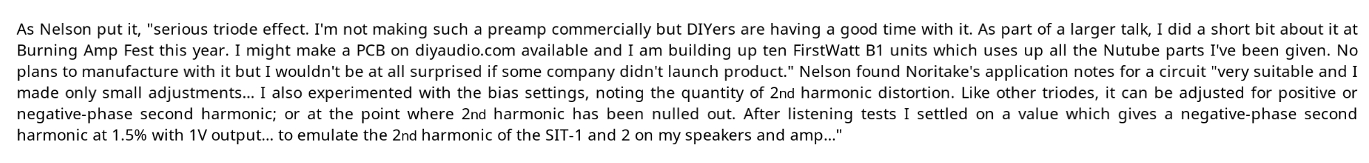

I have the Millet version and it sounds really good. Using my spectrum analyzer software I only see a very slight addition of 2nd harmonic. A very good preamplifier to give a SS amplifier some lovely flavor if you are looking for it. In the discussion of the circuit he does mention that J-fets can be used for buffers with just some resistor changes. How much it would help audibly is a subject for someone that builds both. I would expect that there would be a measurable difference. NP did some more improvements as well. I believe it was a cascode on the J-fets as well. Having no boards available will keep most from building NP design. When and if someone comes up with some boards I will build NP design.

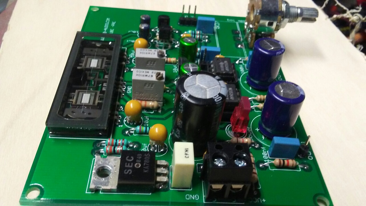

hi , i've some pcb in surplus for nutube projectHi-your attachment is not working and it weird the post disappeared? Sorry I am not so skilled. plus/minus supply available and is there a way to build a balanced version? Aslo, does anyone have an idea when the PCB will be available? Thanks!
