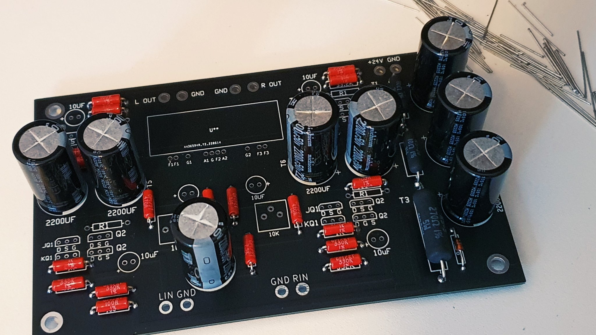

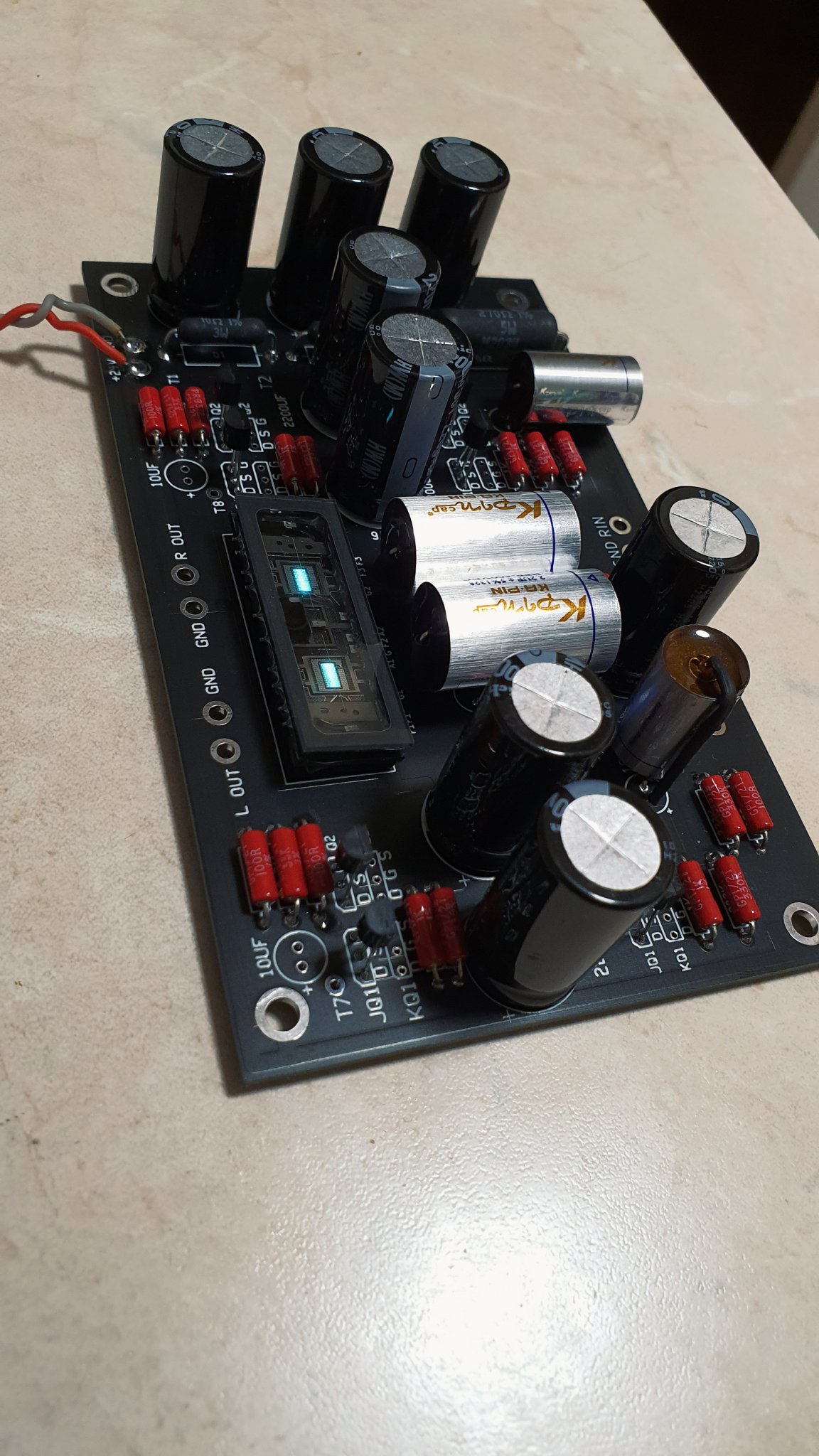

Mouser order arrived, and i got so some soldering done. Black, white and red looks so nice 🙂 Next thing is to go through 100 pieces of j113 fets to pair and match resistors for it. All in all, fingers crossed that noise problem was due to the nutube.
@Brijac , did you manage tot get rid of the hiss? I am asking because I also have a hiss in both channels. The hiss is constant, no matter how far I turn the Alps potentiometer. I was wondering wether/how you solved the problem.@Zen Mod alright, i've replaced 1k with 2k2, left 33pf across 332k, and added 33pf from anode to ground, and it does seem to lower the hum/hiss. Tomorrow i'll get resistors up to 10k and give it a try with those, to see if that noise is managable to the point that i don't hear it in listening position.
@kror I still haven't tested the rest of the values. It did lower the noise but not enough. My appartment is still in renovation, and this custom board i have just soldered without a listening test (and i've yet to match jfets). When i get my setup done again when it's done, i'll test the rest. But also by then i'll have this new one ready, so i can see what the problem was about.

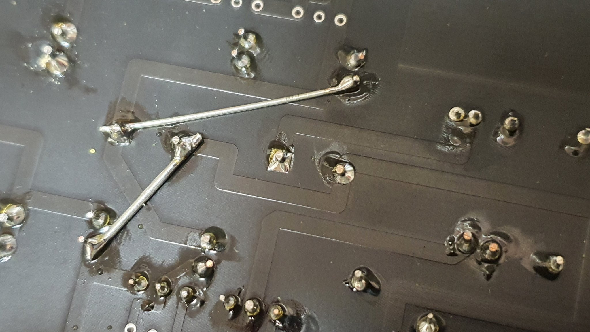

I have some good news and some bad news. Good news, it's ALIVE! All T's voltages are on point. I just haven't soldered 4.7uf due to positioning atm, need to find a suitable test box for it. Then to test if it still has the same noise, which is a few days or a few weeks away (if i manage to hop at my friends, or wait till my appartment renovation is complete).
Bad news is PCB design needs some more work. I had to connect two points on the back side as i've missed those traces in design. So when i get to reworking it, i'll post the file.

Happens to my first boards quite often, which is why I start with 5...I have some good news and some bad news. Good news, it's ALIVE! All T's voltages are on point. I just haven't soldered 4.7uf due to positioning atm, need to find a suitable test box for it. Then to test if it still has the same noise, which is a few days or a few weeks away (if i manage to hop at my friends, or wait till my appartment renovation is complete).
Yeah, i only ordered 5 as it's a minimum on jlcpcb. I'm quite happy though, it was a great learning experience in making, and in troubleshooting.Happens to my first boards quite often, which is why I start with 5...
