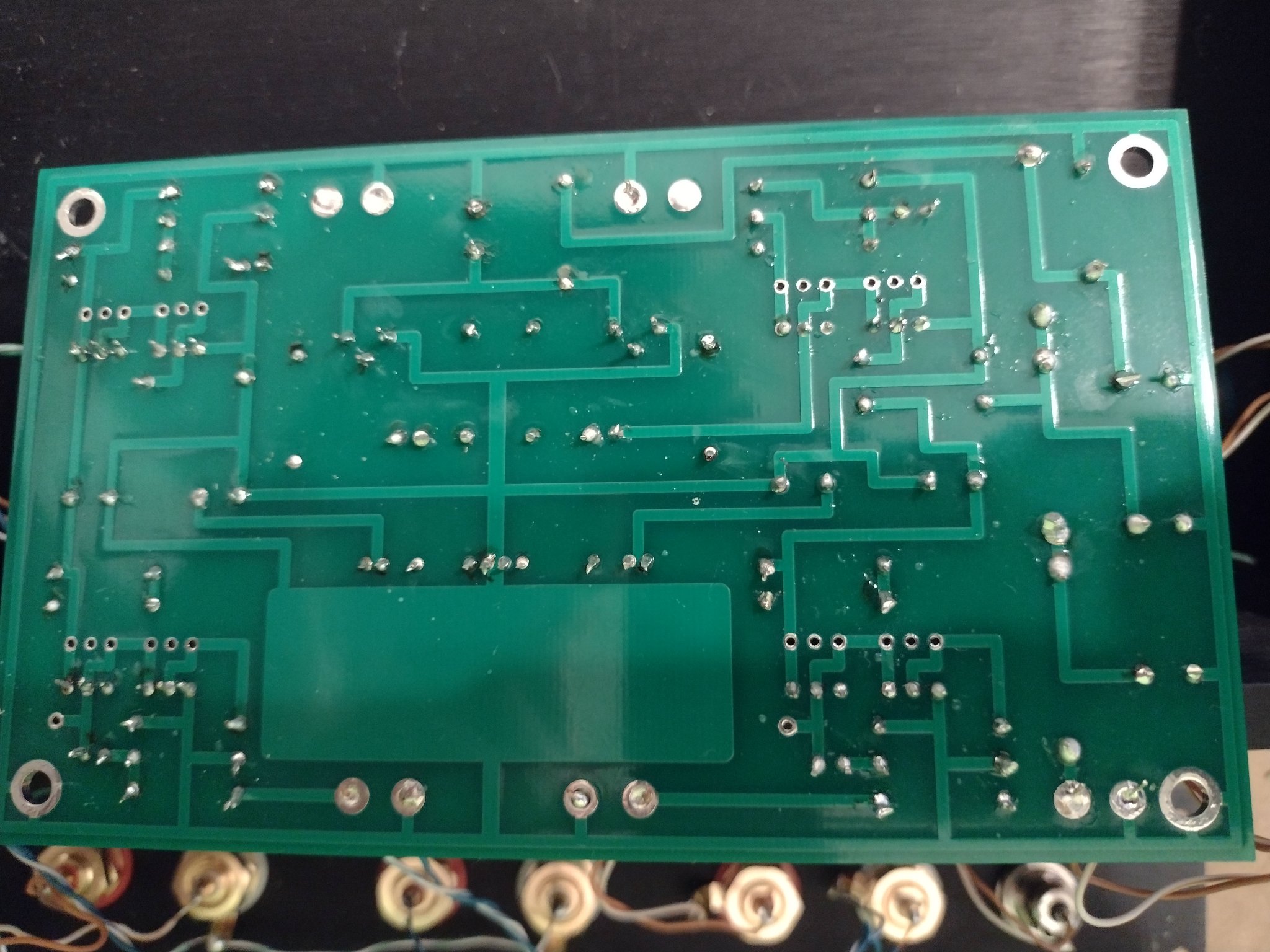

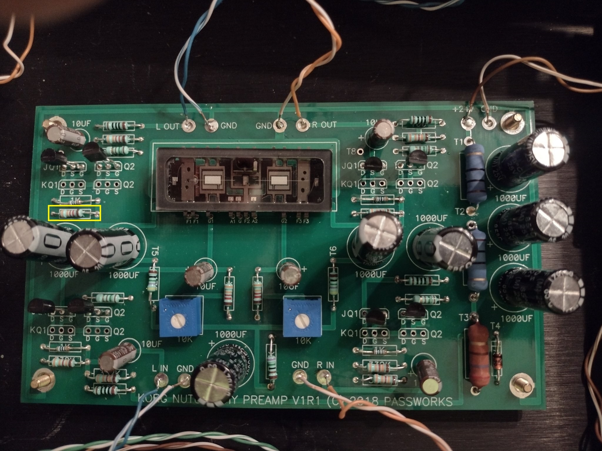

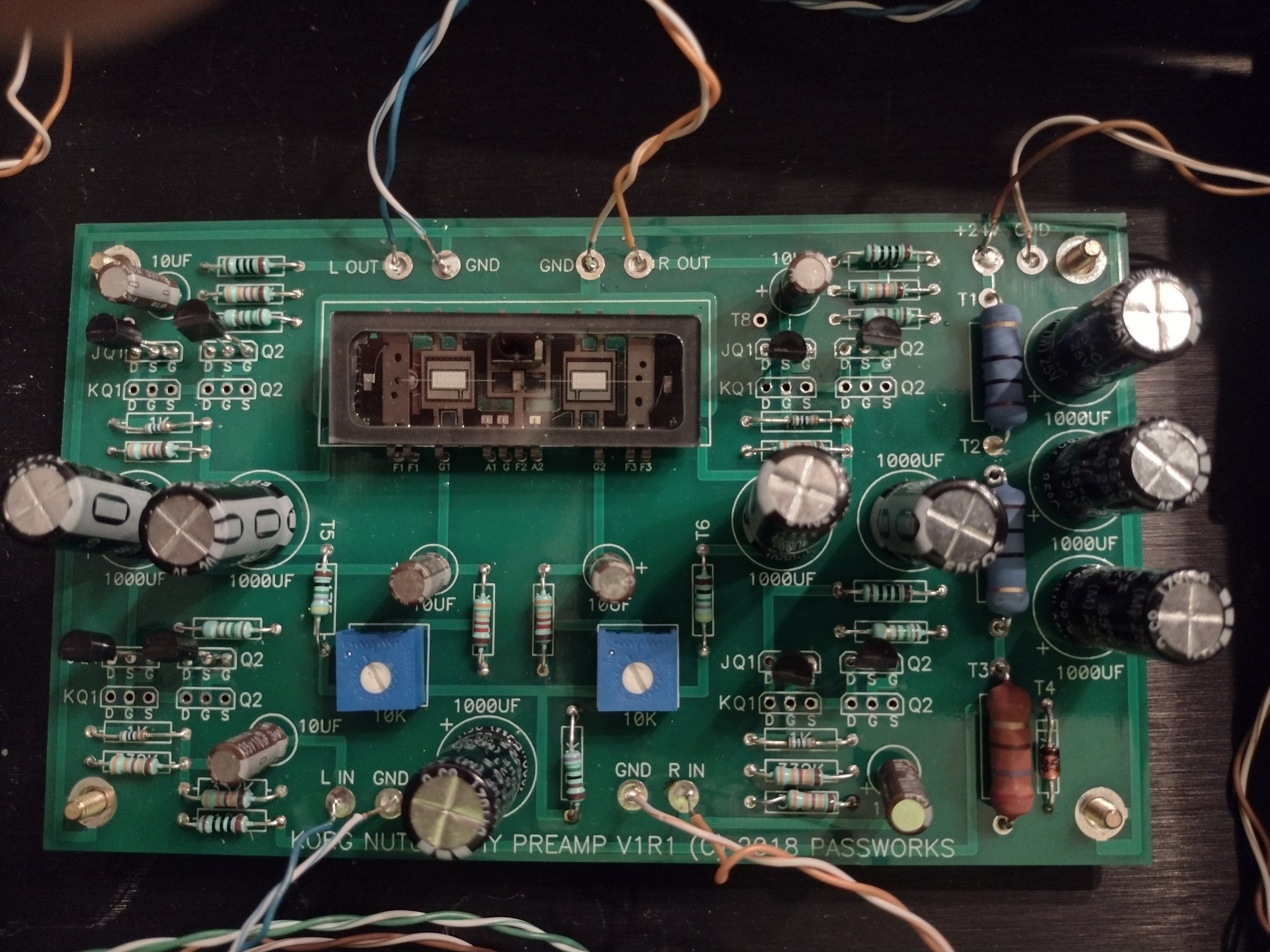

Hello all. I've hit my frustration point with my kit. When I checked my voltages they were all good, except T7. I can get T8 to 9.50 VDC, but the lowest I can get T7 is 17.61 VDC. I've been reading this thread and I have reflowed all of the solder joints, but with no change. I've attached pics of the board. Any advice would be greatly appreciated

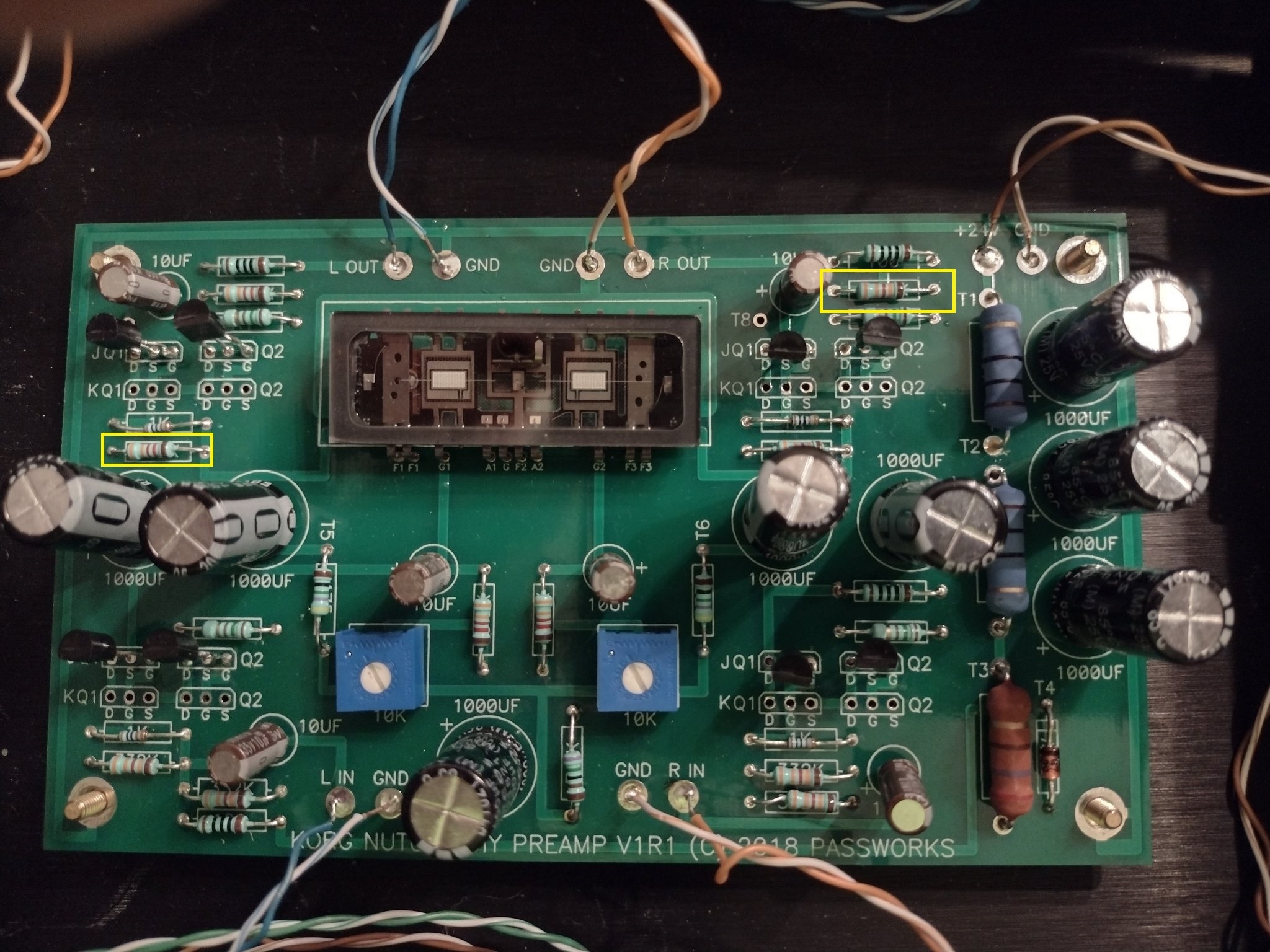

Check the resistor at the 332k location as it does not seem to be the correct value.
I just had another look. Resistors need swapping.
I'll be darned. It's amazing how much you try to double-check stuff and still make a mistake. Thanks so much for your eagle eyes! I won't get to it for a couple of days, but I'll let you know how it turns out.Check the resistor at the 332k location as it does not seem to be the correct value.
Once again thanks for your help. It's greatly appreciated. 🙂
Thanks for the helpful advice. The funny thing is, I did measure and then put the resistors in the wrong place anyway. 🙄 It's those darn decimal points! To err is human I guess.
Seconded. It's the best advice about building these things I've ever been given. Not only is it a good way to double check things, but it's not impossible to get a part that's really out of spec, or damaged. Checking the basics can save real headaches later.
I've done it too.Thanks for the helpful advice. The funny thing is, I did measure and then put the resistors in the wrong place anyway. 🙄 It's those darn decimal points! To err is human I guess.
Hello All. I was able to switch the resistors and after keeping it on for a couple of hours T7 and T8 are stable at 9.50 VDC. Thanks so much, Ben Mah for finding my mistake. Thanks, Mark Johnson, rikiheck, and Mr. Pass for your help and encouragement. I'll be putting it in my system soon. I'll let you know how it sounds. 🙂
