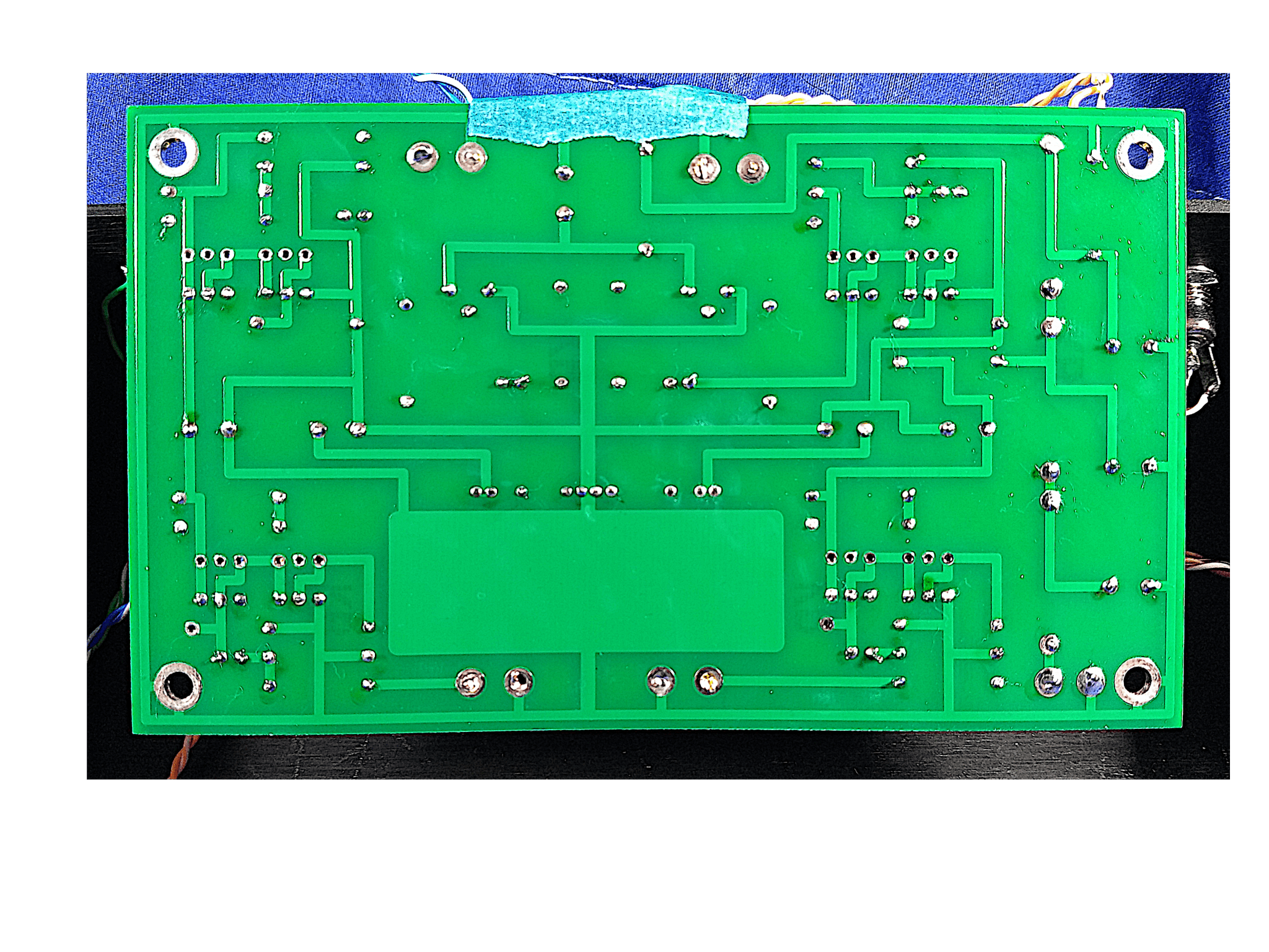

Thanks I will hope to do that within a day.Please post a series of well-lit, in focus photos of your build to start the debugging process.
The voltage across R1 are approximately the same for left and right channels. That is good. That indicates the output buffer for each channel is functioning.
The very low voltage drop across the right channel 332k resistor indicates practically no current flowing through the Nutube right channel. You mentioned that the right channel Nutube varied in brightness as you adjusted the pot so that is a good sign that the filament and bias circuits are working.
I suggest you check the Nutube right channel solder joints and reflow them.
Also post pictures of the both sides of the board as 6L6 mentioned.

I didn't see anything that looked bad or wrong in your pictures.

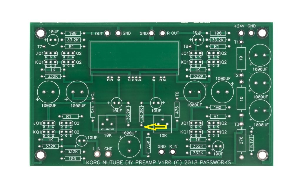

Also measure the voltage at the 33.2k resistor (relative to ground) in the attached image. This voltage is the bias or grid voltage for the Nutube and it should be about 5.2V or so when pot set is at maximum.

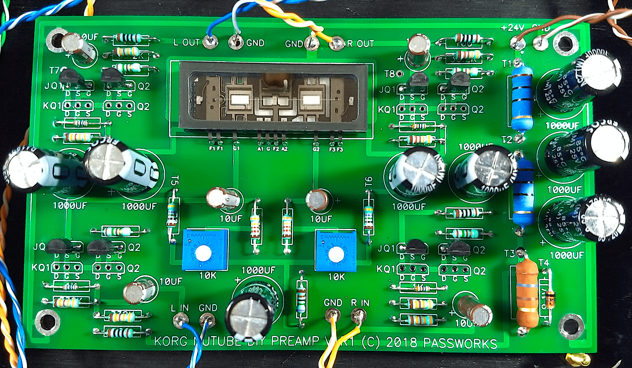

Haven't got the eagle's eyes (and patience) some here have... But in a very general way if it would be me I would defo reflow all wires to board connections - they don't look great.
Or at least use your meter to check continuity with the next part...

@ClaudeG Continuity is good. I have the pot partially disconnected to flip the board.

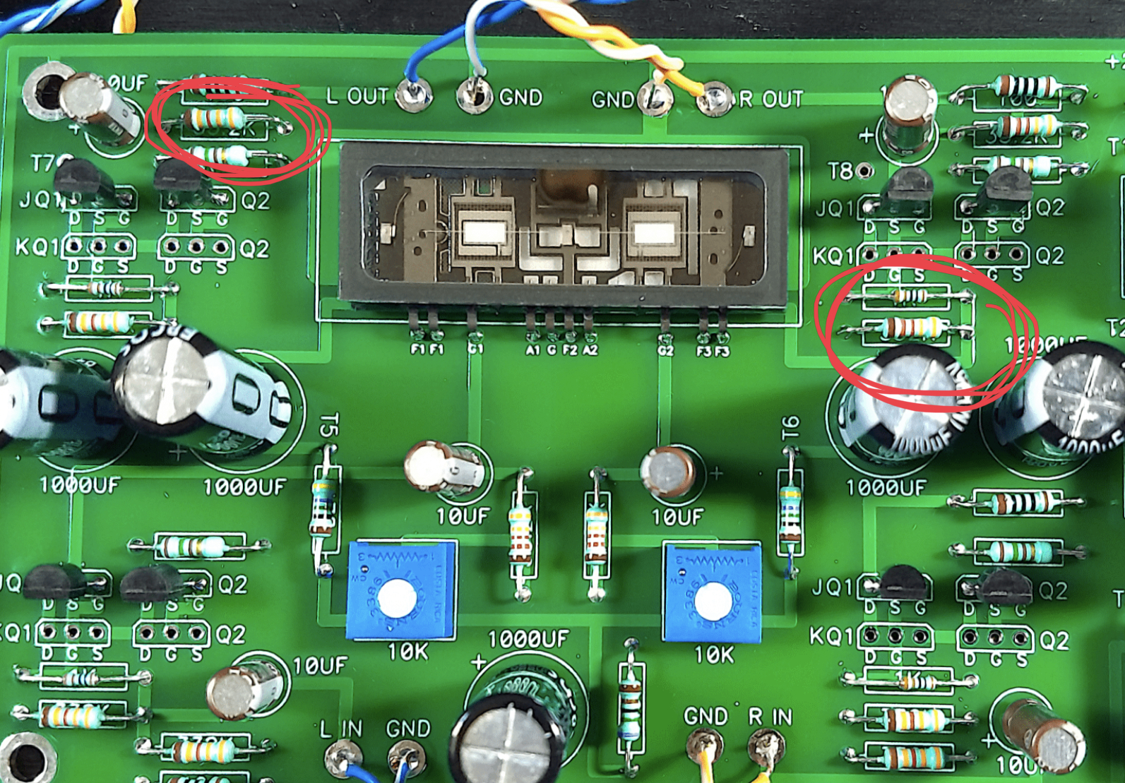

@6L6 Thank you! I'm gonna put a magnifier on my magnifier and swap those and check the other 332s. This is the same issue the guy had in the video or blog post I looked at but couldn't find. I'll post back when I complete this.
The eagle eyes of a pilot. Great catch, Jim. 33.2k in place of 332k as load resistor will screw up the voltages.

First, thanks to @6L6 @Ben Mah and the others who strained their eyes to no avail, as I did. Upshot, reversed the two 332 family resistors and like magic, all's good. It's running now. The only microphonics I hear happen on on the selector switch. Wouldn't mod anything to isolate the tube. I have the double stick tape peeled and stuck on both sides. The pre will go in a setup where I currently use only a pot for volume control. So I think it will have a different sound. I'll let you know what I think at some point.You can zoom into photos REALLY BIG on an iPad…
Let me point out how I made the mistake. I can't see color codes too well and I do use a magnifier on everything, but since I don't trust my eyes like I trust my ears, I measured all the resistors as 6L6's guide directs. No problem there. Then I make groups and label them with tape. So where's the problem? Just plain picked out of the wrong pile.
