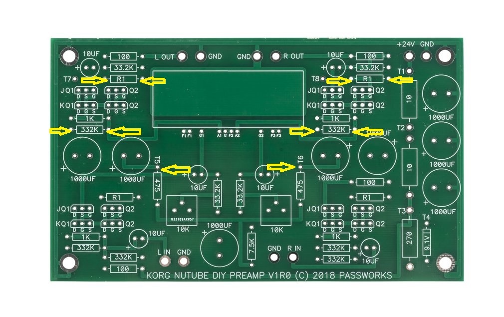

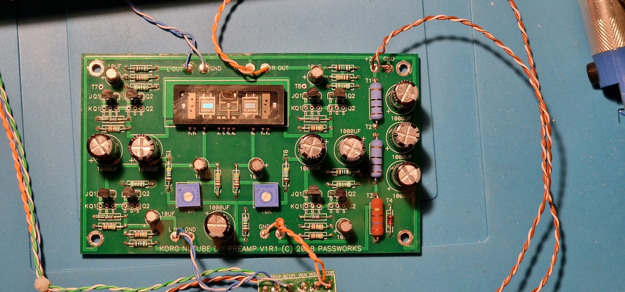

So im wondering if i damaged my triode. When soldering everything i was really careful and tried to think of everything. The last thing i did was to connect the outputs and start up the amp. When measuring t7 everything was dandy, but t8 went up and down in voltage. tried to leave it for 15 so min hoping it would settle down (ive biult the whammy and dont know so much about amps), when i came back to measure still same problem. I disconnected everything and went on to check everything out to see if i made a misstake somewhere. Well i had forgotten to cut the cables for the output so the were shorted against the chassi. I then cut them and started up the amp again. Ok the left channel, stable and nice. The right channel (T8) had a voltage about 3 and when maxing the potentiometer it was only 4.0 to 4.8 jumping up and down. So ive checked and doublechecked my soldering my placement of the resistors and if anything is burnt. Nothing can be found. So is it possible i damged anything? like maybe the korg or a capacitor or even one of the transistors? I dont know where to begin looking and how to go about.
Any help would be appreciated.
I am not sure what you mean by "cut the cables for the output".
Please take clear and focused pictures of both sides of the board.
But before doing that, please measure the voltage drop across the resistors marked and also at T5, T6.
Also look closely and compare the resistors on the right channel to the corresponding resistors on the left channel to check for discrepancies.

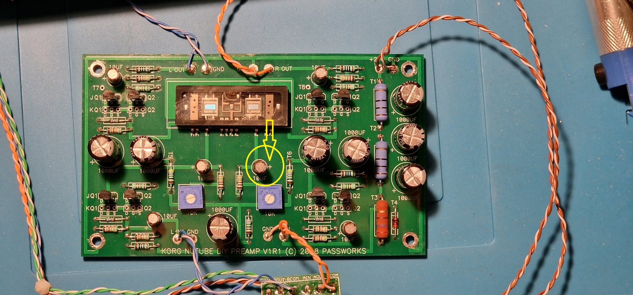

A few days ago, for some reason (brain fog caused by alignment of planets?), I started to fiddle with a properly measuring and functioning B1 with Korg Nutube DIY Preamp (from the store) which I built a few years ago. Long story short, I decided to read the current running through the 475R resistor at T5, switched my DMM to read mA (yes, I know) , touched either side of the resistor with the probes and poof, the channel is blown. One side of the Nutube stops glowing and music stops on that channel. I measure some voltages at the test points and across R1, which I do not write down, and immediately decide that I have blown a channel on the Nutube triode. I proceed to desolder it with the intention of replacing it.

The 475R resistor sets the voltage to the Nutube filament. It sounds like you shorted the resistor and sent too much voltage to the filament and toasted it.
So if it was working before but not working now, the Nutube filament is gone. I don't think anything else would be damaged.
That's what I guessed as well. Thanks.The 475R resistor sets the voltage to the Nutube filament. It sounds like you shorted the resistor and sent too much voltage to the filament and toasted it.
When measuring voltage drop i just measure voltage by connecting black from dmm to ground and red to each side of resistor right? And then compare voltage to see how much the voltage drop is?I am not sure what you mean by "cut the cables for the output".
To measure the voltage drop across a resistor place the black probe on one side of the resistor and the red probe on the other side of the resistor. The voltage shown on the meter is the voltage drop across the resistor. No calculation needed. Your way will also work but it takes two measurements and a calculation.
For the voltage at T5 and T6, red probe at T5 and black probe at ground, repeat at T6.

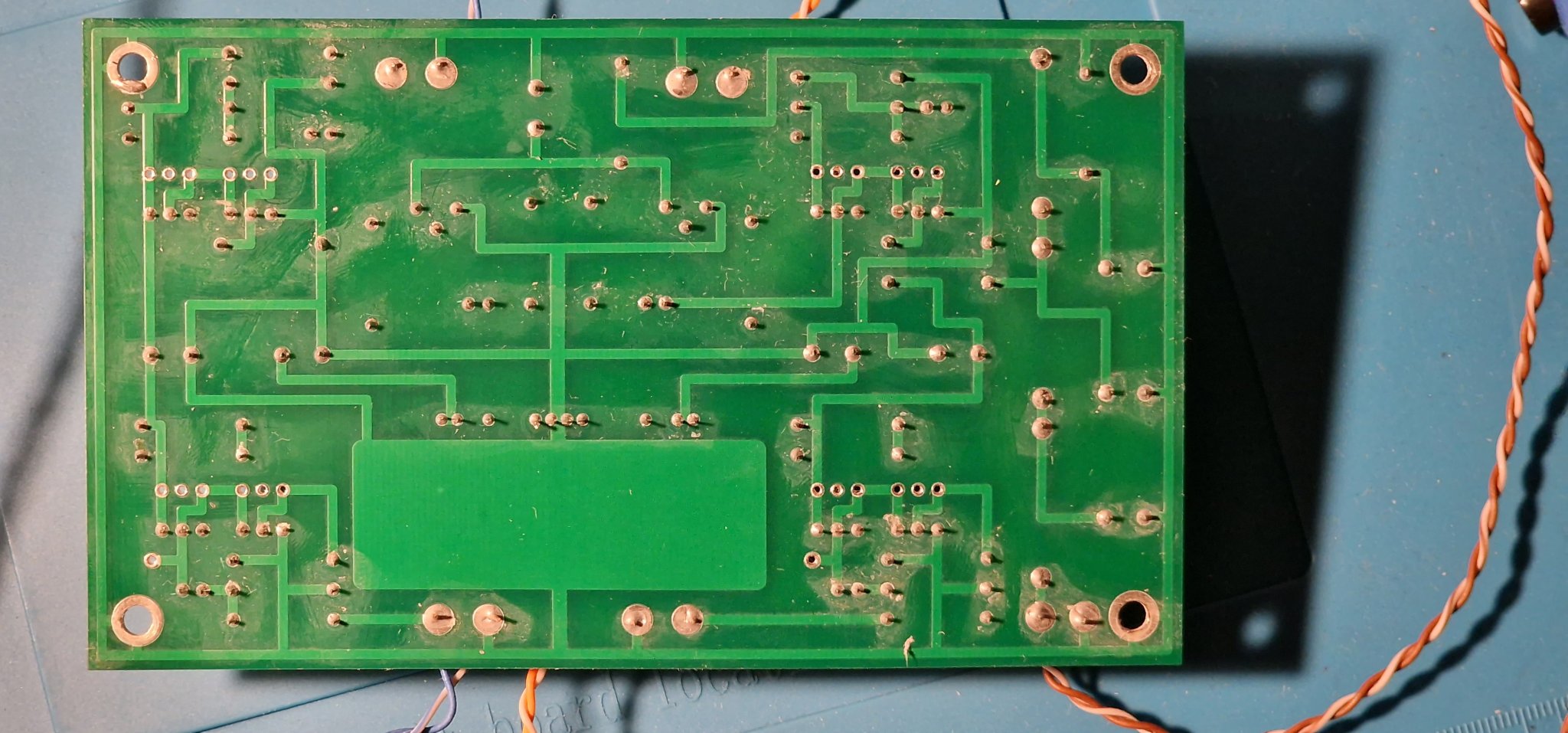

So ive measured and taken some pictures. The underside is a little dirty because my attempts to clean it before the picture was really bad. Im gonna se if i can buy som solderflux cleaner.
Measurements:
R1= L channel (good channel) 1.4072V, R channel (bad channel) 1.3686V
332K= L channel (good channel)1.383V, R channel (bad channel) 16.660V - 16.705V (jumping around)
T5 = 0.6270V
T6= 0.6739V
Measurements:
T5 = 0.6270V
T6= 0.6739V
So I've measured and taken some pictures. The underside is a little dirty because my attempts to clean it before the picture was really bad. Im gonna se if i can buy som solderflux cleaner.
Cleaning with rubbing alcohol and a soft bristle toothbrush then patting dry with an absorbent cloth works well for me.
Dammit. So bad thank you ill test changingCapacitor placed incorrectly - polarity reversed:
By the way, the 1.383V is probably 13.83V. Must be a typo, or you misread your meter. Not to worry.................
Measurements:
T5 = 0.6270V
T6= 0.6739V
