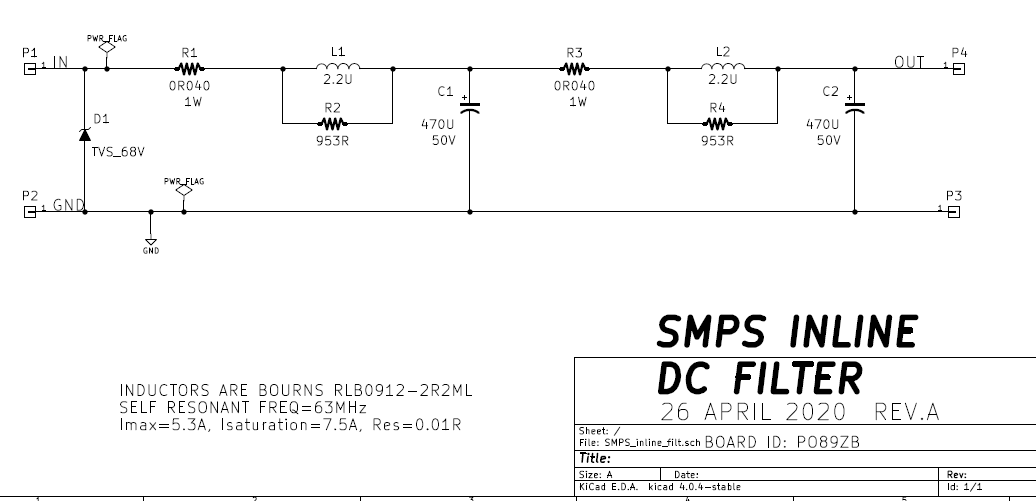

I am not a SMPS fan, but had to admit that Papa got it 100% right.
To my ears, the SMPS + CRCRC filter wasn't bettered by a big (50x its size) quality regulated lab supply I use only on my bench. I prefered Papa's rec, it scored everywhere better except perhaps in the bass. And I tried hard to convince myself it couldn't be 🙂
I use now an even lower ripple SMPS of the same make, Mark's excellent SMPS filter and 2200uF caps instead of the 1000uF. All this brought very little but noticeable improvements. Diminishing returns though, more a play to hear how far it would go. I reached a point where I don't think any other PS would really make an audible difference on that set up - I call it a day.
Bottom line: go for Papa's recommandation and, if you like to play, enhence it somewhat - job done. In that particular case it really works great without any drawback IMHO.
I hope it helps
Claude
I agree. If people are interested, I'd be happy to support a run of Mark's board as I personally have been looking into getting some myself. There is plenty of room in the B1-K chassis to stick one in right at the DC power inlet point so it would be an easy mod to the existing kit/project.
--Tom
Kind of you, that filter really deserves it and is no brainer. One of these is permanent now in my B1K...
Thanks and well done
Claude
Claude
Discussion thread including PCB Gerber file downloads: PO89ZB , an inline DC filter for SMPS wall warts . Preamps, HPA, Korg NuTube, etc

I'd love two PCBs
--Tom

I'd be interested in four boards. Have one I am trying out now.
