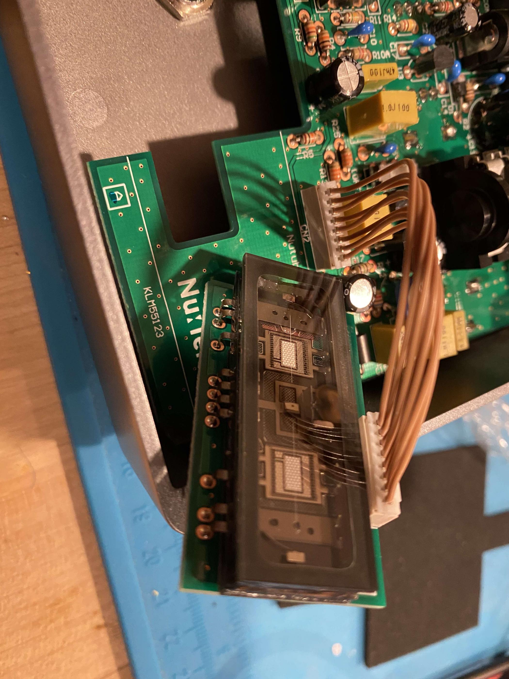

Hi, hade same problem.
I dont know if you have the nutube in a chassie or not.
But I have mine still in a cardbox ( chassie almost done ), just after a litle time I get the (5000Hz) ringing, get louder and louder. Addjust volume dont help.
After I just put my chassie ( missing backplate and top-plate )up side down over my cardbox. No problem, so a good shelded chassi is a must I think.

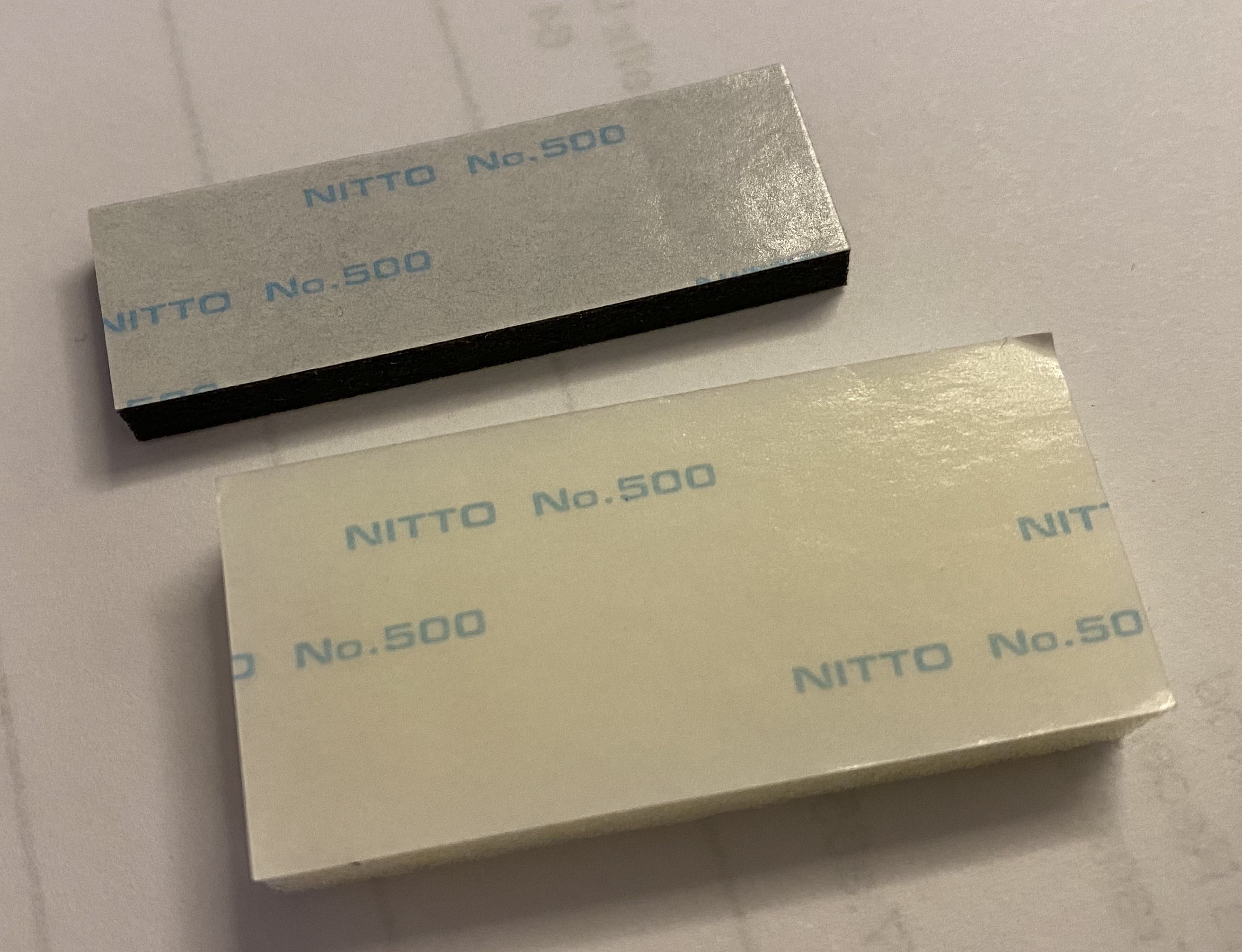

I wanted to follow up on this post. I recently purchased a Nu:Tek Nutube overdrive guitar pedal that is built with the NuTube. Interestingly enough the way they do microphonic isolation is to completely isolate the Nutube from the main circuit board by putting it on its own little board and connected it via a wiring harness. That sub board is then padded both on its underside and on top of the NuTube itself with Nitto No. 500 double-stick foam adhesive pads which you can find here:
https://www.nitto.com/us/en/others/products/file/datasheet/NJ_No.500_No500A_No500AB_EN.pdf
A quick search on Amazon and you find similar products which are essentially weather stripping tape, like the kind you use to seal windows and doors and as you see, this stuff is super inexpensive:
https://www.amazon.com/Adhesive-Wea...foam+self+adhesive+tape&qid=1611003350&sr=8-7
I'd recommend that if there are subsequent runs of the kit, that a couple of pieces of these be included. They are cheap enough and removed all of the microphonic issues I had. The only downside is that it is a shame covering up the cool blue glow from the NuTube.

After looking around at available materials, I first tried using liquid silicone to "glue" a few neoprene washers cut in half, under the NuTube. That had almost no effect on the feedback or hum. Back to the bench.
Next I tried Jim's suggestion of a latex eraser taped above the NuTube. This definitely dampened the high-frequency microphonics but did nothing for the hum. It also would feedback a little when the volume was up past about 9 o'clock. Back to the bench...
The previous week I'd looked at a few guitar pedals that were being made with the NuTube like the Ibanez NuTube Screamer. It turns out NuTube make a kit form of a similar overdrive pedal, so I reviewed the build guide and viola. They tape some thick neoprene onto both sides.
I didn't have any neoprene tape so I looked around at available materials and realized that making a mold on top of the NuTube and filling it with liquid silicone would have the same effect - and if not, I could easily peel it off. It tuns out my creativity was rewarded in that not only did the microphonics disappear at listening levels as loud as I could muster, but the hum disappeared too!
The basic idea of what I did was get some painter's tape and made a box around the NuTube, and then just filled it up. Once it dried, I peeled the tape off and went off listening. It was that simple. The only caveat here is that the sticky side of the painter's tape still stuck a bit to the silicone, so next time I'd either add some kind of oil to the top part of the tape that touches the silicone, or just put another layer of tape over that.

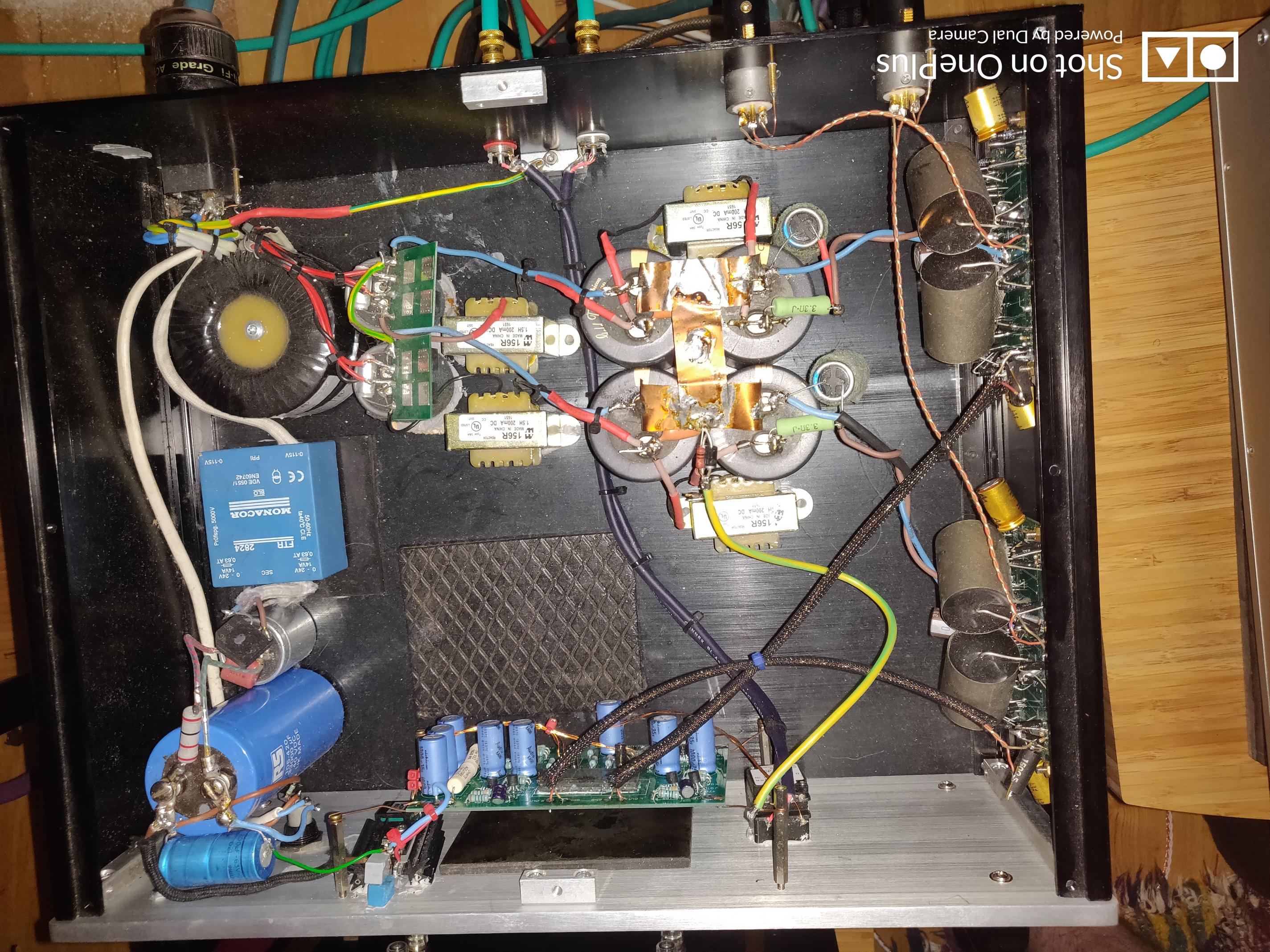

But then I decided to make my own version. I mounted the NUTUBE on an aluminum plate and decoupled it with rubber grommets from the 10mm frontplate. I soldered the wires ( a few cm long) from the NUTUBE directly to the B1 NUTUBE-pcb (my post # 1908 in this thread)
I never had those ringing problems described by many members here!

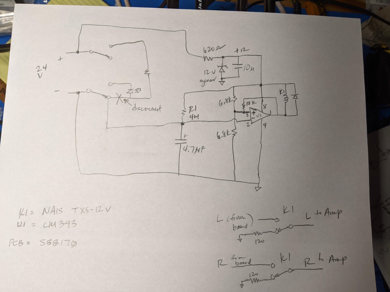

Apologies up-front for the poor hand-drawn schematic and lousy picture.

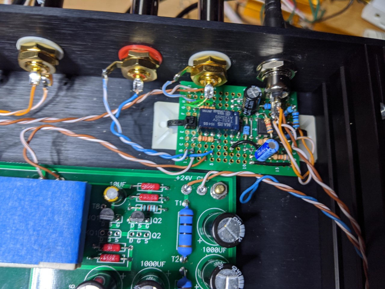

The switch shown on the left of the schematic is the power switch for the B1K. I had to remove the led/resistor junction as I needed that switch connection.
My circuit is constantly powered but might work OK with switched power?
The relay I had was a 12V unit so I made a 12V supply with a zener and resistor. Maybe could have just put a series resistor with the relay coil and used 24V. The comparator can handle 24V.
With the B1K off, the 4.7uF is shorted, keeping U1pin2 at 0V. The relay will not energize so the amp inputs are shunted to ground thru 120 ohm resistors.
When the B1K is turned on, my 4.7uF charges slowly thru the 4M resistor. At about 16 seconds, the comparator flips, energizing the relay and connecting the B1K outs to the amp inputs.
The 18K resistor provides some hysteresis.
This proto got a bit sloppy. I had used a 1M in series with 560k (not shown) to charge the cap. This gave about 6 seconds of delay. Insufficient. I replaced the 560K with 3 1Mohm to give a total of 4 Mohm. The delay is about 4 seconds /1Mohm.
The LM393 is a dual comparator. I'm going to use the other side to energize a red LED that will indicate when the output is disconnected and waiting for the delay. I also will likely add a "mute" switch that de-energizes the relay.
Eventually the 4.7uF gets charged up to 12V. It gets shorted when the B1K is turned off. It probably does not enjoy this. A smallish series resistor between the switch and the 4.7uF would be better.
The relay I had uses about 4mA. The LM393 can drive this directly.
When the relay energizes, the triode picks that up and I get a little "ting" in the right output .... not bad. I need to work on my microphonics anyway as the eraser fix didn't help me much.

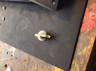

One of my RCA jacks has a loose positive (signal) post (on the wiring side of the jack). I don’t see a way to tighten it. Is it defective or can I snug it up? It doesn’t look outwardly any different that the rest, but the post wobbles a bit.
