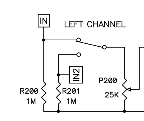

@ Rtate
On B1 passive schematic they are 1M , 1/4 watt resistors
