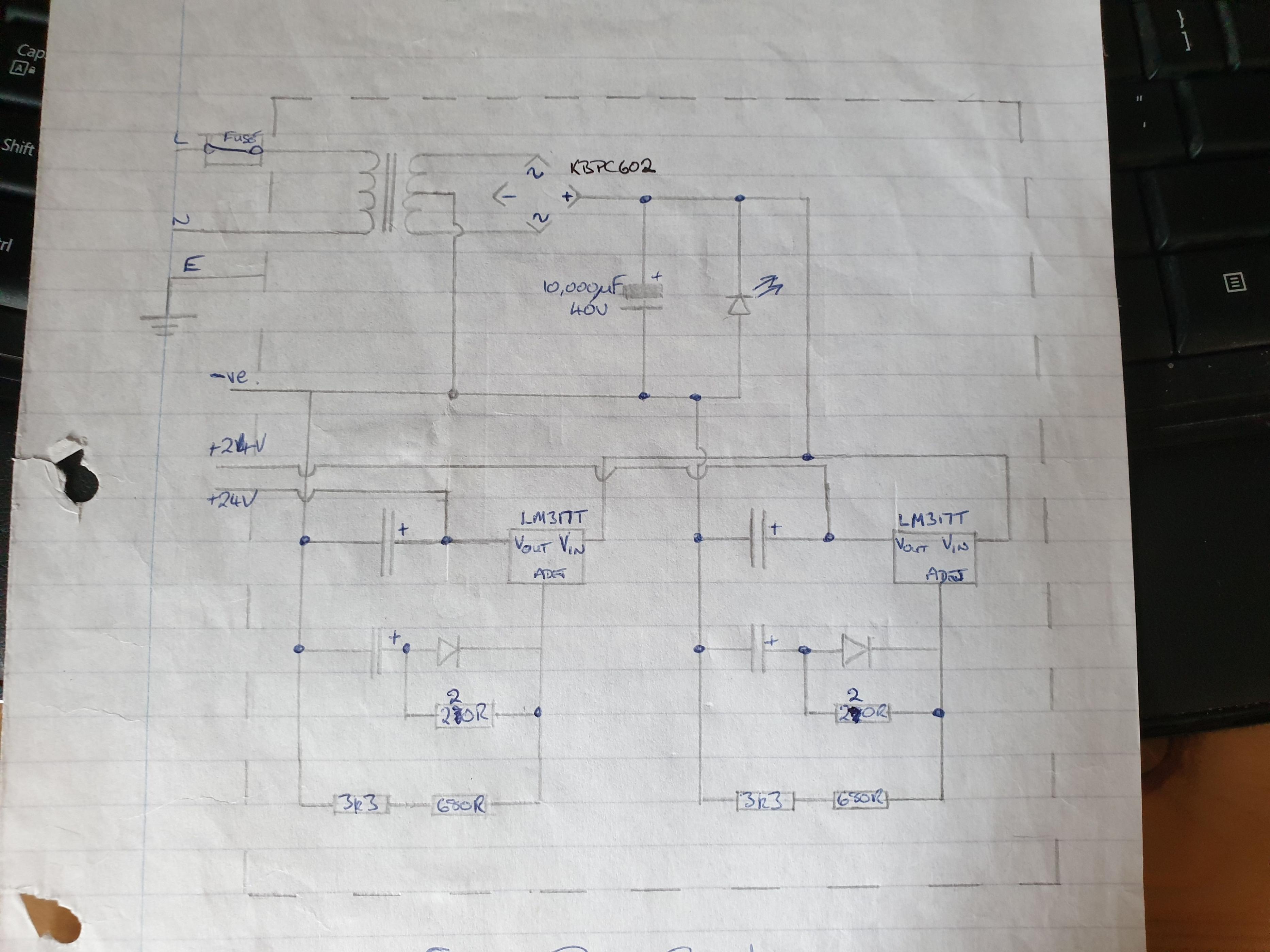

Your powersupply should work. The B1 - Nutube - pre needs around 60mA of current. Most important is at start-up, till the caps are loaded.
Check copy from Nelson Pass' B1-NUTUBE- article:
The power source is a “wall wart” type external supply, providing regulated 24V and rated at 0.50 Amps current. The preamp will draw about 60 mA in operation, although the extra current rating of the switching supply gives us the initial current to charge the filter capacitors at turn-on. As some switchers have protection which prevents the charging of the caps, it is important to test the specific power supply with the circuit. The specified Triad supply meets this requirement, and is cheap and fairly quiet.

300mA are rather on the thin side... sure it is not more?
Claude
I would think it is. The transformer looks big enough to power a small power amp. I've attached a schematic I drew up quite a while ago. The capacitors in the regulator circuit are 10uF/35V tantalum. The diodes are UF4006.
cubicincher - Thanks for the reference to NP's article. I can't see that there will be problem using the SNAPS based on that.

If the transformer is that big, it should all be fine.

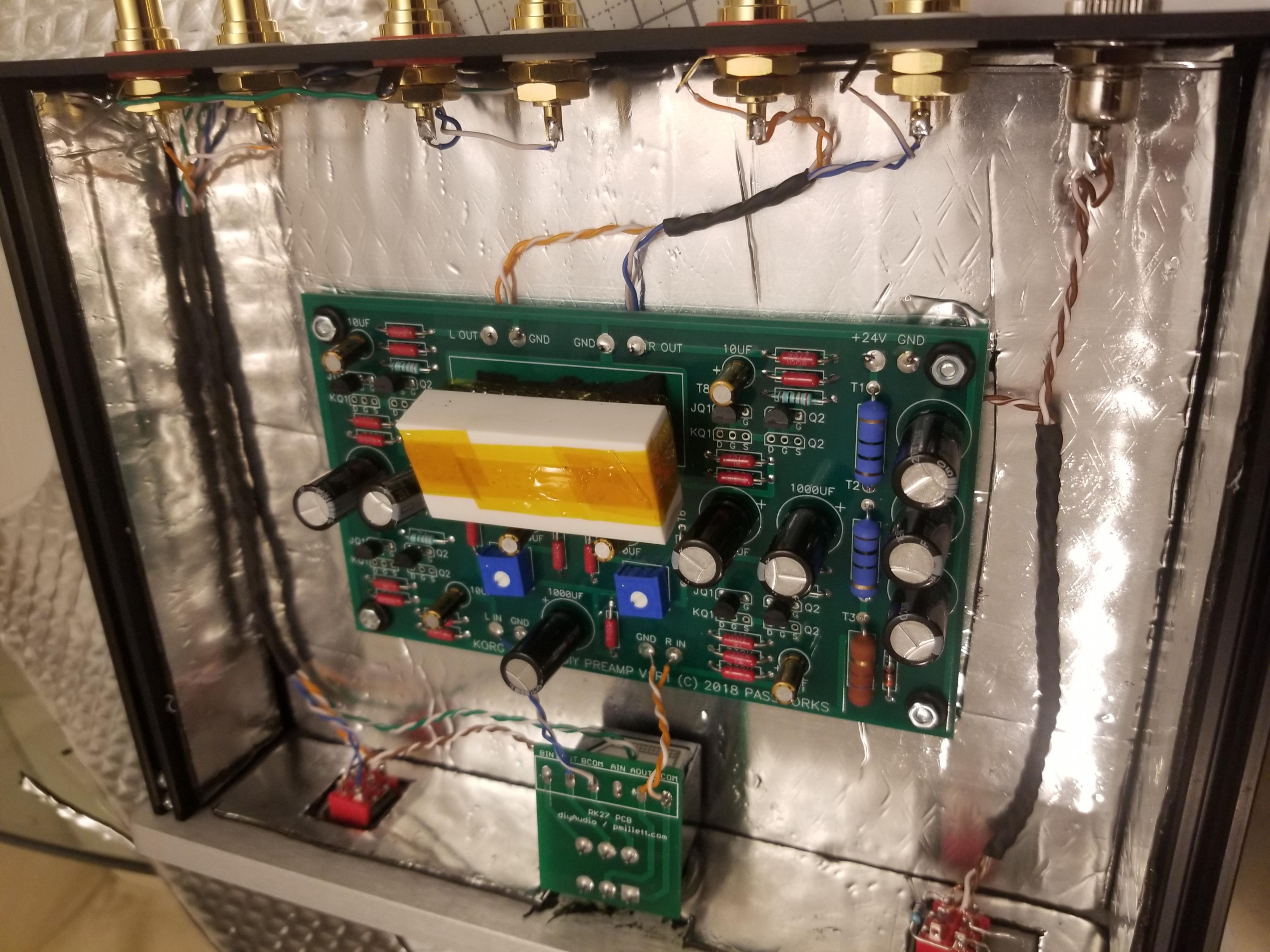

Just finished the B1 and had a couple questions regarding the microphonics. I lined the bottom and sides of the case with Noico, then put a 3x5 inch rectangle on the top panel. Will this cause any overheating? I was most worried about the top piece. I assume the nutube doesn't get too hot since people put erasers on it, but I wasn't sure about the rest of the components.
@ SonnyMarrowJust finished the B1 and had a couple questions regarding the microphonics. I lined the bottom and sides of the case with Noico, then put a 3x5 inch rectangle on the top panel. Will this cause any overheating? I was most worried about the top piece. I assume the nutube doesn't get too hot since people put erasers on it, but I wasn't sure about the rest of the components.

In my build the only little hot component are 270R power resistor
all others passive components and active ones:
jfets and Nutube stay cold after many hours of music session.
No worry nothing be overheating.
After voltages tests preamp does the best sound with sealed enclosure.
Have a nice day 🙂

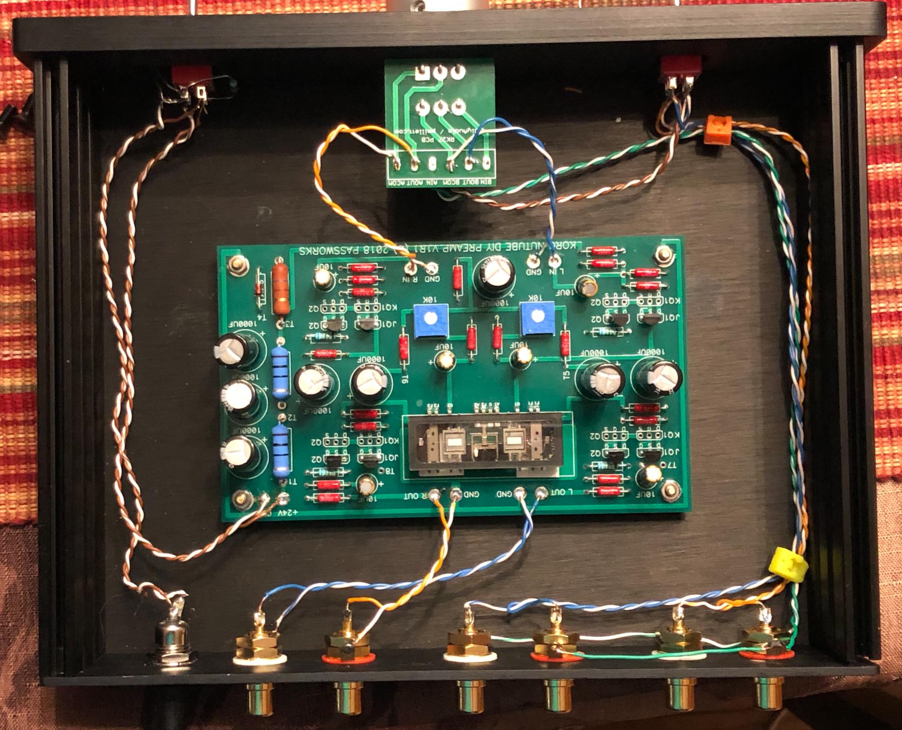

I would like to point out again that the diagram of Papa and the PCB of Diy-Audiostore are different.
Question whether this is relevant?
Thank you.
Hi, I noticed that, too. (Thus my visit to this thread.)
Short answer is that it shouldn't matter. This is based my rather limited electronics knowledge. Transistor Q2 forms a current source. The 1K resistor looks like it serves the same purpose as a grid stop resistor. So, maybe it is actually better placed on the PCB?
Maybe someone else with more knowledge can explain?

No danger of overheating from that. Only danger is when cathodes are orange,
with or without insulation.
