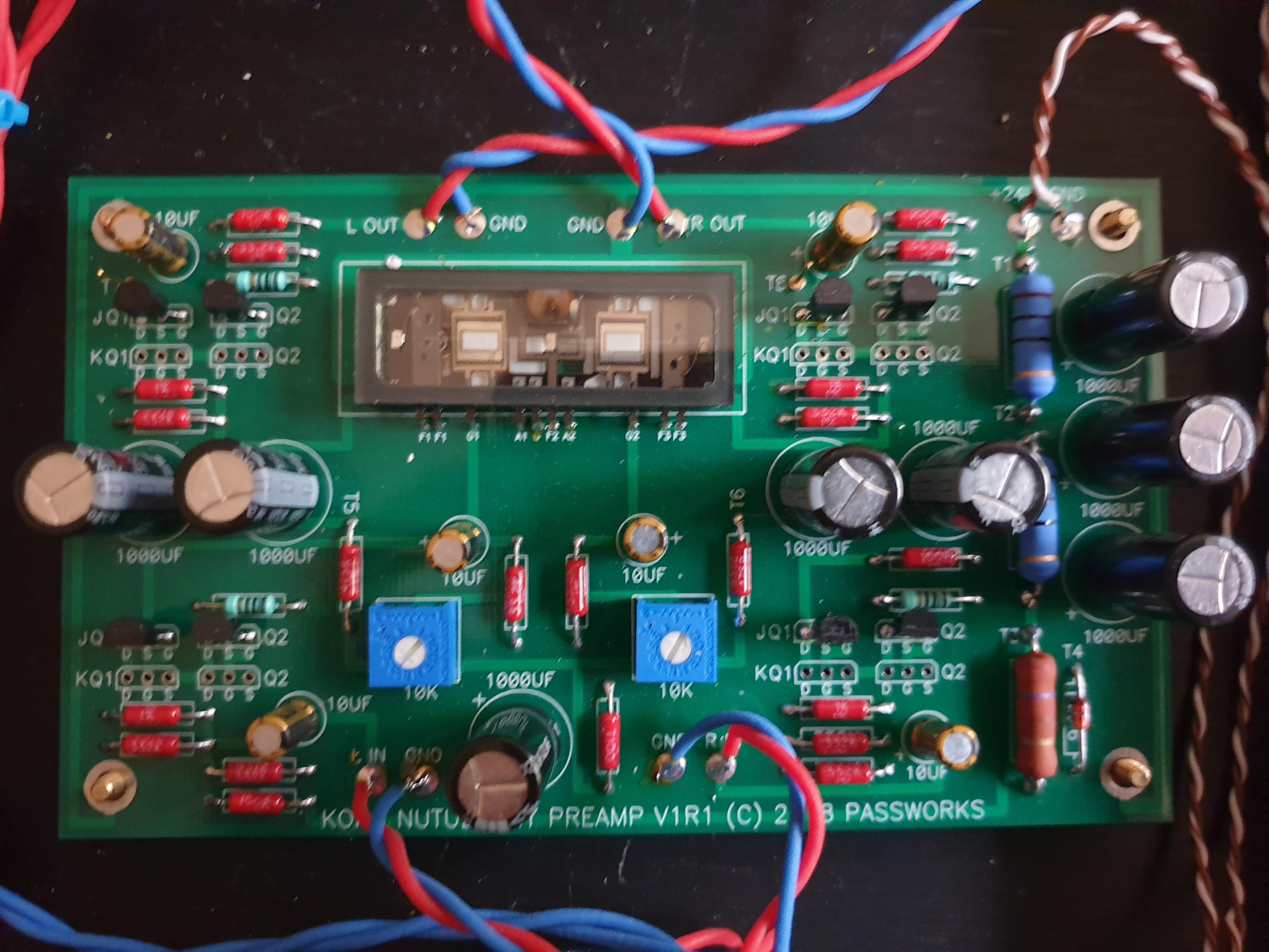

Switched on this morning and no magic smoke, so a good beginning.
All test points from T1 to T7 reading as they should and a nice glow from the left side heater. The right side illuminates initially and then dims after a moment. The voltage on T8 at the mid-position on the right hand pot is 3.3V. If I turn that pot fully anticlockwise, the value at T8 is 7V at best. The heater glow increases with T8 voltage but still doesn't match the brightness of the left hand one.
I've lifted the board and rechecked all the joints, which were all checked during the initial assembly. I reflowed several which were probably okay anyway, just in case. Same results on powering up after this.
I also checked all resistors before insertion and have rechecked their positions this morning. Everything is in the right place.
HELP!
Or more politely, any suggestions as to the possible cause please?

+1 on Sharp eyes Soundhappy
The one on top of your blue adj pot, right side... not sure the only cause but at least a prob

Speaking of the blue trim pots, the build guide does not reference any adjustments.
Check the .pdf by Mr Pass in the first post.
Look at 10 uF cap in the center right side have reverse polarisation 🙂
Many thanks to you, Soundhappy. You do indeed have sharp eyes. Having sent the image from my 'phone, I hadn't realised how shakey it was. I completely misssed that. Item turned the right way round and voltages and heater glow matching now.
I am very, very grateful to you.
Time to let it warm up, settle down and hopefully I'll hear some music later today!
