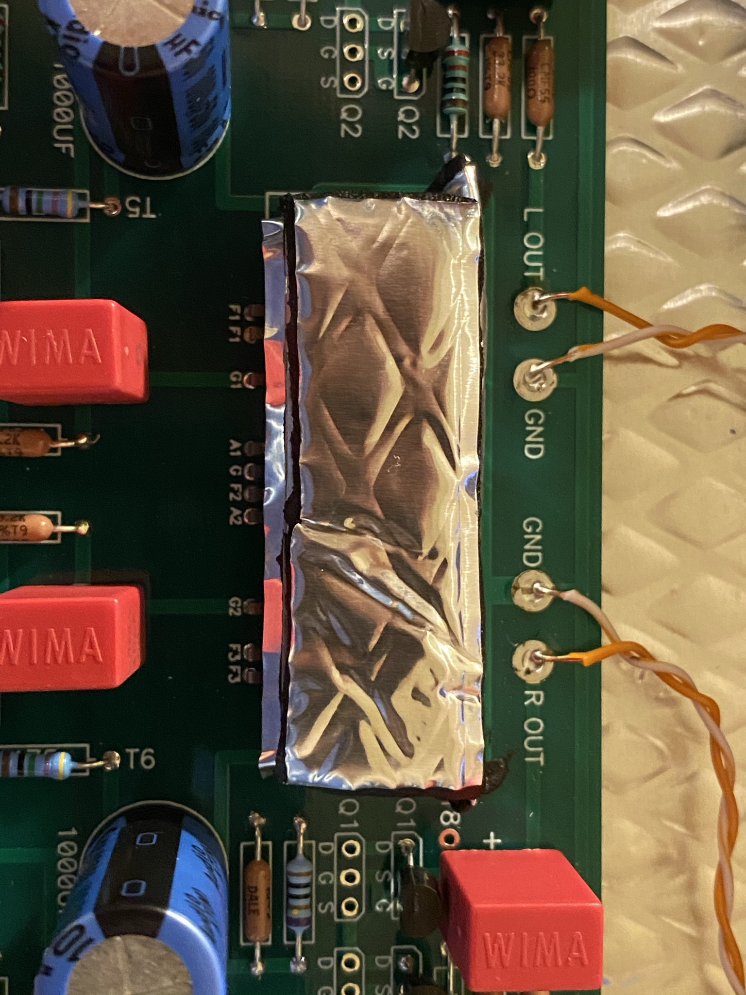

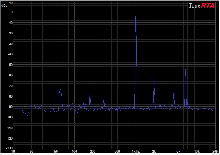

I completed my kit this past weekend. First thing I noticed was that my nutube was extremely microphonic. My wife came down yelling that my music was too loud. Immediately my nutube started to ring. Once the ringing started it would keep on ringing for a long time, presumably due to mechanical feedback that sustained it.
I spent some time trying to tame the microphonic. I tried the rubber stand-offs and lining the interior chassis with noico. It only helped a little with the lid open. The biggest improvement came from wrapping the nutube with noico (I used three layers, see picture). With the lid closed (also lined with noico underneath) I think I'm now in a reasonable shape.
I suspect the ringing came from some mechanical resonance inside the nutube. The frequency of the ringing was very consistent, and was always at 6.5 KHz (sometimes I also see a 4.2 KHz peak, but the 6.5 KHz is always there, regardless of how I tapped the nutube). The second picture shows a 1 KHz signal plus its 2nd harmonic. The peaks at 4.2 KHz and 6.5 KHz came from the ringing.
