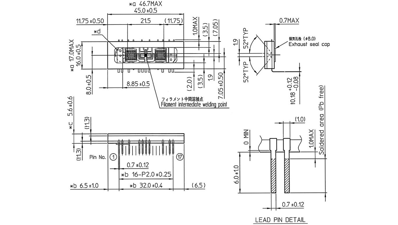

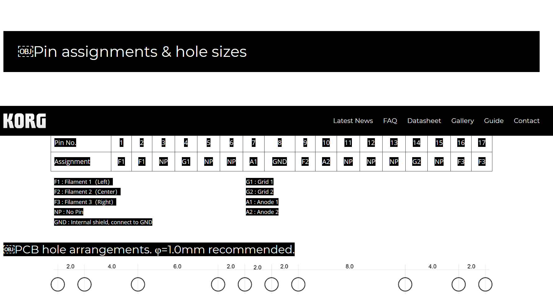

I see two pads on the diyaudio board labled "F3". What does this refer to? I bought a 6P1 Carrier PCB from nutube.us (a Pete Millett design?) so I could mount the NuTube and carrier board on my front panel (to view the glowing tube though a machined panel opening), and then run wires back to the diyaudio board. From the schematic that comes with the carrier board, it looks like this carrier board connects these "F3" points to breakout pads labeled "F2" and "FC" (filament 2, and filament common). Is the "F3" designation on the diyaudio board a mis-label? Sorry if I'm just being dense here. Not trying to be difficult.

F3 = Filament 3 (right) = Pin17 of the NUTUBE.
Sorry, I don't know the pcb from Pete Millet.
I have added parts of the datasheet of the NUTUBE.
But you only have to measure. Pin 1 from the Pete Millet board to Pin1 of the
Nelson Pass pcb; Pin 2 to Pin 2 and so on.
Check datasheet (pics below) - there are a few NP (no pin!)
I hope this helps!
