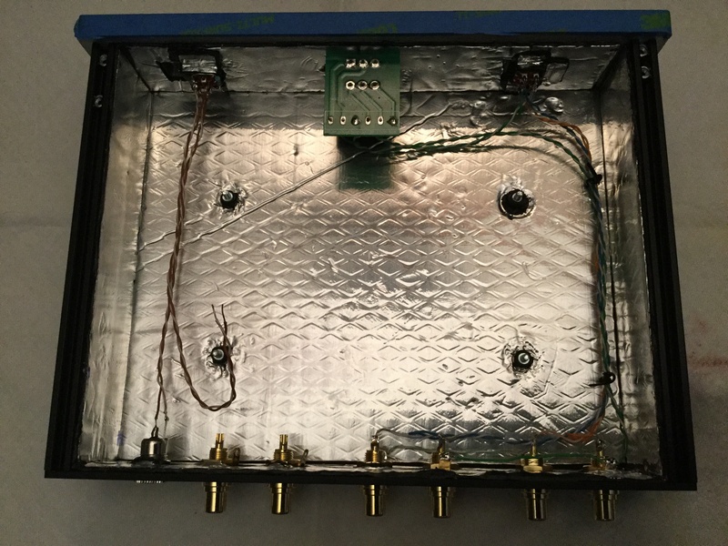

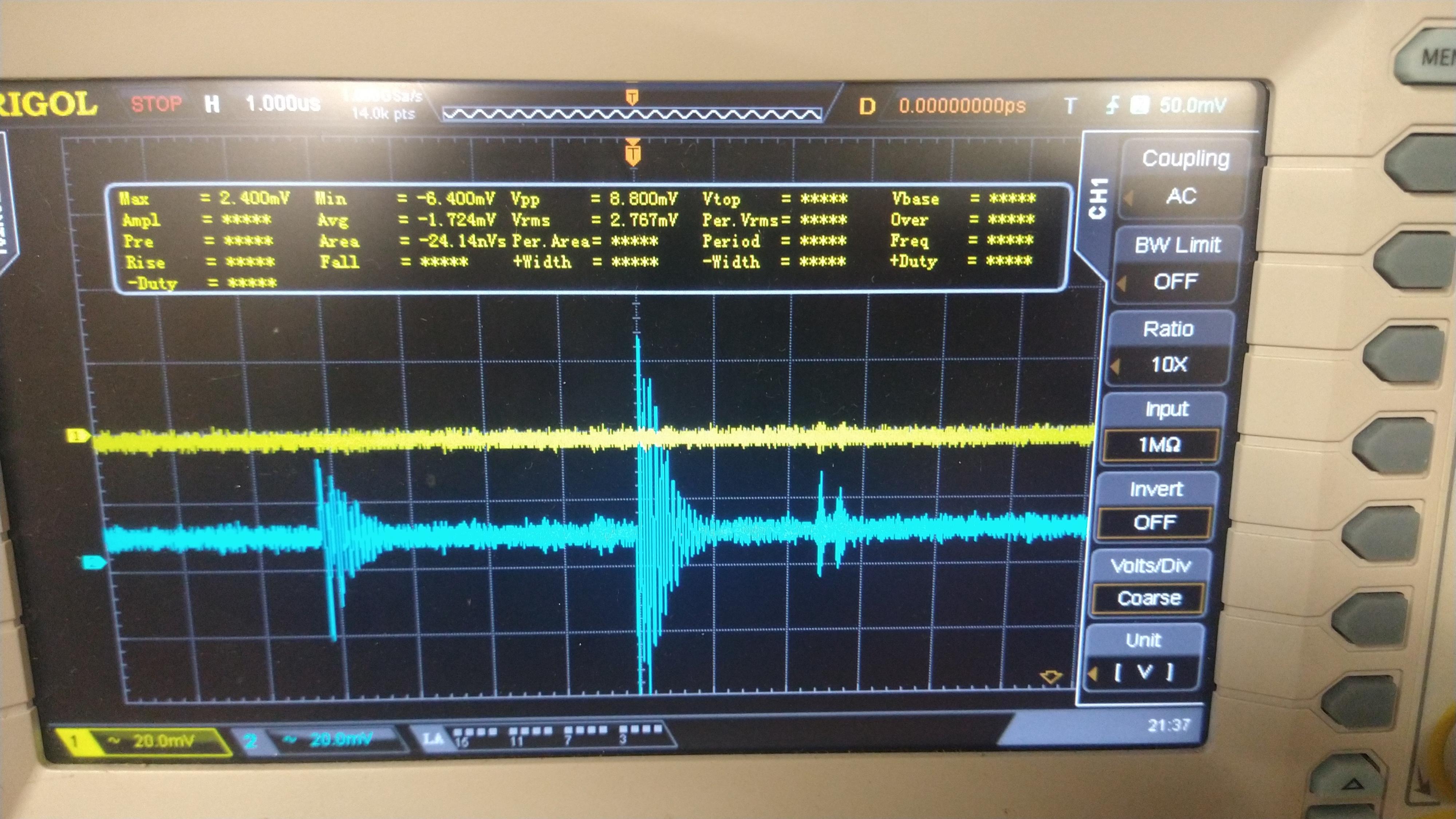

I needed all of the above to keep the tube from ringing and have no issues - there's very little heat produced to begin with.
Damping material on the face plate and floor of a sealed section of the 2mm+ aluminum plate chassis. Damping material blue-tac'd to the face of the tube. The M3 rubber mounts were quite helpful, too. Now the only time it rings is when snapping the power or source toggle switch, which channels an impulsive sound across the face plate.

I installed a DC regulator inside my chassis, with the mosfets attached to the chassis floor. This makes the bottom of the chassis mildly warm, about body temp. Still plenty safe to install damping material in this case. Vent holes are not necessary at all.
You could try mounting on daughter pcb and clamp it with thick acrylic
My friend just glued it with viscoelastic tape no issue as well. But he did mention the rigidity of the casing matters . He machinesd a nice thick top cover for the casing
Using rubber mounts between the chassis and the PCB reduced my NuTube ringing by 15dB. A year ago, these were $2.20/set of 4. The price has gone up since, but still a good buy:

I've done some work to help with the microphonics issue. I lined the chassis with Noico 80 mat, and used rubber standoffs to mount the PCB. The mat seems very effective.

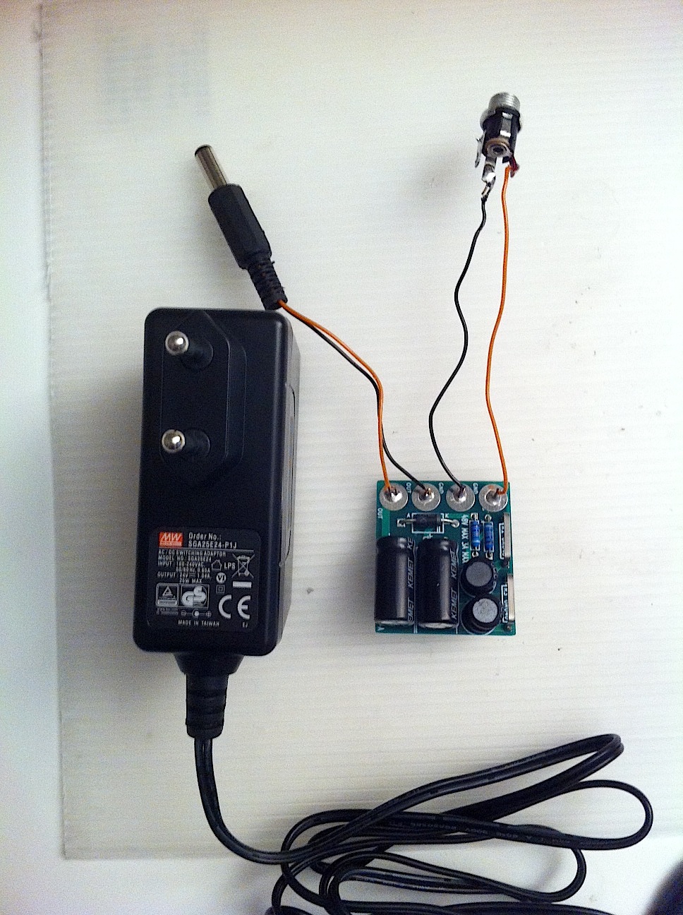

PO89ZB , an inline DC filter for SMPS wall warts . Preamps, HPA, Korg NuTube, etc
Given Mark’s reputation and excellent projects, I gave it (of course) a try. In fact several tries as I built 2 of them.
Just to discard one variable, in all my various tests both filters I built sounded identical and this consistency is a credit to its design as that applied with different SMPS for different units.
My B1 Korg is a bit special as it has a low ripple quality SMPS, already an excellent filtering courtesy of M. Pass and on top the PS caps have been doubled in capacity to enhence further the original filtering with some further minor positive effect.
I didn’t expect this filter to make any improvement here, given the unit sounds already excellent to me and different PS (such as linear regulated etc.) brought a slightly different caracter (tad more bass etc.) but it was always a trade off and a matter of taste - at the end I prefered to stick to the original PS.
It is not easy to carry out comparisons with the B1 Korg. That is because a) you need it to stabilise, you can’t just switch in on and off / listen on the fly, so you need a lot of listening time and effort, but mainly because b) it is so addictive that it is very difficult to concentrate on listening impressions without being carrying away ! J
However, for me the filter worked, although… I really didn’t expect it to work at all ! Basicaly the same as when applied to a cheap chinese unit, but with a much lower amplitude, say 60% of the benefits (say +2 in my scale). It gets harder to find it out, requires careful listening, but the main outstanding figures are IMHO :

The small gain in this application is probably due to the power supply being well designed already (of course, Papa did it !), not a big step… but on the other hand it doesn’t cost a leg and it manages to enhence a device I thought already close to perfection and consistency, so every increase from there is already incredible. And the gains are somewhere the gains various PS could bring without their trade-offs, so the better.
What about me now ? Well, I will integrate this filter to the B1 Korg permanently and given its low cost and ease of built I can only think that it would be benefical to most B1 Korg owners aswell, especialy those that are not using an extra low ripple with extra caps PS : I can only think that the improvements then are going to be greater while this filter can easily be added as an external device and requires no changes / desoldering on the B1 Korg ! Easy job, easy to try, why shouldn’t you ? Of course, and as you can read on its dedicated thread, it does perform even better on normal designs using an SMPS. Thanks Mark, thanks Papa, thanks Konst !

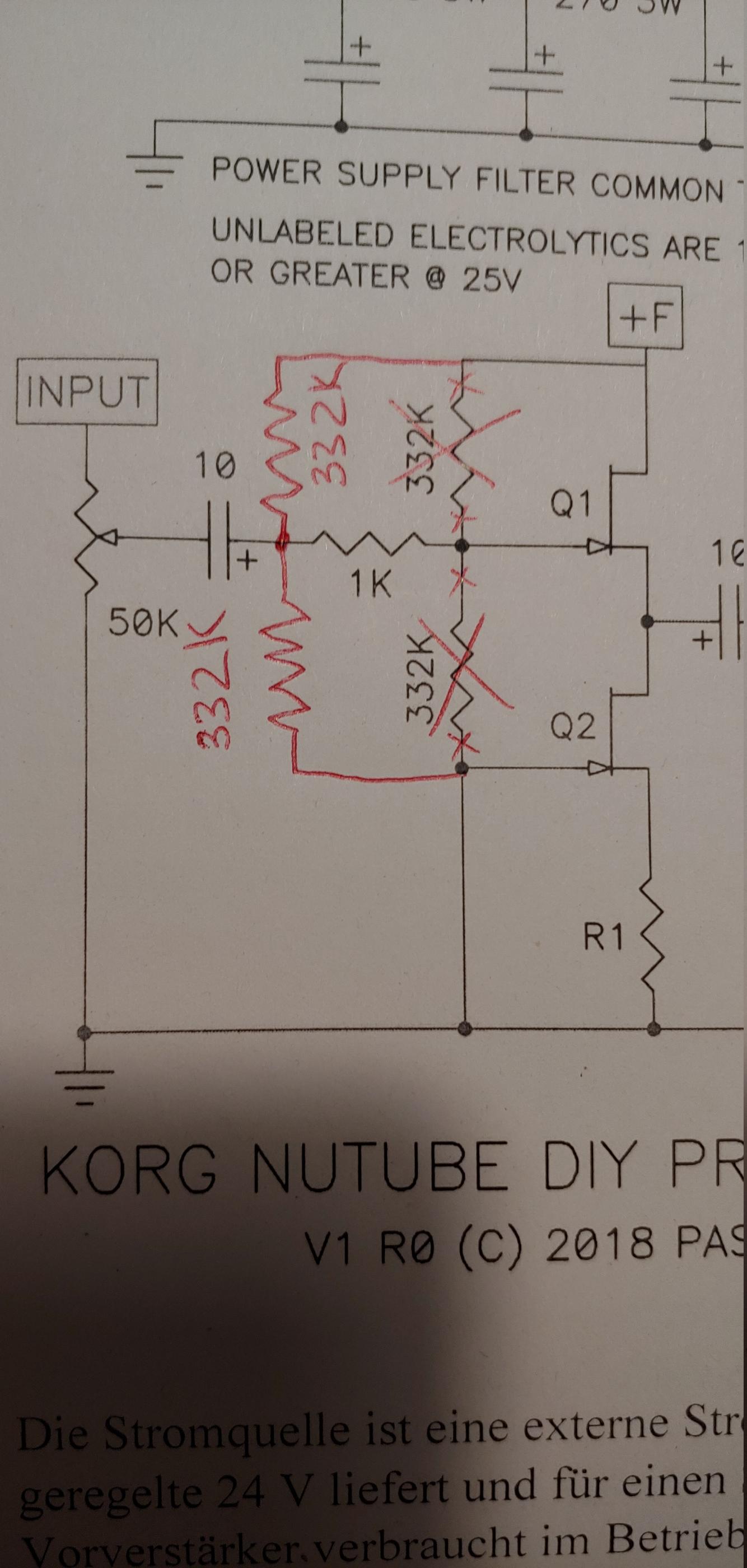

Hey everyone. I fired up my B1k on that big blue board with integrated UBiB and room for bog caps. There are two things:
1: I accidentally soldered all Q1 in reverse, fired it noticed it almost right away. Soldered in properly.
2: All values related to the tube measure fine as described in Papa's article, other things:
-- point between first to jfets before the grid cap: ~11V
-- I am running out of 10k pot and lowest T7,8 voltage I get is 14V
-- Voltage across R1 is ~1.7V
Are those number reasonable or look like I burner Q1s? If everything looks fine, why I cant get to 9.5V?

I got a bunch of resistors mixed up fixed it and still couldn't get down to below 10.4 volt - sounds fine but can't detect the tube sound at that level. Waiting on new interconnects and may get the soldering iron out after that. Perhaps 20 pot would be better?
