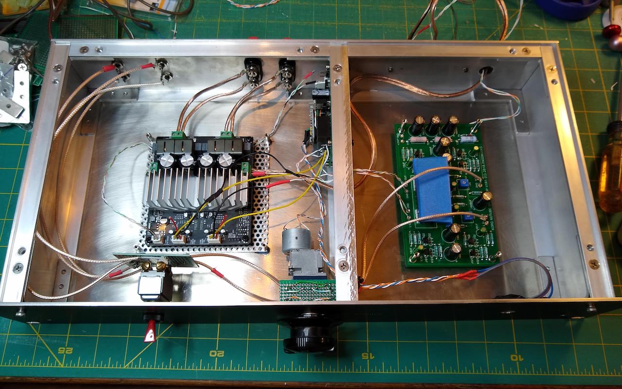

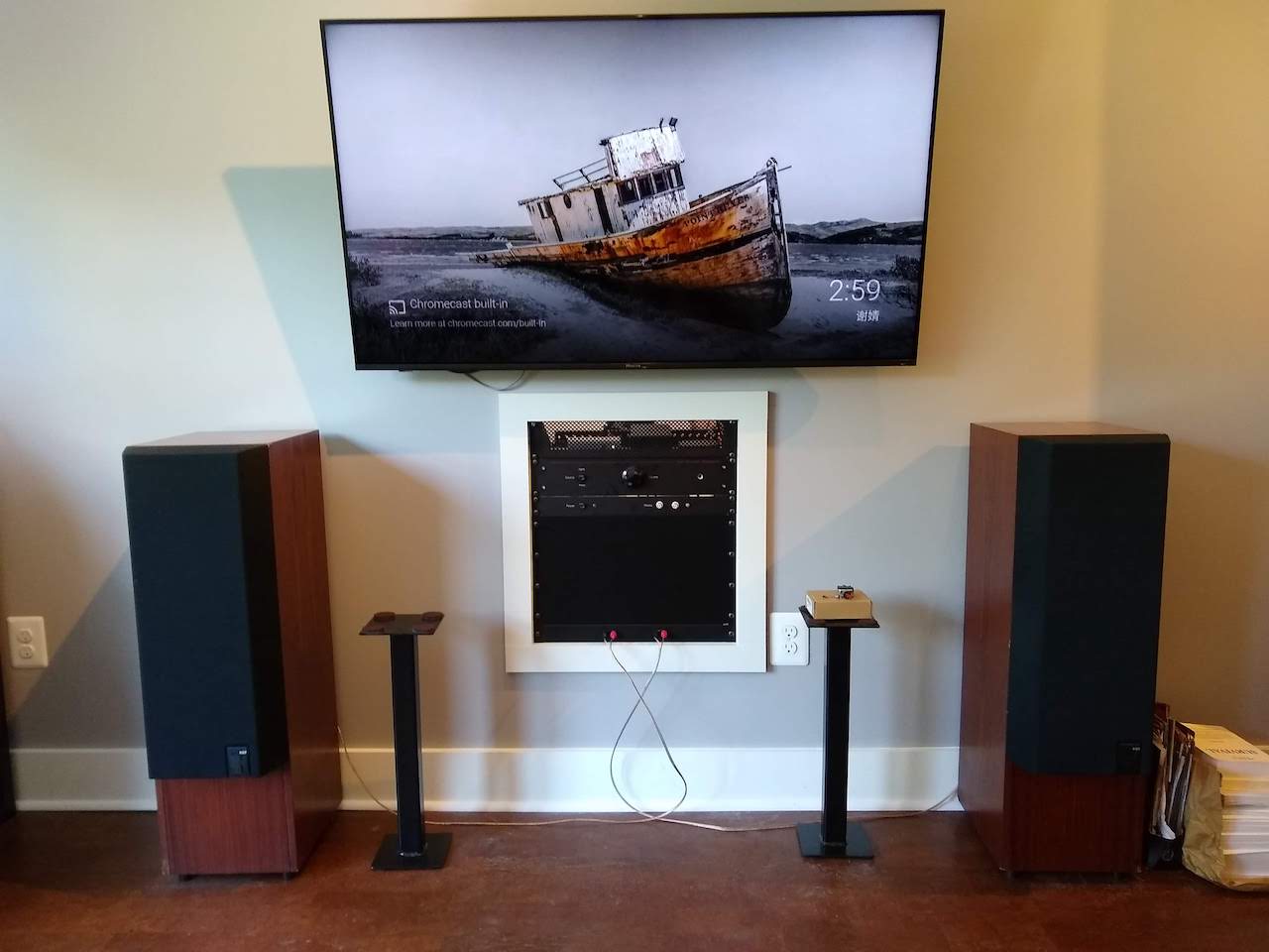

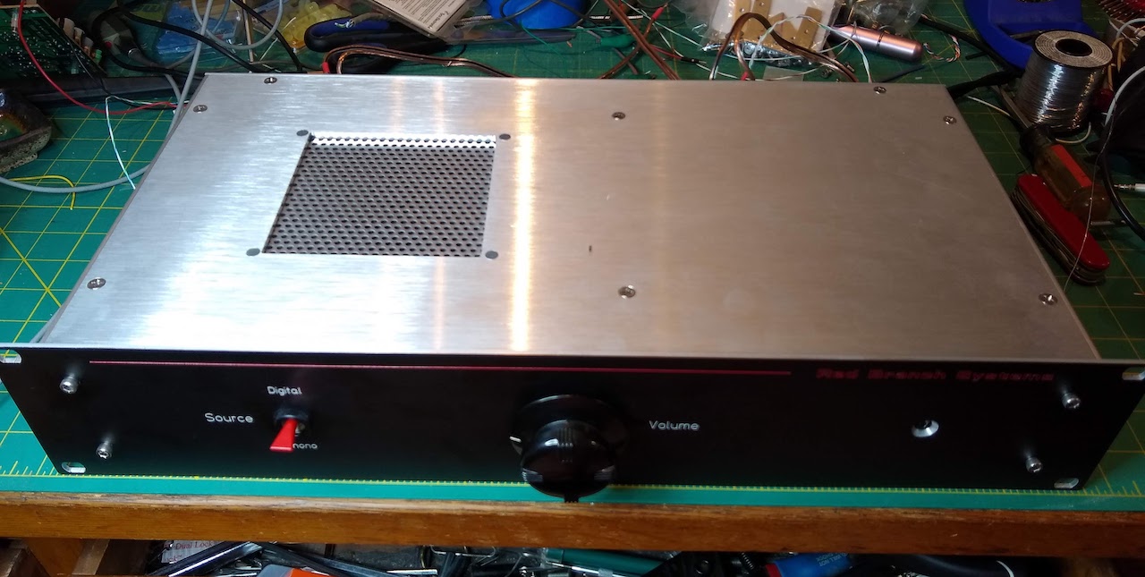

Long time reader, rare poster checking in with a completed Korg B1. This replaces a regular B1 that I've enjoyed since finding out about here 5-6 years go. The B1 caused a turnover in my stack, and the wonderful sounding Korg evolution has driven another full turnover - thanks, Nelson 🙂 !
I wasn't sure I should post a pic in the Pass board: the preamp is built into half of a Landfall chassis, and there's some digital thingie on the other side that we won't talk about. Meanwell 24V SMPS is elsewhere behind a panel on the rack.
The preamp itself was a nice and easy build, the packaging probably took 3-4 longer to work out and complete - but it was a fun puzzle and not hard given all of the advice and experience in this thread. Microphonics, for instance - lots of experience so the combo of a tank-like Landfall chassis, with rubber isolators and some mass-loaded damper stuck on with blue-tack eventually did the job. There's a piece of damper on the back of the Frontpanel Express panel, which seems to do a good job with the snaps from the big ol' source switch (which is way too heavy for small signals, but fit the aesthetic).
Some lessons learned:
1) RG174 coax is super high quality, shielded, with small strands of silver plated wire, looks cool but is a total PITA to work with and probably isn't doing anything that twisted pair doesn't. 7/10 do not recommend.
2) Sharpie makes a great layout marker for aluminum. I had guidelines all over the inside of the case pieces, and a wipe with rubbing alcohol took them all away.
3) Listen to the little voice that says it's time to do something over. The remote volume control was bought from Glasshouse for the B1 and works great, but not with my new TV's remote. After figuring out how it worked it *seemed* like a good idea to replace just the microcontroller with a little Arduino, using all of the power supply and driver stuff on the Glasshouse board. So, so fiddly - building the driver circuits on a new Arduino board would have saved a lot of hassle. I will probably replace the coax, too.
Very much worth the effort, though - the sound is lovely and it motivated me to package everything the way I've wanted for a long time, which has the added benefit of not hearing from Mrs PaddyGarcia about the mess of wires under the TV. Now it's time to build a table for the turntable to go under the TV and wait for all the parts to come in for an AD1852 DAC build. Wallet lighter, but I'm much happier in these weird times - thanks!
