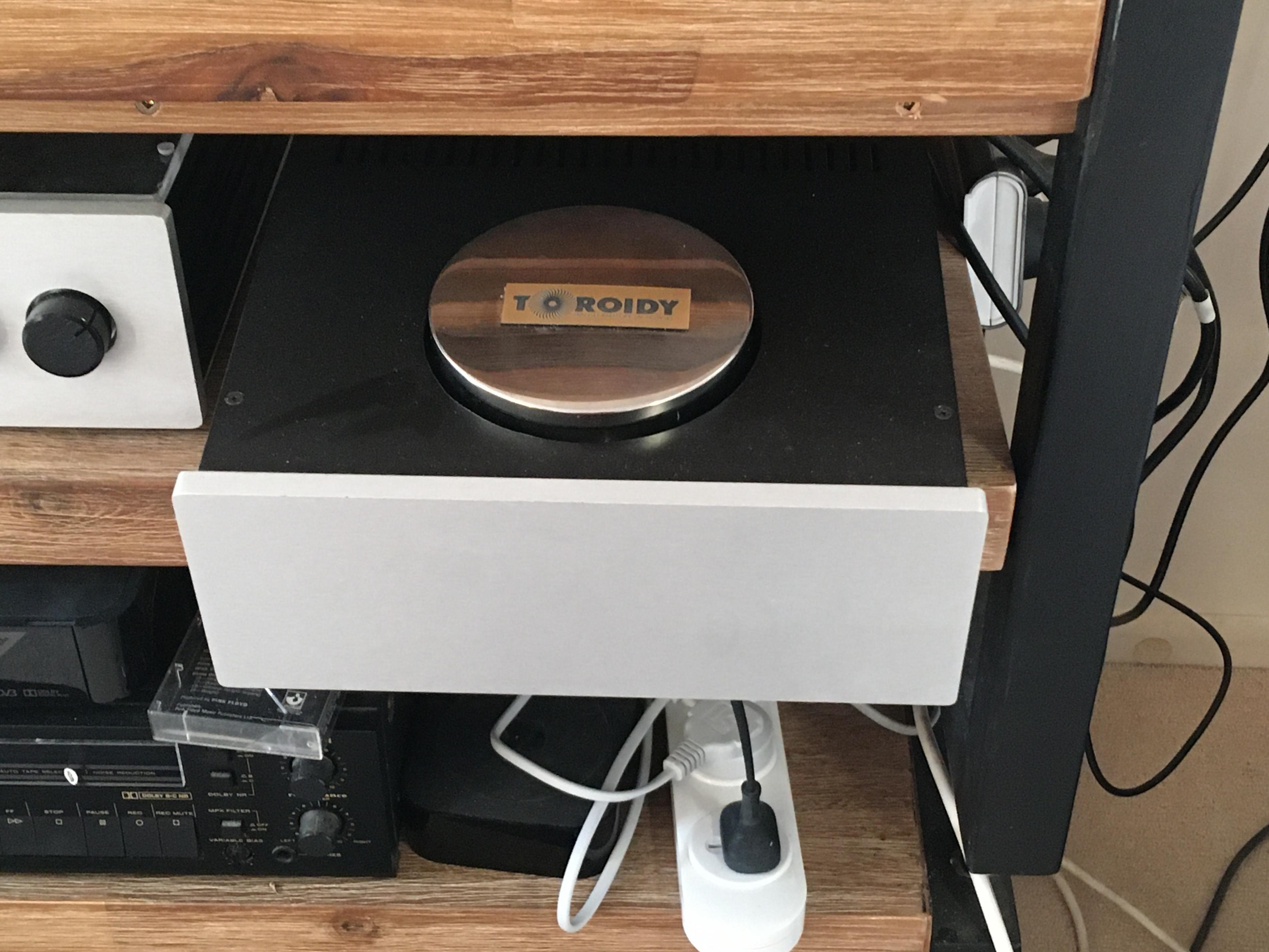

I've bought ready made filter/rectifier boards from e-bay and had one very expensive one spare. So I paired it up with Galaxy 2U case with Aluminium lids. You can use a router and circle jig to cut neat holes in the lid and poke a fully shielded Toroidy transformer through the top.
What!! Korg uses tiny amps though- The ultralinear power supply board I bought takes in 24 volt AC from the transformer and outputs 24vdc that's a little different to the norm where boards step up the volts a bit.
I'm running 230volt primary with two 24volt secondaries and just 20VA. I thought that was a bit over the top.
The transformer runs stone cold compared to the 300VA ones I use for each of my ACA.

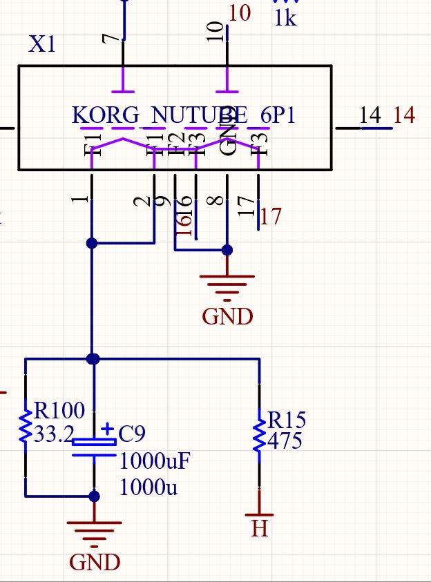

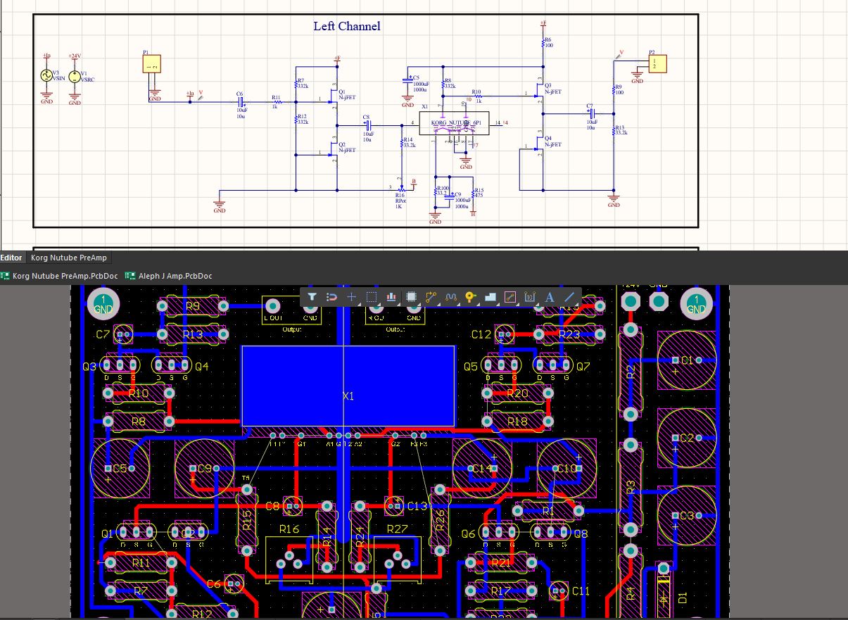

i'm designing my own PCB, but i've faced connecting of filaments (f1's, f2, f3's) to be unclear for me. Could someone please explain whether f1's are both connected to 475 ohms and 1000 uF as well as f3's? And what about f2? Is it connected directly to the ground?
Narside:
B1K design: F1 has a 1000ufd capacitor to ground and a series 475 ohm resistor connected to the filament power supply 'H'. F3 duplicates those components and connections. F2 is connected to power supply ground.
Although component values are different, I have included the Pete Millett buffer schematic which makes these connections more clear.

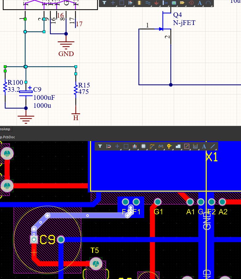

So it looks like that F1 nets should be connected the way shown on the picture (the net is highlighted. Please do not consider the 33.2R resistor due to it's for simulation only).
