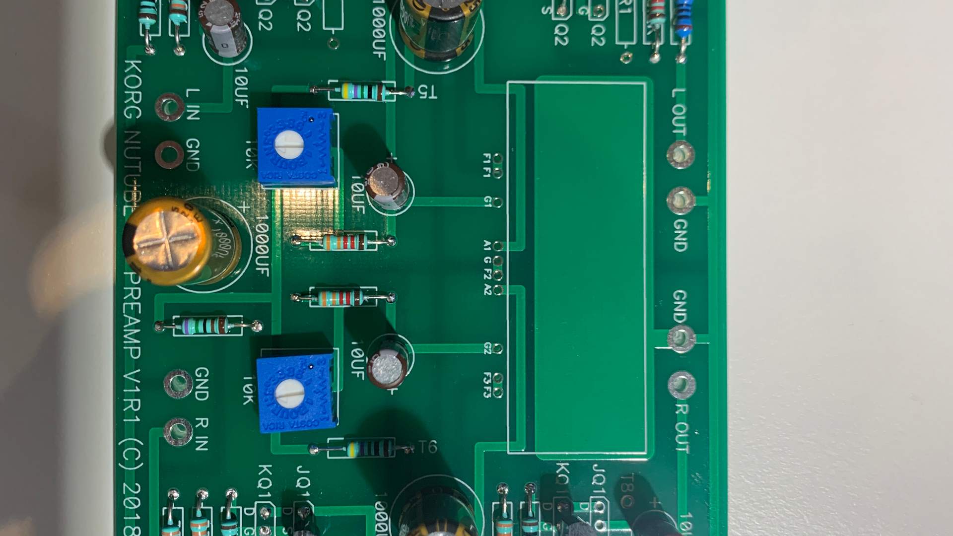

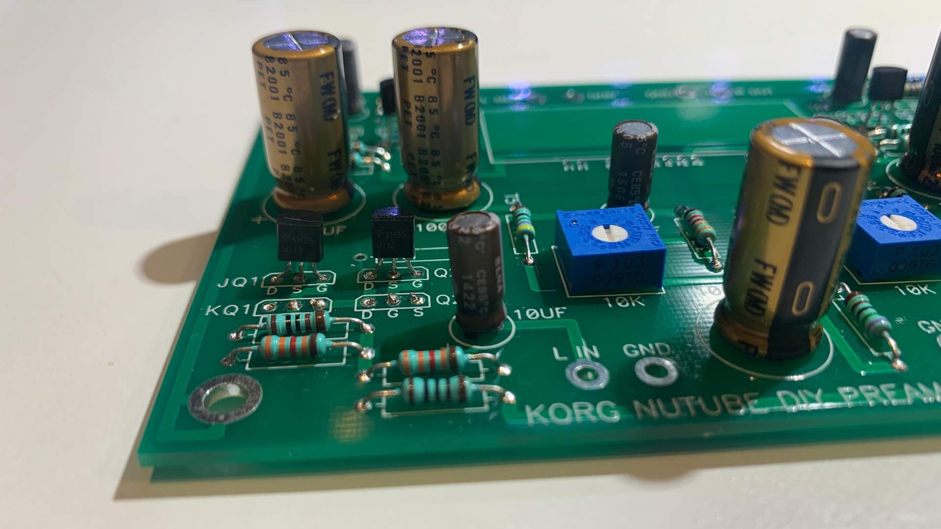

Hi everyone,
I'm building 2 pre-amp K1 and I've done a mistake when soldering the JFet... I put them in JQ and ... KQ... Then I realize how stupid it was - I desolder them and in the process one of the JFET leg broke.... Stupid me.
I reliazed I've genuine K170 from a previous project which I matched and solder to the K. So my pre amp(s) are are a mix of J and K as per picture.
Quick question is to check on the bias - any recommendaation for R1 on the K170 ?

I think I read it should be zero for the matched genuines.
“ Q1 and Q2 transistors are selected for specific Idss values, and the R1 values are matched to the Q2 Jfets. For J113 parts, the Idss of Q1 is set to be equal to current through Q2, and with the 2SK parts it is matched and the value of R1 is zero.”
