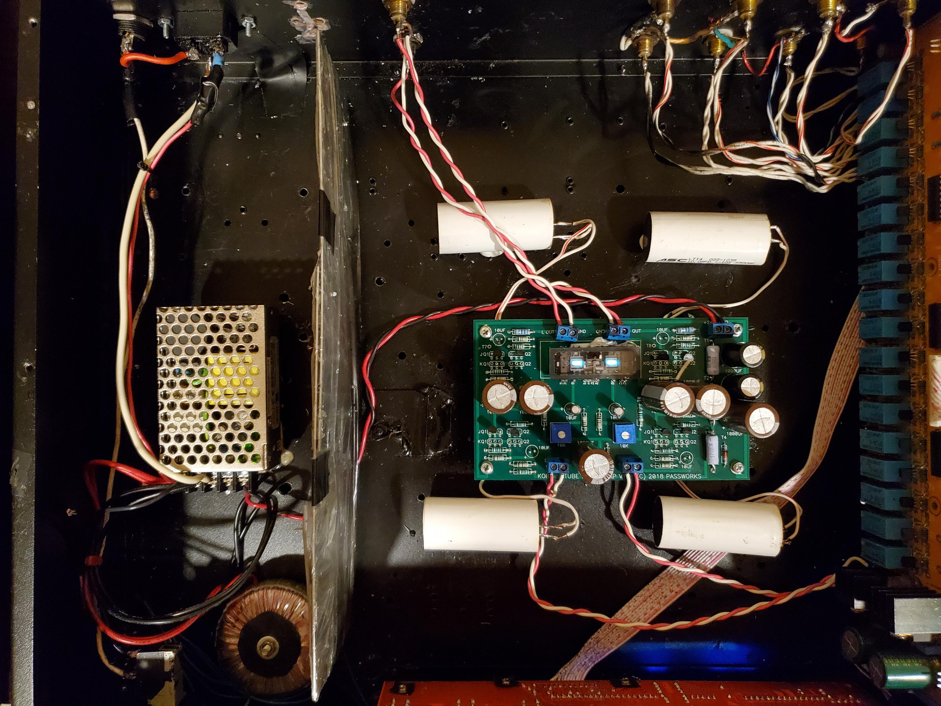

Once I tried to put a raspberry streamer and a nutube in one chassis. That didnt work well, heard psu switching noise (I guess) through speakers even with music playing..
No HUMMMM. It is gone forever.
First, I did everything you've (2picoDumb) suggested. And that took care of the grouding issue. No cap buzzing no bloody more.
But the trouble maker was nigh by but so far away. It WAS the BLOODY AC supply line to the relay board running next to my input wires. I should have known better!
Now, it's dead quiet.

Here it is. Changes I made
1. Isolation Trans OUT
2. Moved the AC lines to left side, away from the board.
3 twisted input and output wires (Neg and Pos together per channel)
4. Disconnected the AC green (green wire) from the chassis and directly connected to the PSU
5. PSU neg to the chassis.
6. Super tightened the metal standoffs to chassis
7. AC supply lines to the relay were moved a far away from the input area
8. Polyprop caps are sitting on putty
